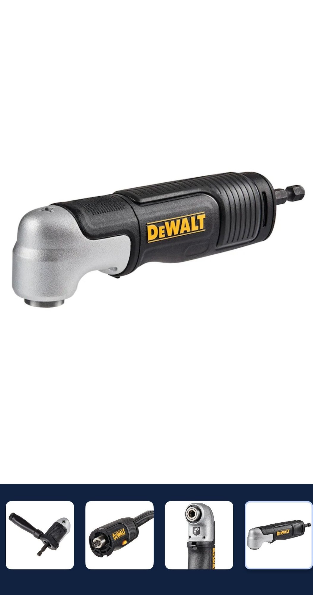

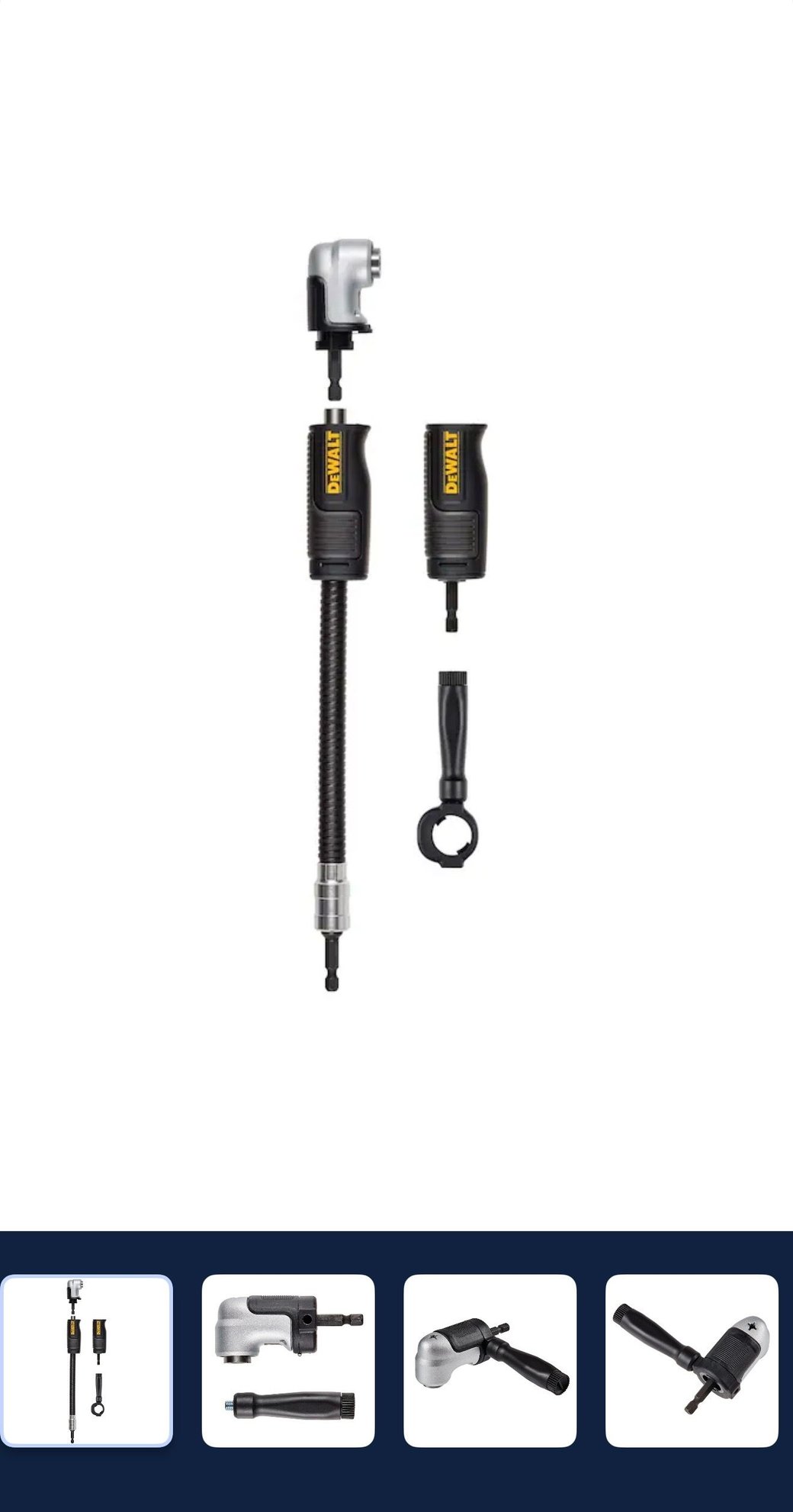

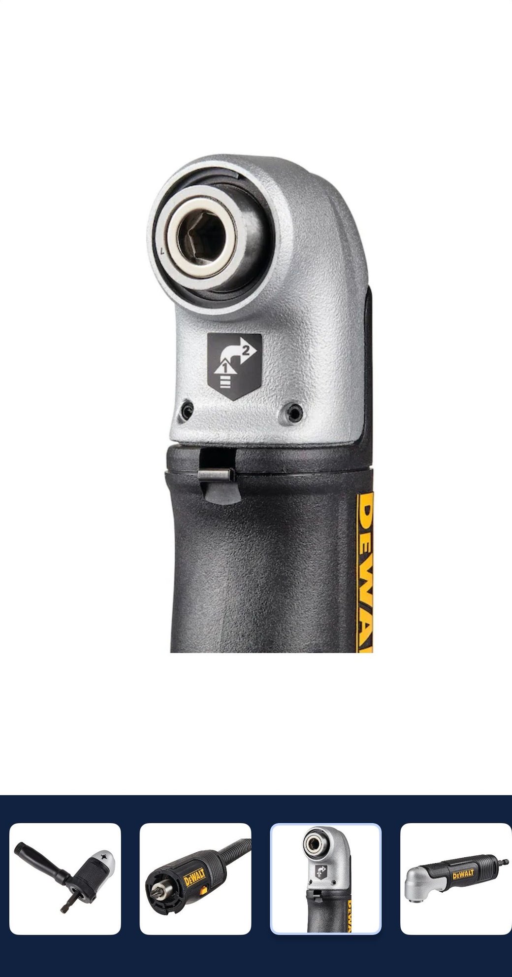

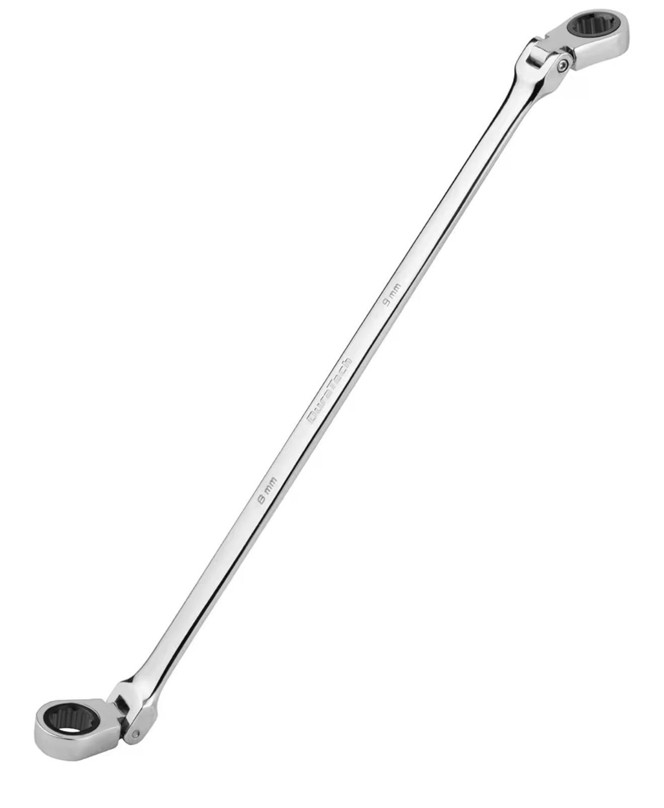

So for those that has removed the bumper and fenders, and had to make or modify a tool to get to a few of the bolts(like the one right next to the headlights for the bumper), do you think any of these would work? I have no way to make a 8mm whatever to get them off unless I ask one of the welders at work.

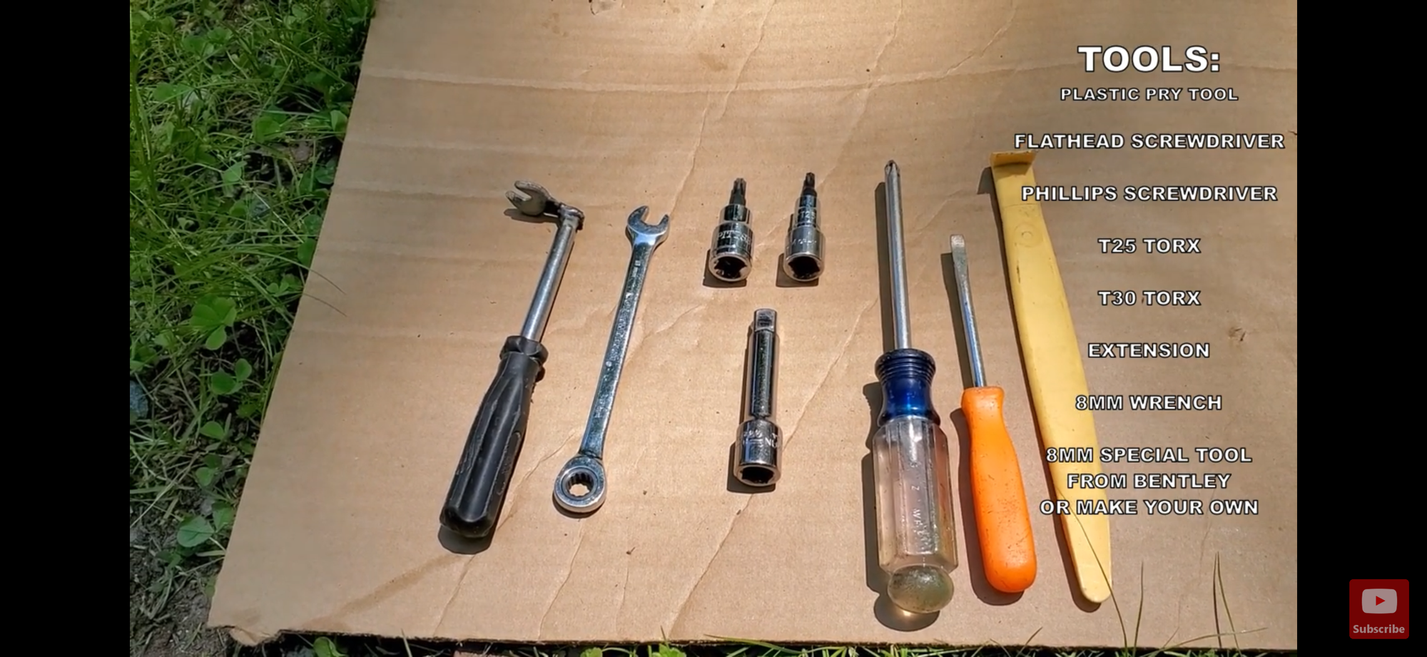

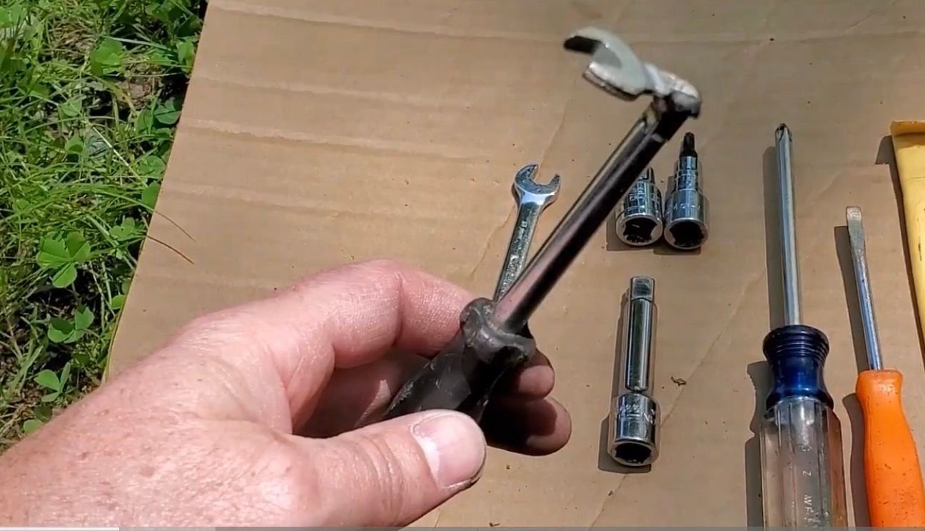

I watched a YouTube video and this is what that guy made to finish his job:

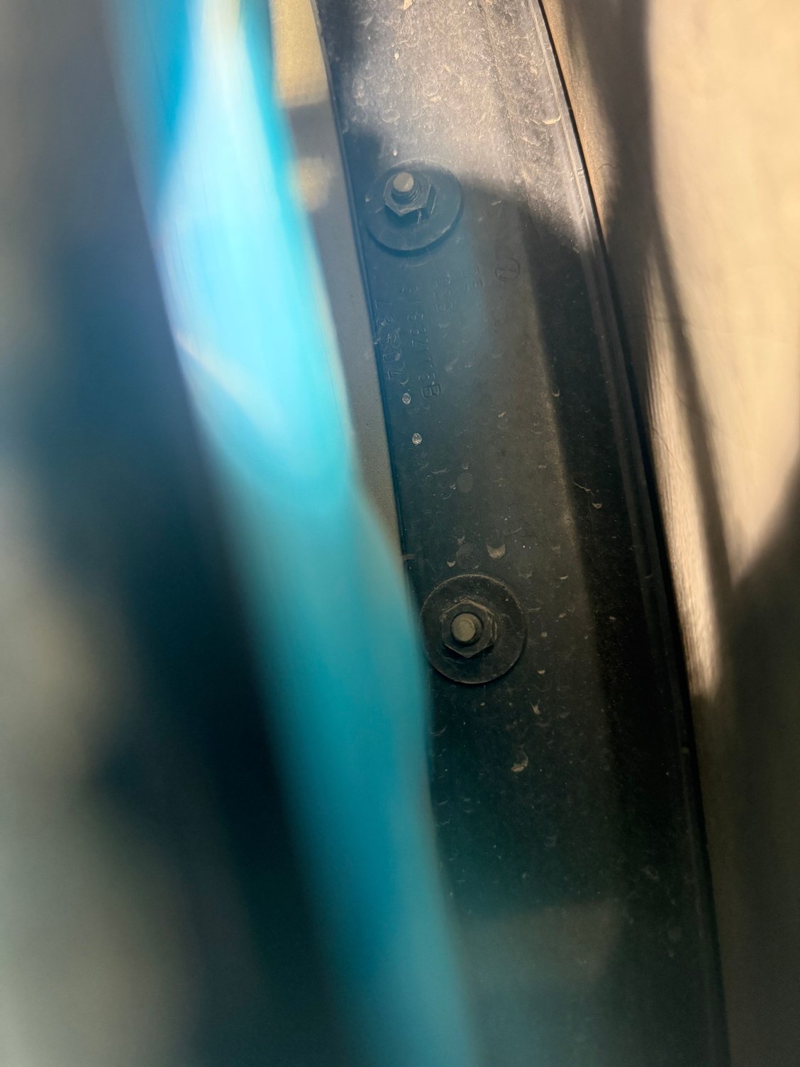

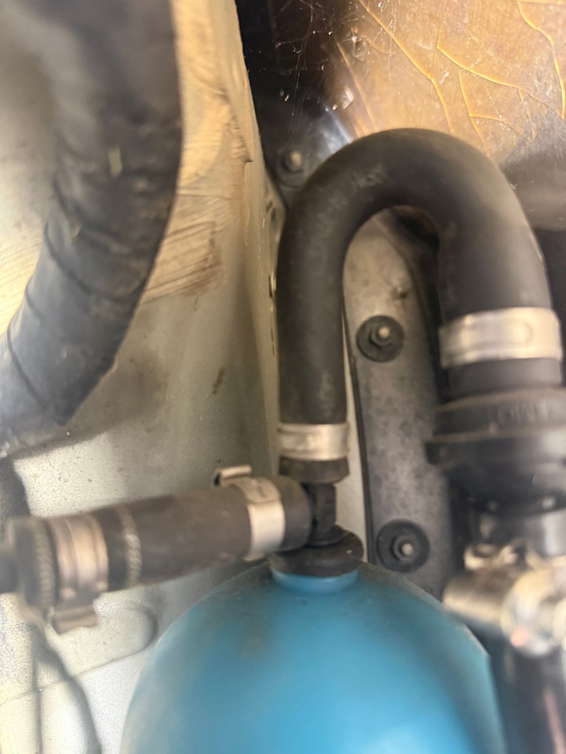

So I decided to tackle getting to my ABS pump after reading this a watched a YouTube video or two. I get to the part where it says open the door to get to the torx and I see nothing. Confused I started taking off the bumper. Once that’s off I look towards the door and this is what I see.
The more I work on this thing the more I realize some stuff is not like the rest of you all. Mines must have been built on a Friday or Monday!! Let me see if I have any extension that’s able to reach in there 🤦🏽‍♂️
