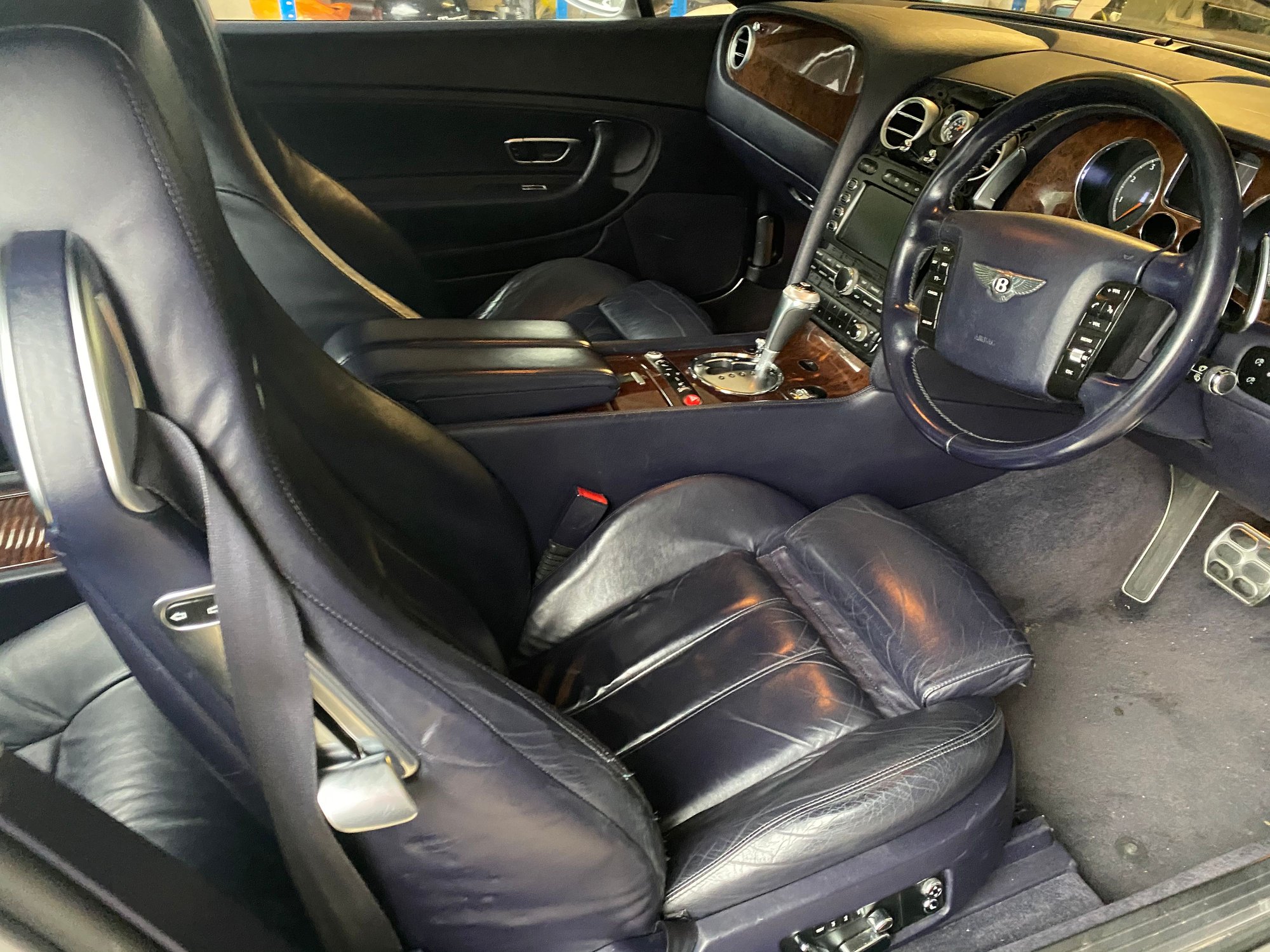

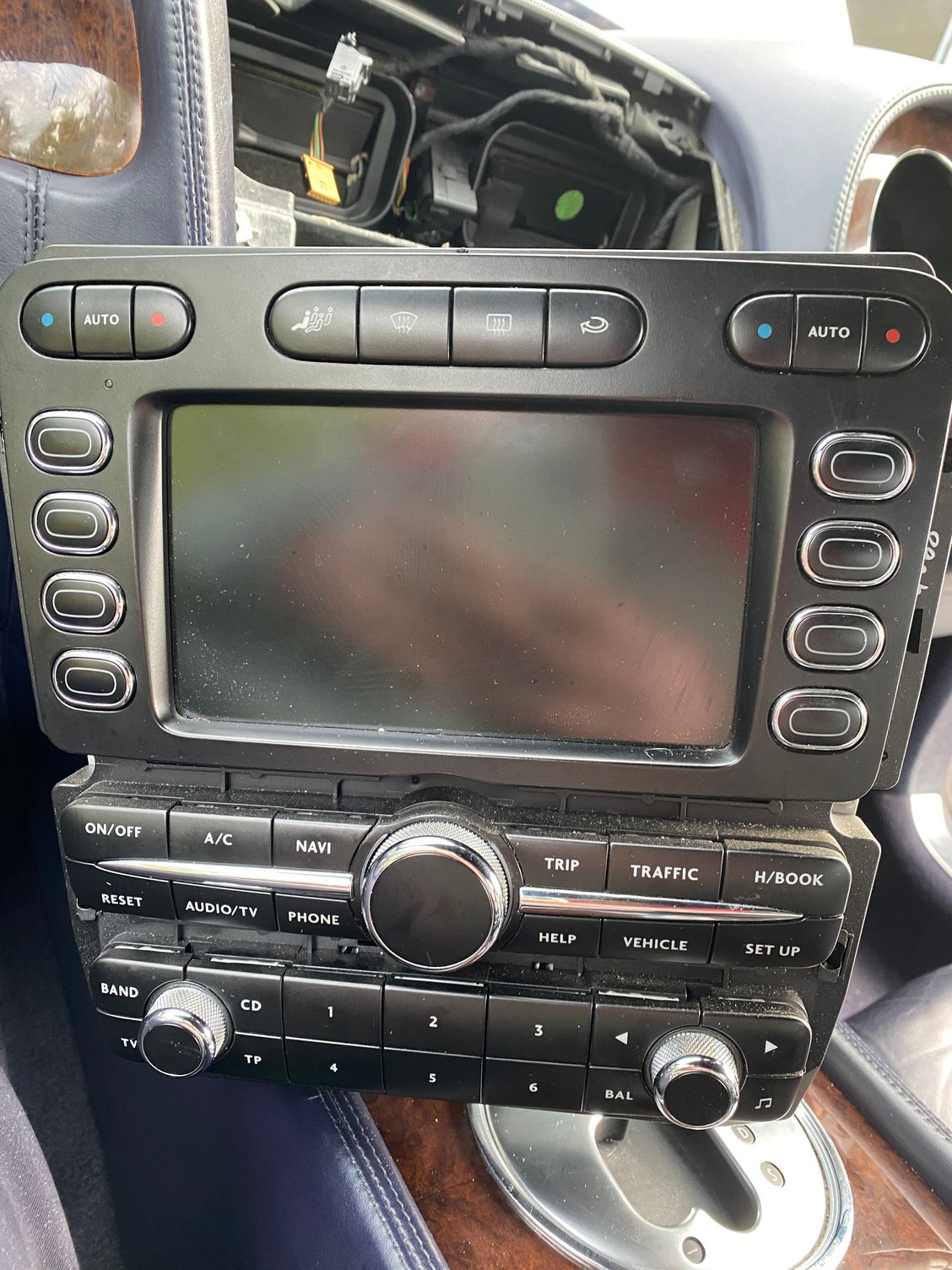

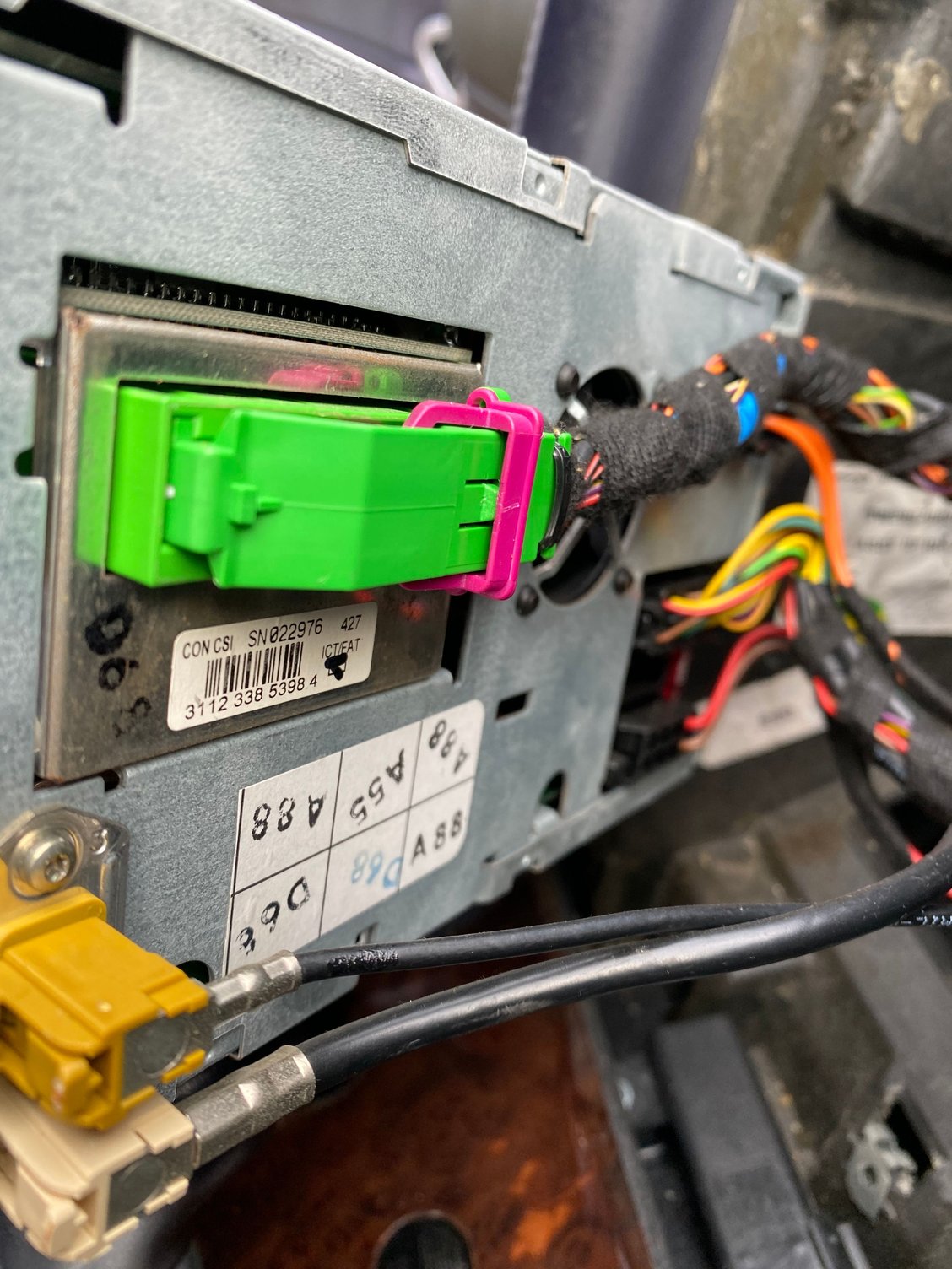

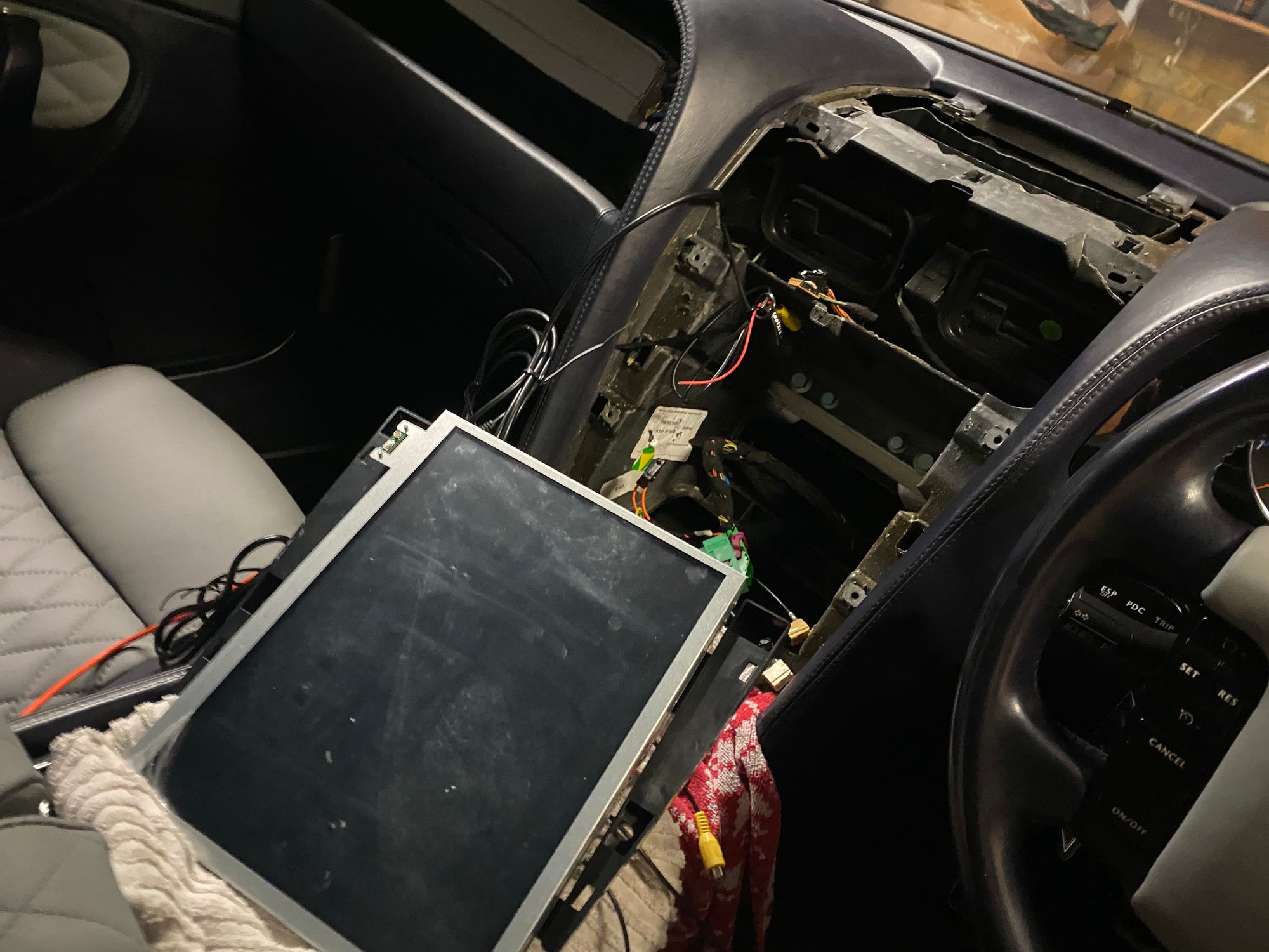

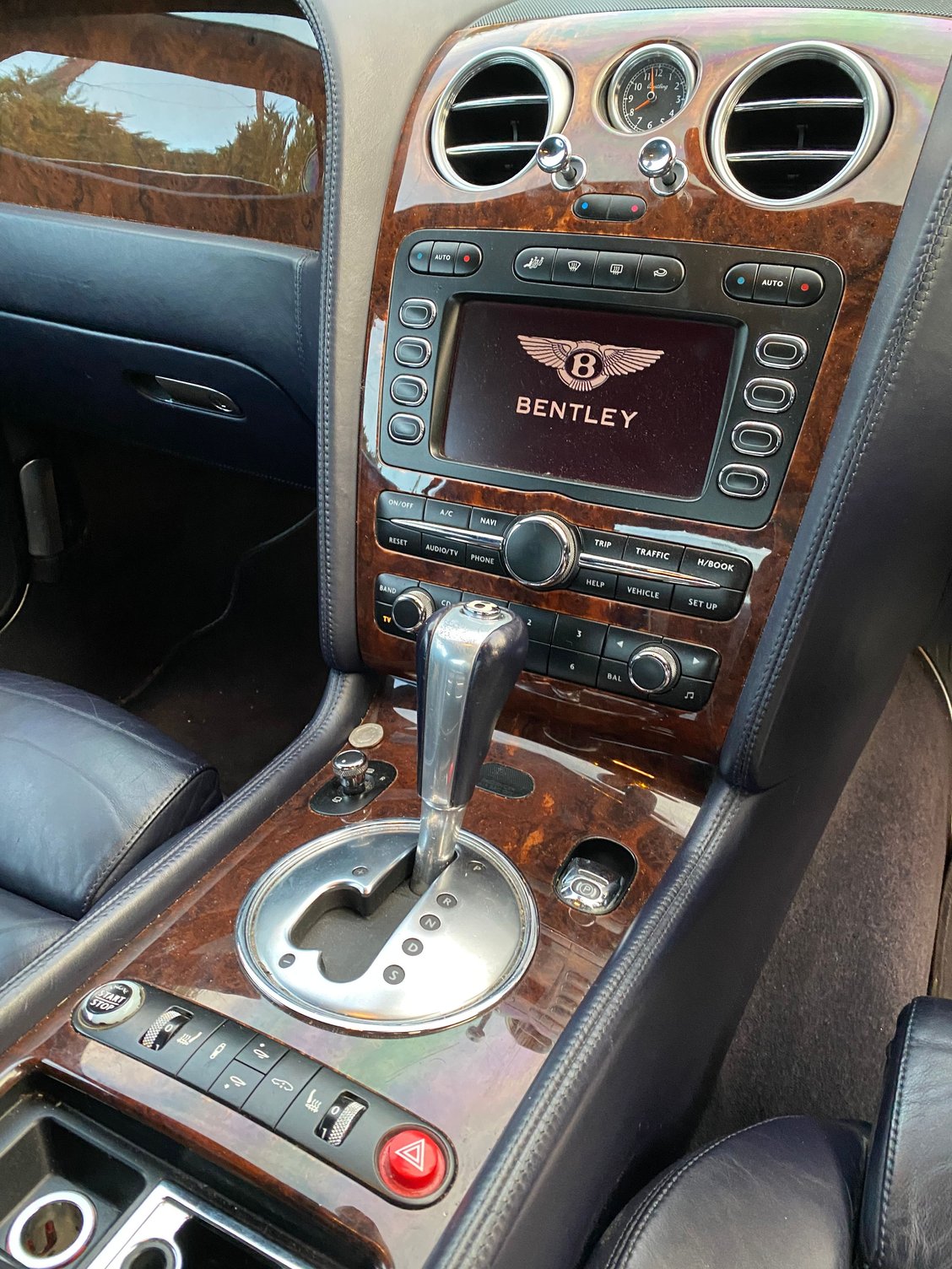

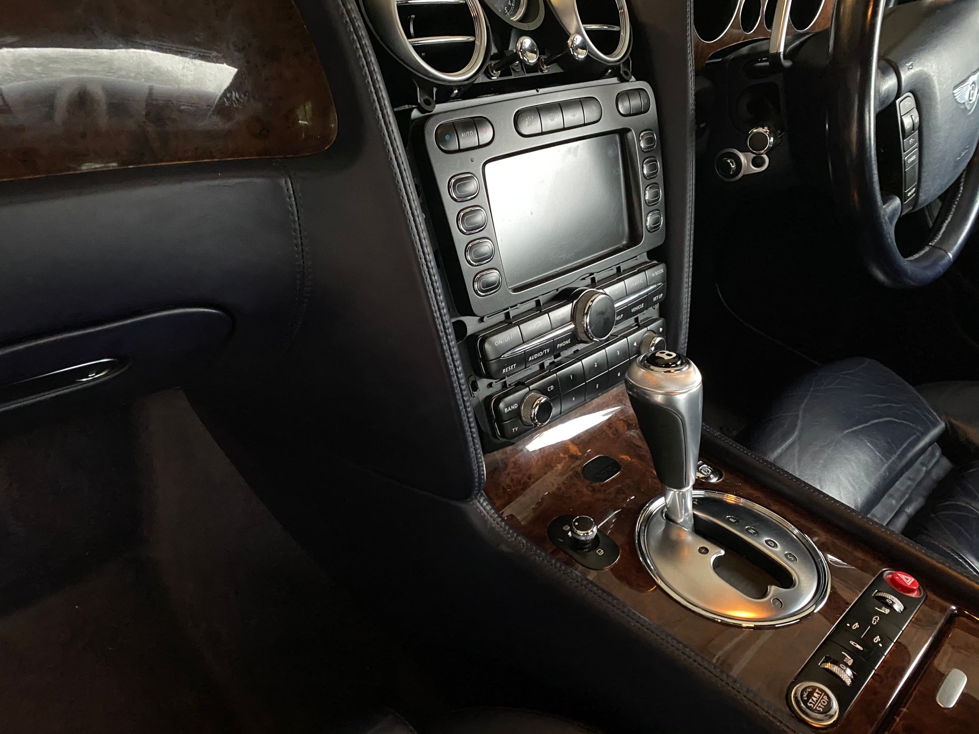

Here are some prep work shots of the dash before head unit removal, removals of the head unit & fascia (very easy - clips to fascia and 4 x screws holding the head unit in place - new unit is a straight swap with new black fascia). Then, for those interested, some of the update shots from TOWIC for the leather re-trim (I asked then to run some cables for me while the car was stripped), the wood being prepared to go Black, the privacy glass, etc .. last pic is the original car when I bought it (since then changed wheels, done initial paint correction and other cosmetic work)
I'll post more of the head unit project when the unit arrives ...
In the meantime, when I get the car back on Monday from TOWIC (with hopefully a beautiful new interior!), I am taking on the challenge to update the headlights (LED's, Halo's, etc) so Grille & bumper off, wings loosened, wheel linings loosened, under tray released ... headlights out, polished lenses, lenses removed, halo's mounted, LED bulbs mounted ... system check for errors (fingers crossed) ... then reassemble ... yep - I'm an idiot and probably going to mess it up - but going for it next week .... hopefully complete in time for Head unit arrival ...

For the power to the cam's near the rear view mirror - planning to route the cables straight into the head-lining near the overhead lighting unit (hoping to stow the excess cable there that join the outward/inward facing cam's) so 3 short wires direct from headlining to top of windscreen (see attached photos). Then route the cables across headlining and down A-pillar into glove-box access and across to head unit to connect to 'Cam USB' feed on the new head unit (selectable feed, different to automatic feed from reverse cam). This the plan, but will have to see when I get the car back.
re. going all out .. errr, yeah .. sort of - been doing the usual YouTube crawling to find videos ... found one video from the US of a guy taking off the bumper (ordered a flexihead spanner to get to the 'impossible' retaining screws near the headlights) and another one about the removal of the lights. The fitting of the halo's I have done before on an old porsche I had last year - so confident with that (reasonably) providing the units I have ordered naturally sit ok on the lamps. Providing I can get the panels off (big assumption!), the rest should be alright in terms of the new bulbs, etc .. as I will test them thoroughly before re-assembling to make they work and don't have any dreaded error codes.
As for the rest of the project beyond the Head unit & Headlights work - TOWIC are doing the main works on the leather, wood, privacy, etc ... I am just doing cosmetic stuff. Mechanically the car seems solid, but as we know that can quickly change (hopefully she won't ££ hurt me too much .. vacuum lines!!). It was error code free when I bought it (testament to last owner and Silver Lady garage), but I am investing heavily ££ in it at the start with all of this work to get the car how I want it / have dreamed about (hahaha!), so we will see. I realise I am unlikely to get back this ££ investment if/when I sell, but for me, for this car, its not about that. I am loving every minute of it, to be honest.
I'll try and load as many pics and progress reports I can, if people are interested. As I said, I have learned a lot from these threads and I think its good to share to keep these beautiful machines alive & kicking!

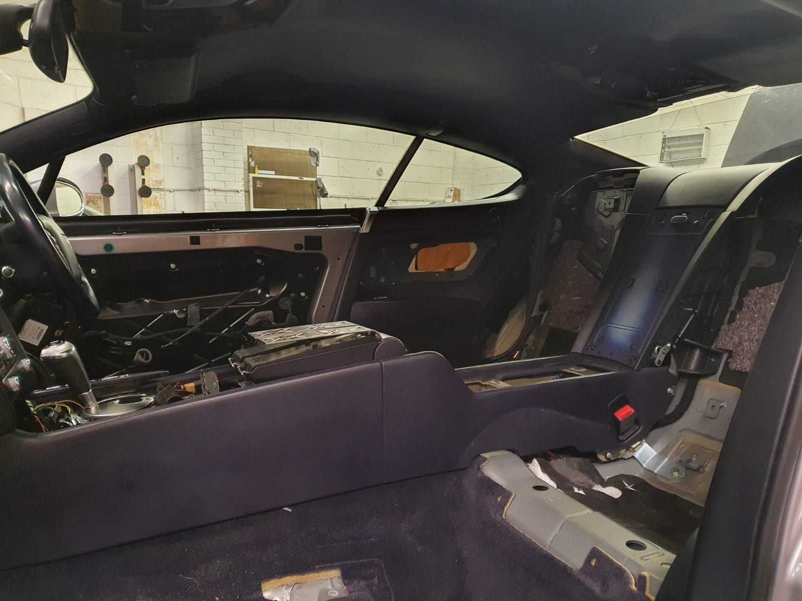

For anyone interested, these photo updates from TOWIC scared life out of me ... hopefully it all goes back together ok ..

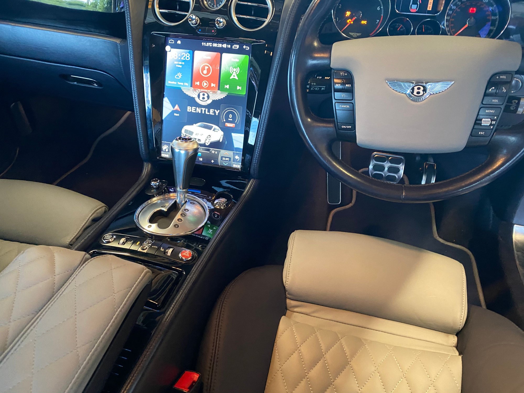

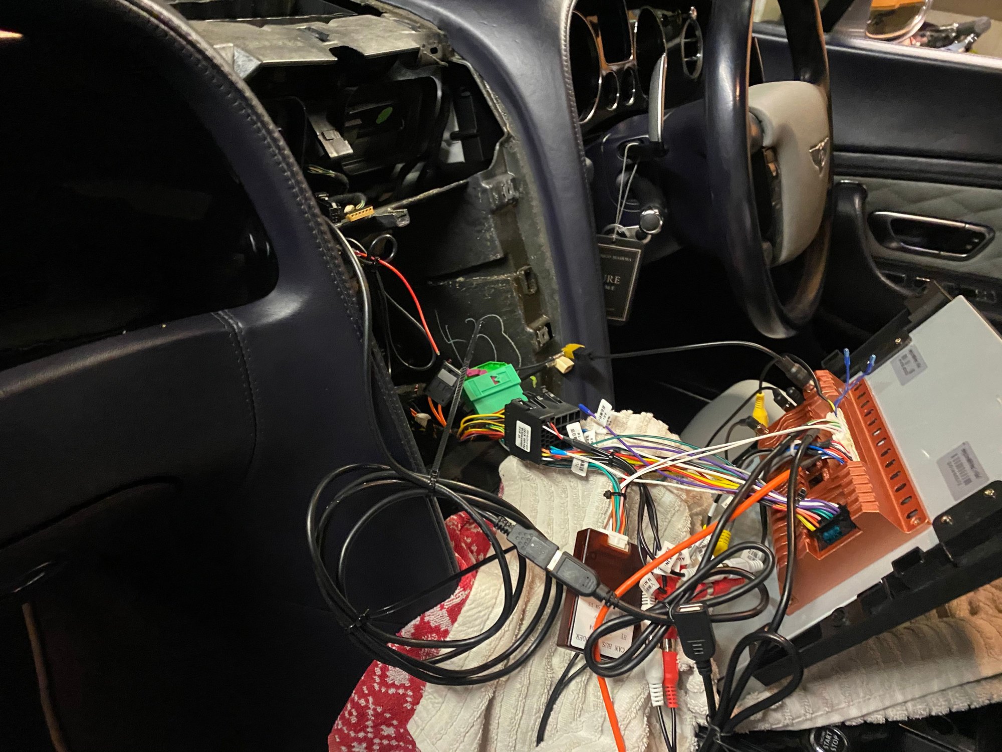

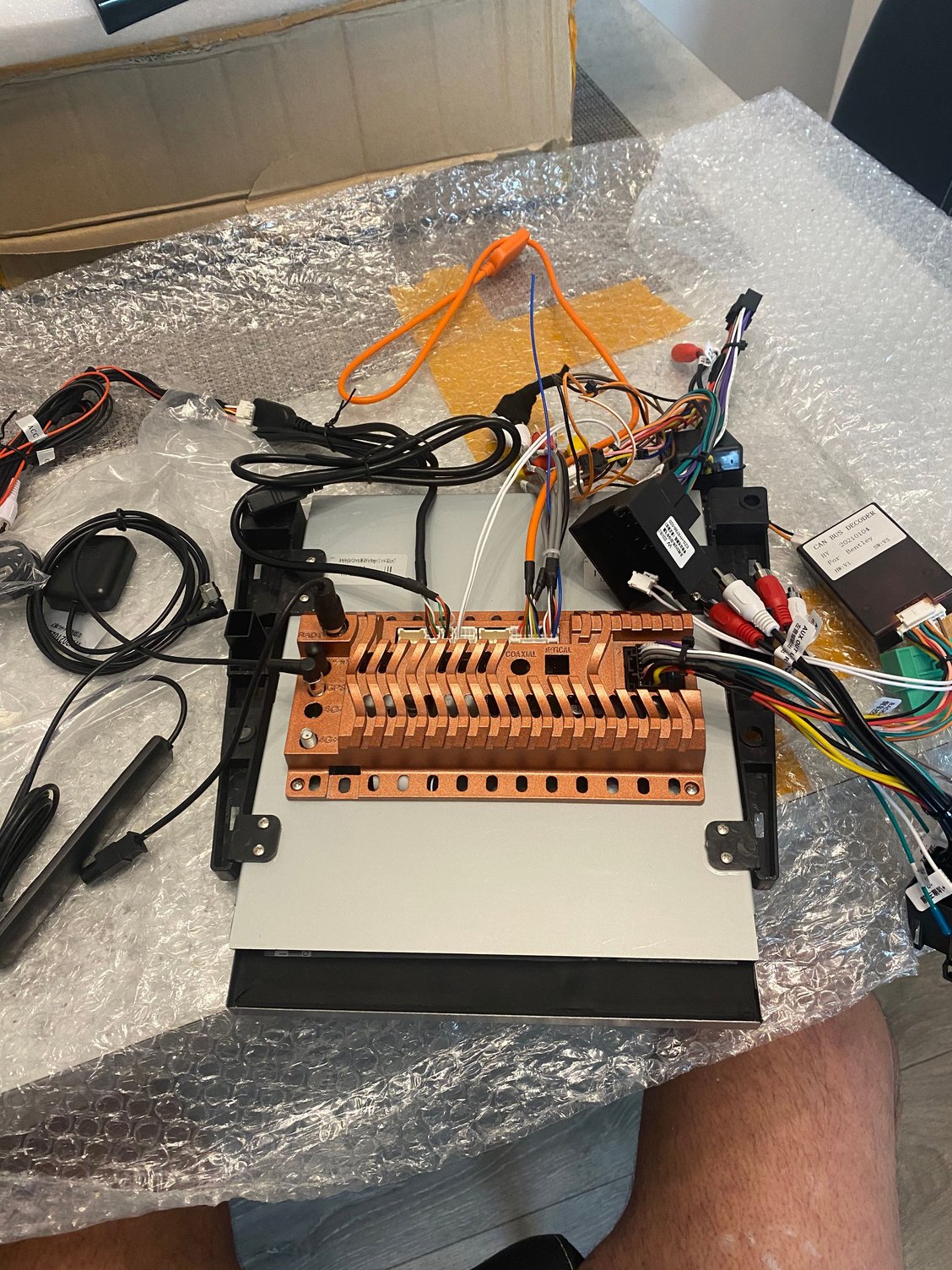

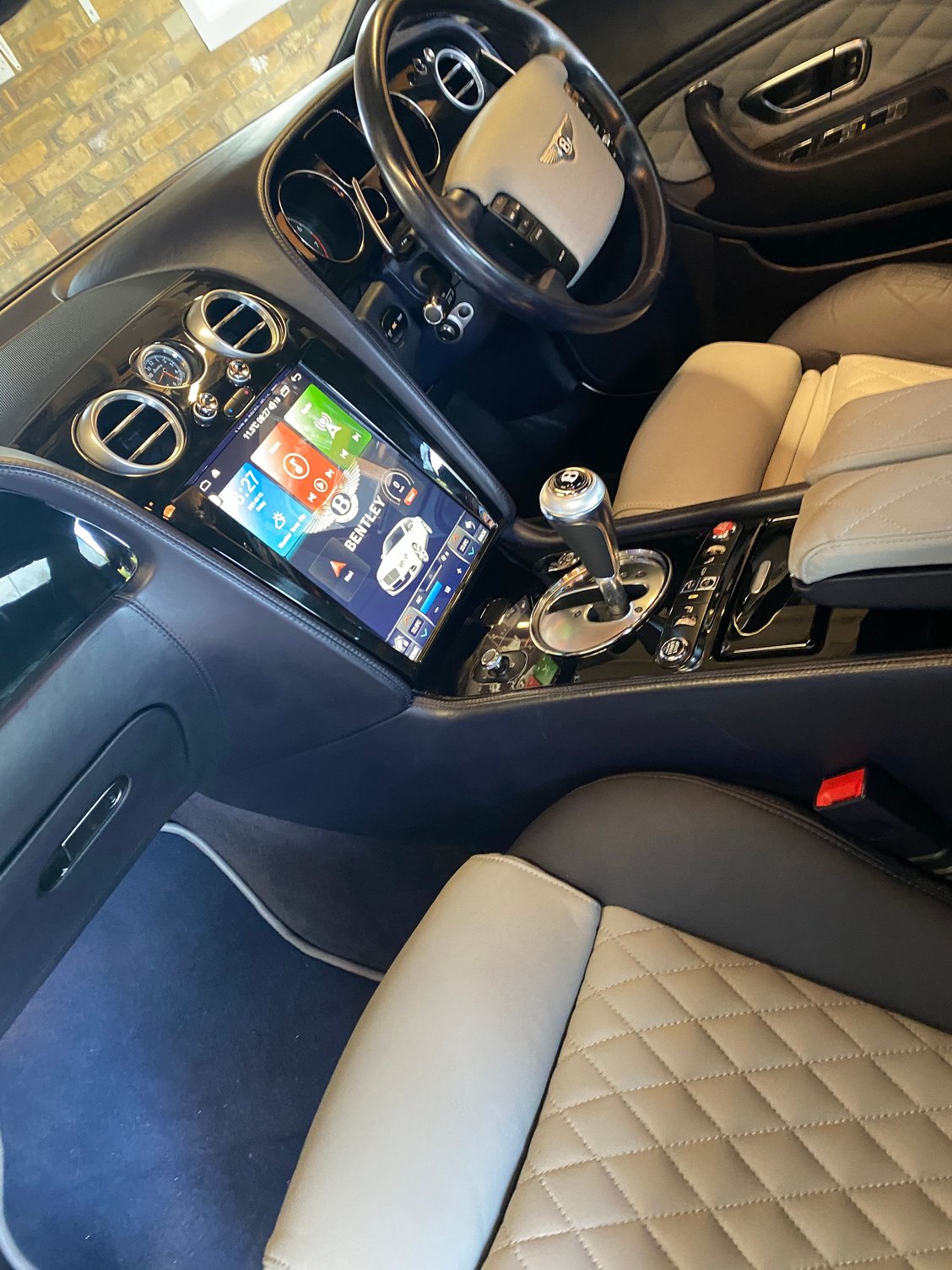

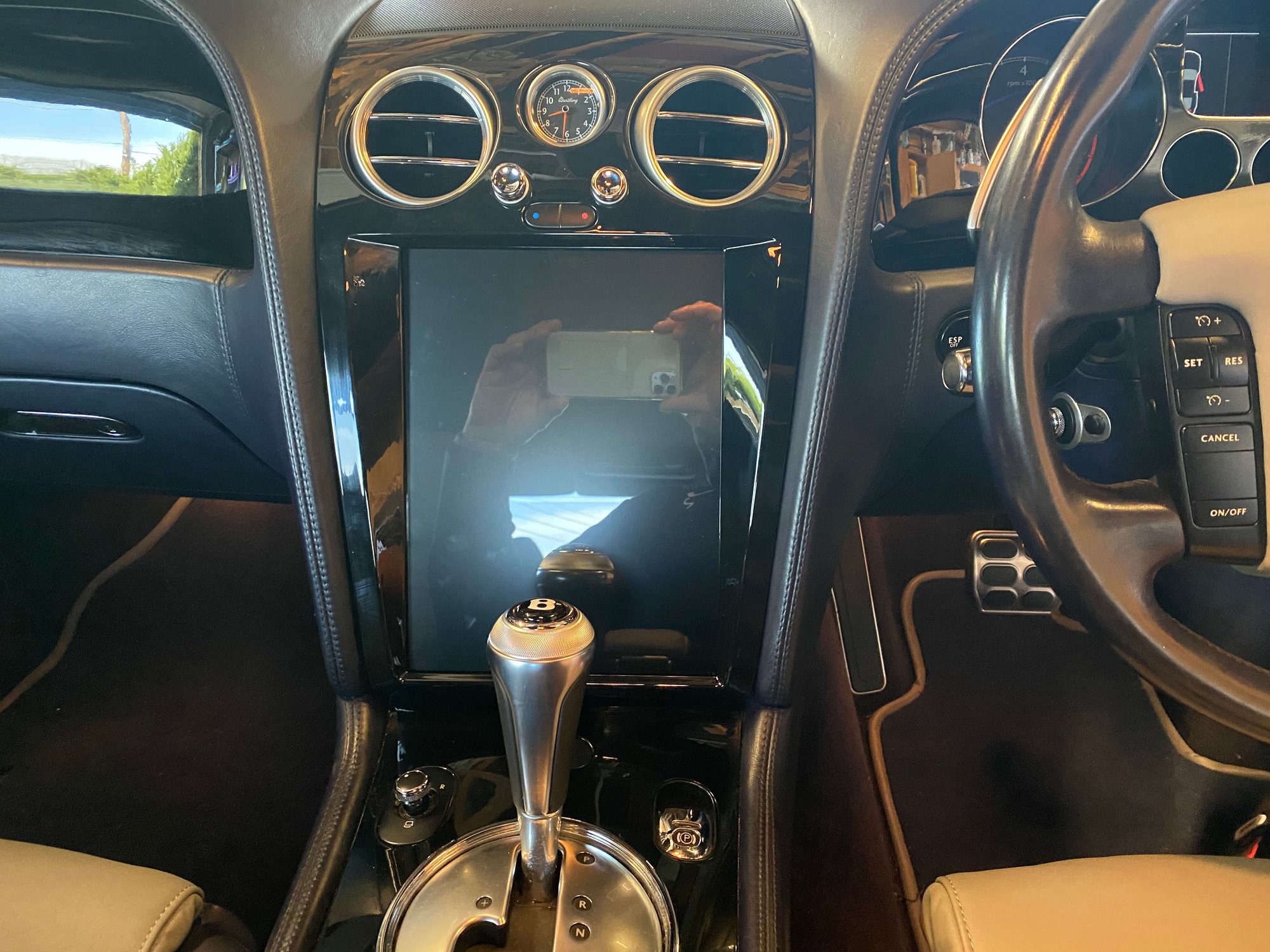

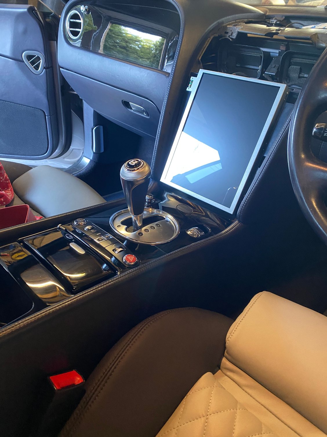

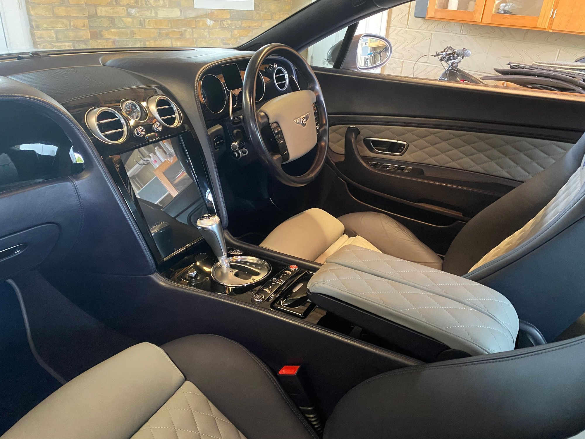

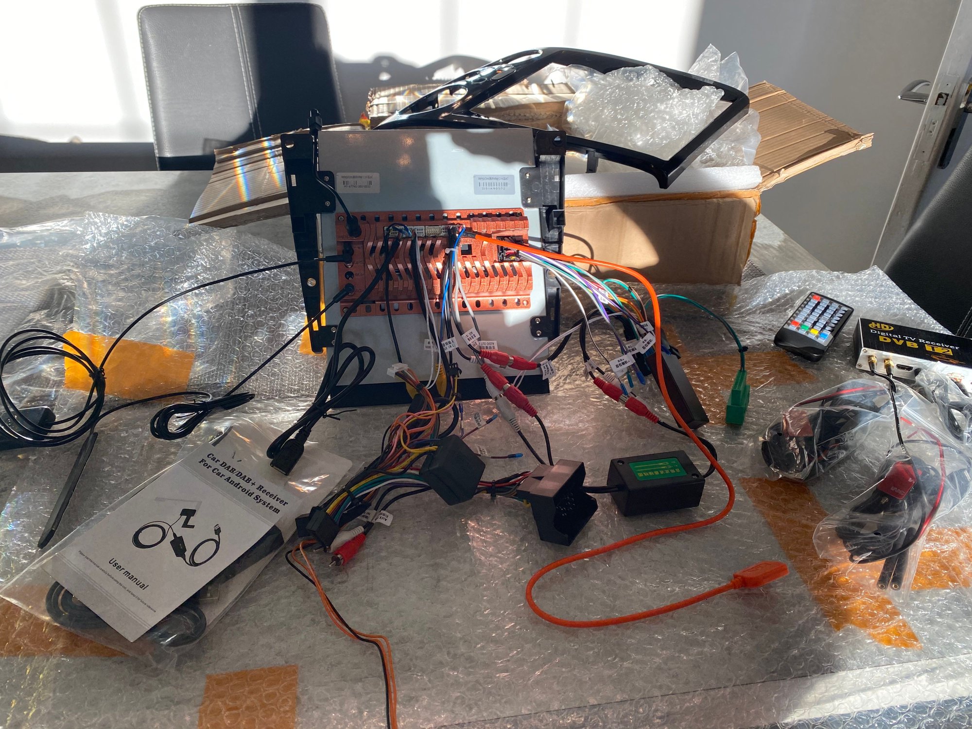

Hi all - as promised - an update on the car, now nearly done ... TOWIC finished their work (leather, privacy, wood, etc) and I have now nearly completed the head unit upgrade (big delay due to Chinese new year delivery), but received it yesterday and just finished. see photos below. I still have the reverse camera to finish (finding the the right wire for the reverse light, but its mounted and connected to the head unit) and a few other bits of configuration to complete.
First impression of the tablet head unit ... I am really pleased with it.
Connected to inbuilt CarPlay no issues ... using wifi hotspot and bluetooth from iPhone.
I have BBC News channel playing split screen with satnav as the standard screen
All steering wheel controls and car functions working via the Bentley can bus unit that comes with the unit.
I have done a couple of videos showing the unit when I was connecting it all and the finished result. I didn't go into the detail on functionality because Neil covered that in his video.
Overall, I think it really improves the interior of the car - and brings it bang up to date in terms of tech - interested what others think.
Luke
unboxed
organised ... sort of!
screen into car
spaghetti junction!
Screen in position, receivers fitted and usb/4g sim holder in position in useless drinks holder under arm rest.
surround fitted with air vents/clock connected
system powered up and tested with steering wheel controls and car functions
view of unit integrated into car with ignition off
Finished result
