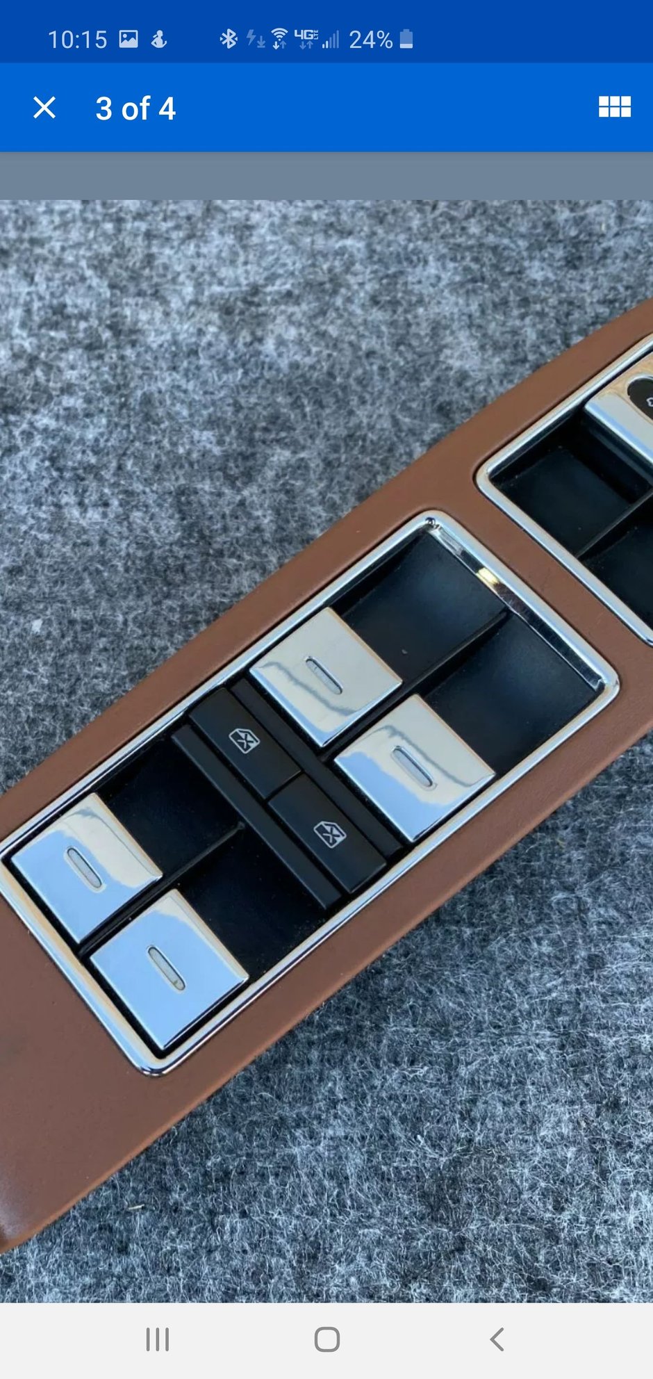

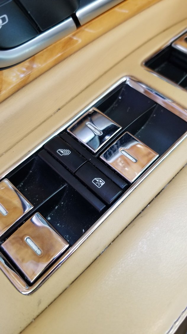

Hello Randy,
Please post a picture of your switch panel on your driver's door.
It appears to be an option, so if you have it you would have the multi window black button to the left as shown in that attached picture of the black unit from a 2007, a 2010 shows the same switch setup for global close and open, now before anyone gets confused, 2004-05 N/A vehicles got the black round "Global Close" button on the center console, whereas the ROW got push button start instead.

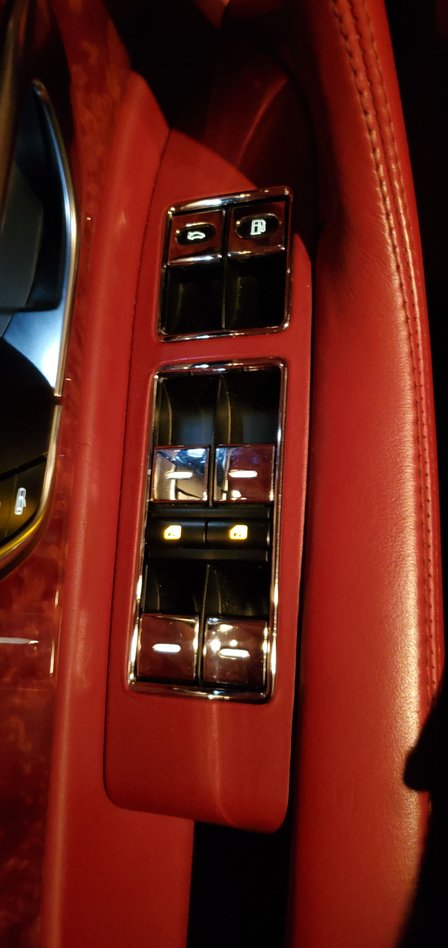

My rebuild vehicle with the 2007 -2010 interior parts has PB start, but only 2 rear window lock buttons, (shown in red) so no global open or close.
Johnny

Johnny to the rescue once again!
I've read through the manual but must have overlooked that. I didn't realize those were function buttons.
Ok so the one on the left toggles on/off all windows up/down. What does the right button do?

Locks the rear window switches, child safety.
