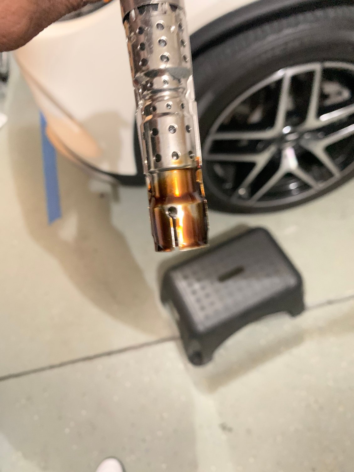

No I only took out two plugs on only one side (Passenger). The one plug that looks like its GOOD come out of the spark canal that had oil build up maybe 2 Centimeters up the Porcelain part of the plug. The BAD looking plug with all the carbon on it didn't have any oil build up in the Canal. And no I have no coolant or running hot or lean issue.
This is only coming from a slight miss on the (Passenger) side of the car so I decided to pull the plugs to do a lookie lookie. All in the same decided to changed them since they were out. (Waiting for plugs to come in the mail.

So I decided to start to take out the other side of the engine plugs tonight and this is what I found. I’ve change many plugs in my day, this can’t be normal

It's plain and simple, you HAVE leaking valve cover seals as I showed in pictures in one of my previous post to you, besides the valve cover gasket that runs around the outer area of said valve cover, there are 6 seals on each valve cover to seal the oil from getting into the spark plug area, you must remove the valve covers to replace them.

Sadly the slight miss is still there after I got everything together. Guess I gotta just carry on with it I don’t know what else to do.

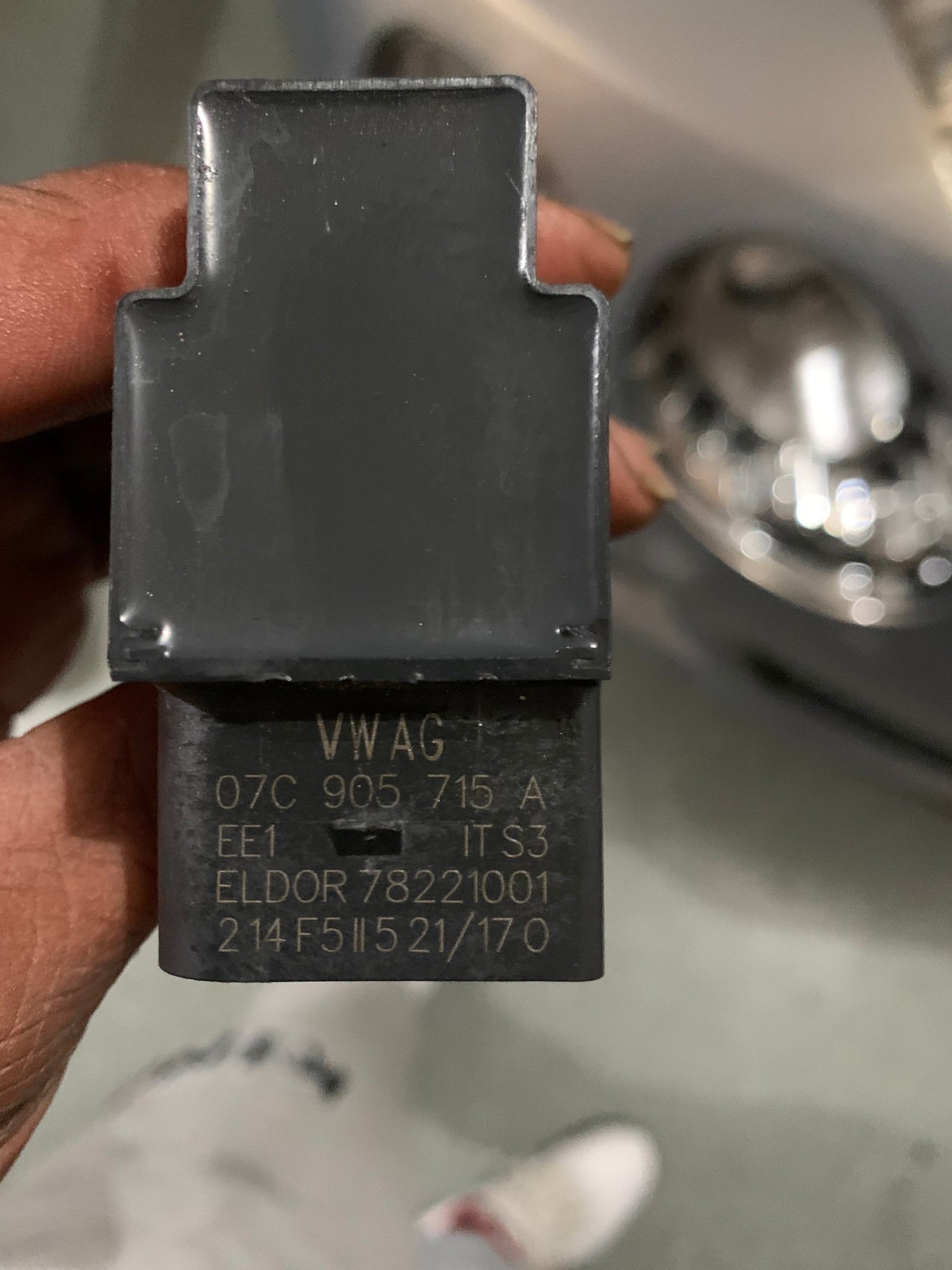

did you replace the coils? Something caused the plug to foul out, since the other plugs looked good.

No I didn’t change that one thing, I’ll order one and try that. The coil that, that plug was on is the new one out of the 12 which I didn’t understand
The other coils are original to the car

How long have you had the vehicle ?
It seems someone before you had the same issue and changed out just the one coil and possibly that same plug, how long have you had the slight misfire ?
Did you do both VC gaskets and the 12 spark plug seals ?
I do not get why people ( not you, the guy that replaced 1 coil) do such work, while the intake is off you would do all the plugs and all the coils, and for you at 70K miles I would be replacing all coils.
