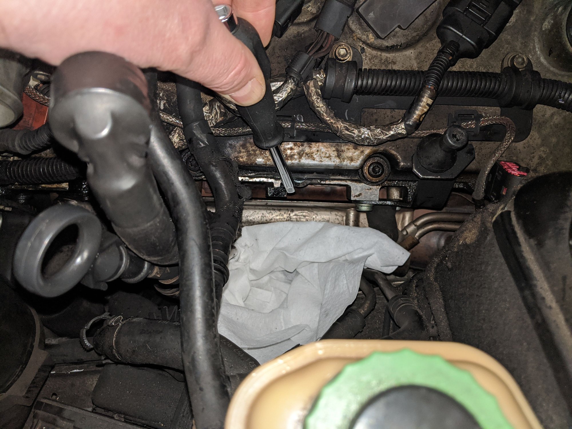

Found the problem!!!!!.
ok so thanks to some.input from a fellow Bentley owner on another forum the issue has been found.turns out Bentley has two small core plugs at the side of the block close to the front of the engine just above below the head.casting holes I believe and the core plugs have gone.this has obviously been a issue a long time ago looking at the soot and gunk build up I will post some pics of the fix
when parts arrive but in the meantime here's a pic of the hole and location

Hello Yoghurtshotgun,
Great find, would you please share the link to the information.
Also, I am not sure if in post number 4 is a typo, or did the vehicle have a bad cat or two ?
The hole you pictured is actually in the head, not the block, there are 2 in each head, you will want to find the cause of the plug being dislodged, possibly clogged cat, egr valve stuck, exhaust, etc., are both plugs on the pictured side missing ?
Hi Johnny thanks.for your input .the car I bought as a cat s a year or so ago and have been tinkering with it on and I did for a while .I have no history all I know is the last owner was an ******* and didn't look after it one bit .the car has smelled ever since I bought it and has been driving me nuts but someone on another forum.i admin mentioned it could be the plugs so I dig in and took a look.now the question is what could be causing it.the car doesn't seem.to.soit any codes and pulls like a train so surely if it was blocked cat it would run badly .maybe I'll put some grub screws in the hole and run it up and see if any fault codes appear .there looks to be a lot of soot build up around that area I'm just wondering if something's not operating on the turbo.sadly I don't have access to a ramp but if it keeps playing up I'll.take it to a garage friend and get them to look a bit deeper

Ok success !!! After speaking to another guy on a different forum he was correct .there are two small core plugs on the base of the head towards the front of the head they had both come out somehow .I replaced them and all seems good.
