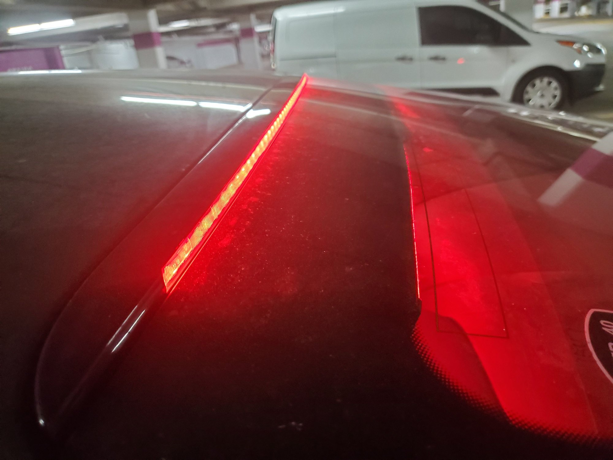

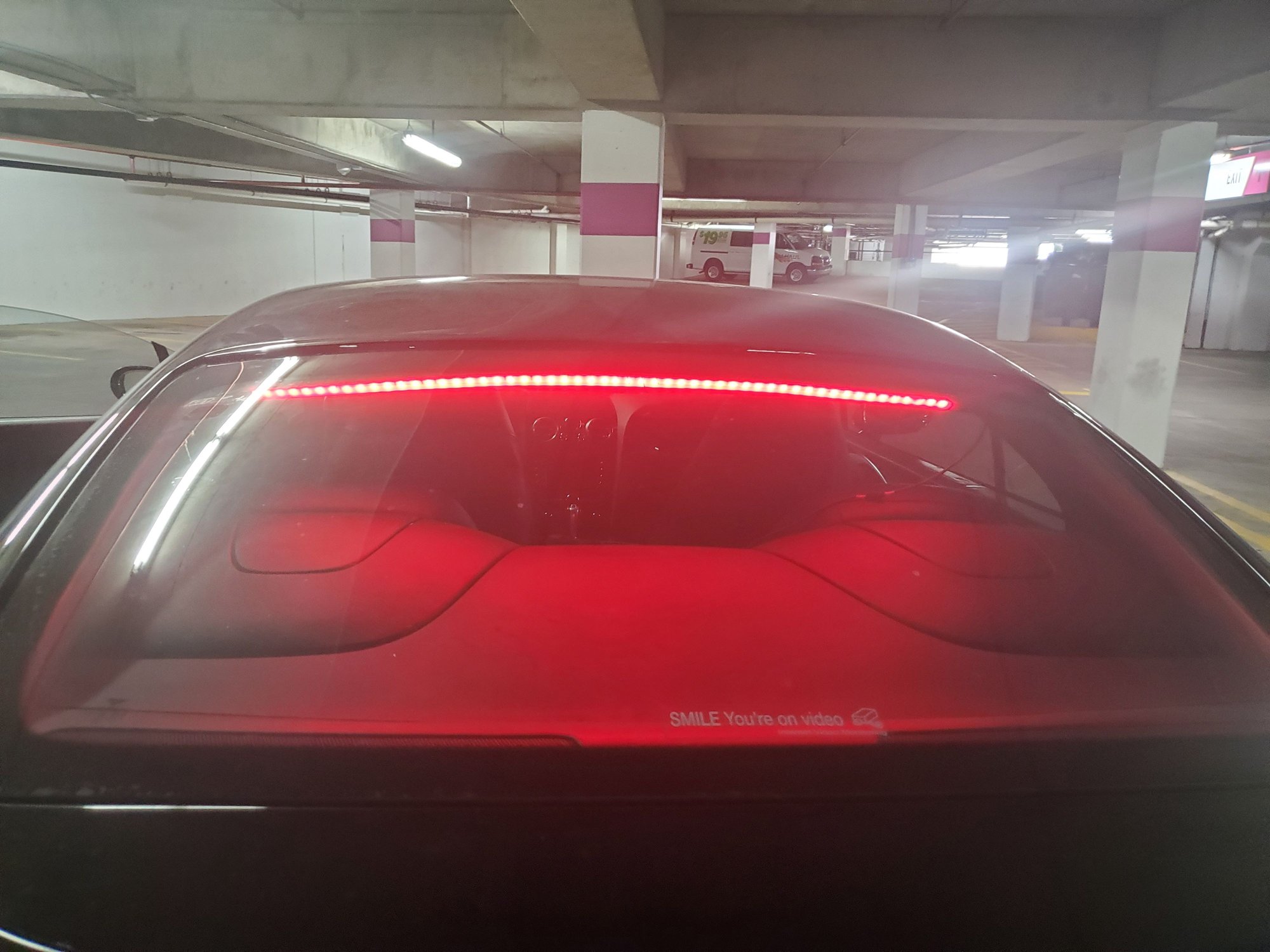

cgt 2005...My 3rd brake light works intermittently. The replacement part I think is $500 but the old one needs cutting out with the risk ot breaks the rear windshield so this could be a $3k job.
I bought an LED flexible strip for $20 and some 3M double sided tape . There is a place on the inside where the roof meets the windshield, its a 3/4 inch vertical surface that you can stick the led strip to. From the outside you don't see the strip when not illuminated as the top of the windshield has a blacked out area that essentially hides the led from a person viewing the car. I need to see if the tape holds and I need to take a pic in daylight with the brake light off , but I thought id ask for comments ..

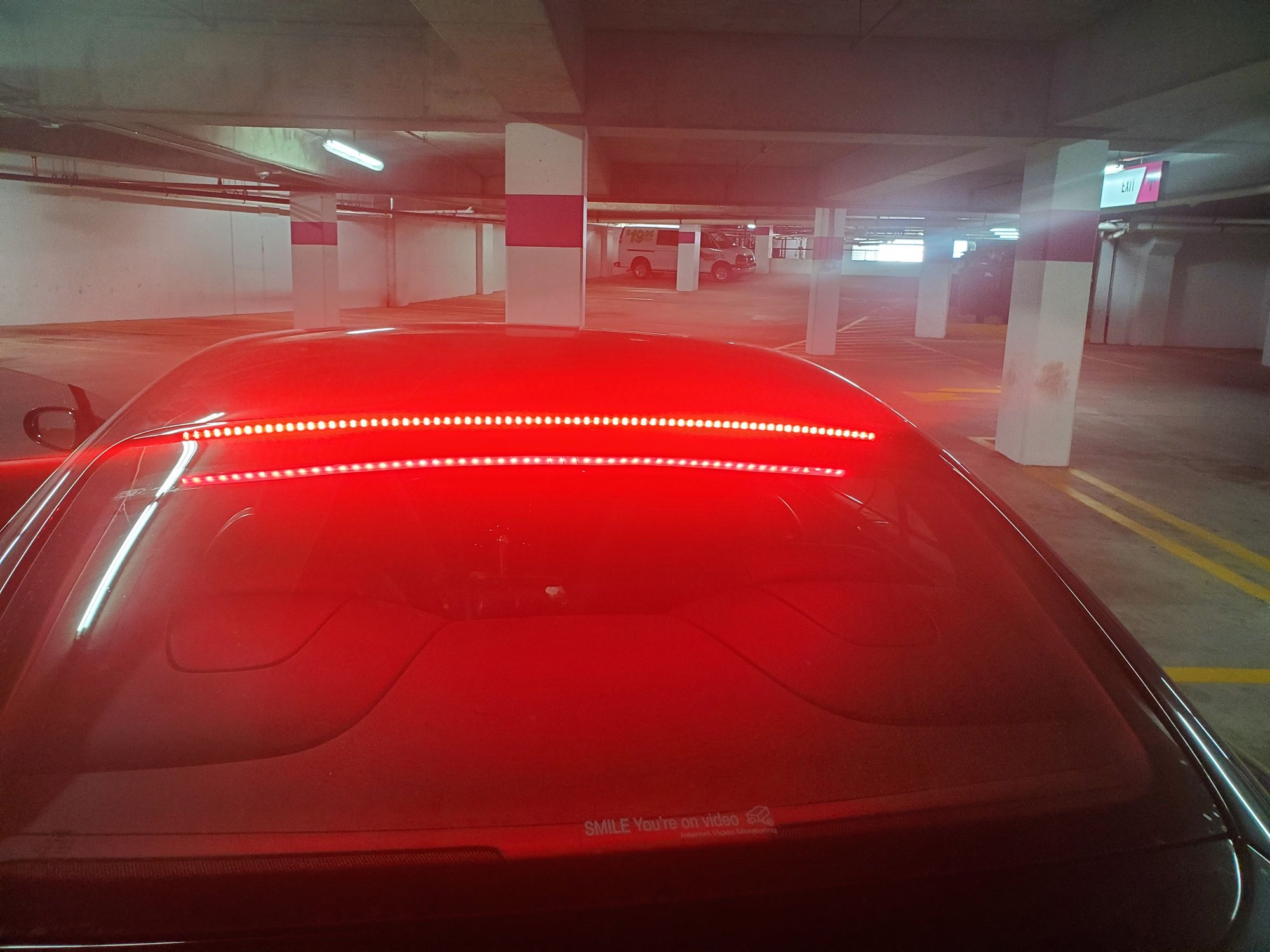

I agree with your point but if the new strip doesn't show when not lit up then the only person seeing the 2nd strip is the car behind me and I'd rather not spend the $3k and don't want cops pulling me over.

Its the risk to break the rear windshield which takes a $1k fix potentially to $3k. I take the points made but you literally can't see it when not lit, either from inside or outside . Its hidden , and when lit it looks identical to the original.
