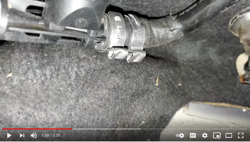

I have a 2007 Continental GT. I have an extended warranty on it, but I took it into a shop where they confirmed the vacuum leak with a smoke test, and without a CEL or something, the extended warranty won't cover it. So it's a small leak, and if I want it fixed, and don't have to listen to the vacuum pump turn on every time I touch the breaks, engine out $6500.
So I figured I'd buy my own smoke tester and at least verify for myself where it is coming from, and see if it was something I can DIY. It took a while, but I finally saw smoke leaving an area around the RH (US Passenger Side) catalytic converter area from below. I removed the RH wheel, wheel liner, stuck my scope camera down the steering rack area, and believe I found the leak.
A few questions: what could possibly be all of that nasty looking crap all over the T connection? Water vapor? I did have the smoke machine going for a while, to find the leak. Sorry for the terrible quality, it's pretty hard to maneuver the scope smoothly. Looks based on the condensation drop, the crack or leak is on the bottom.
Is this the same T connection seen here at around 1:05? This is only about a foot in to the steering rack, and I'm hoping I'll be able to patch this somehow pretty easily.

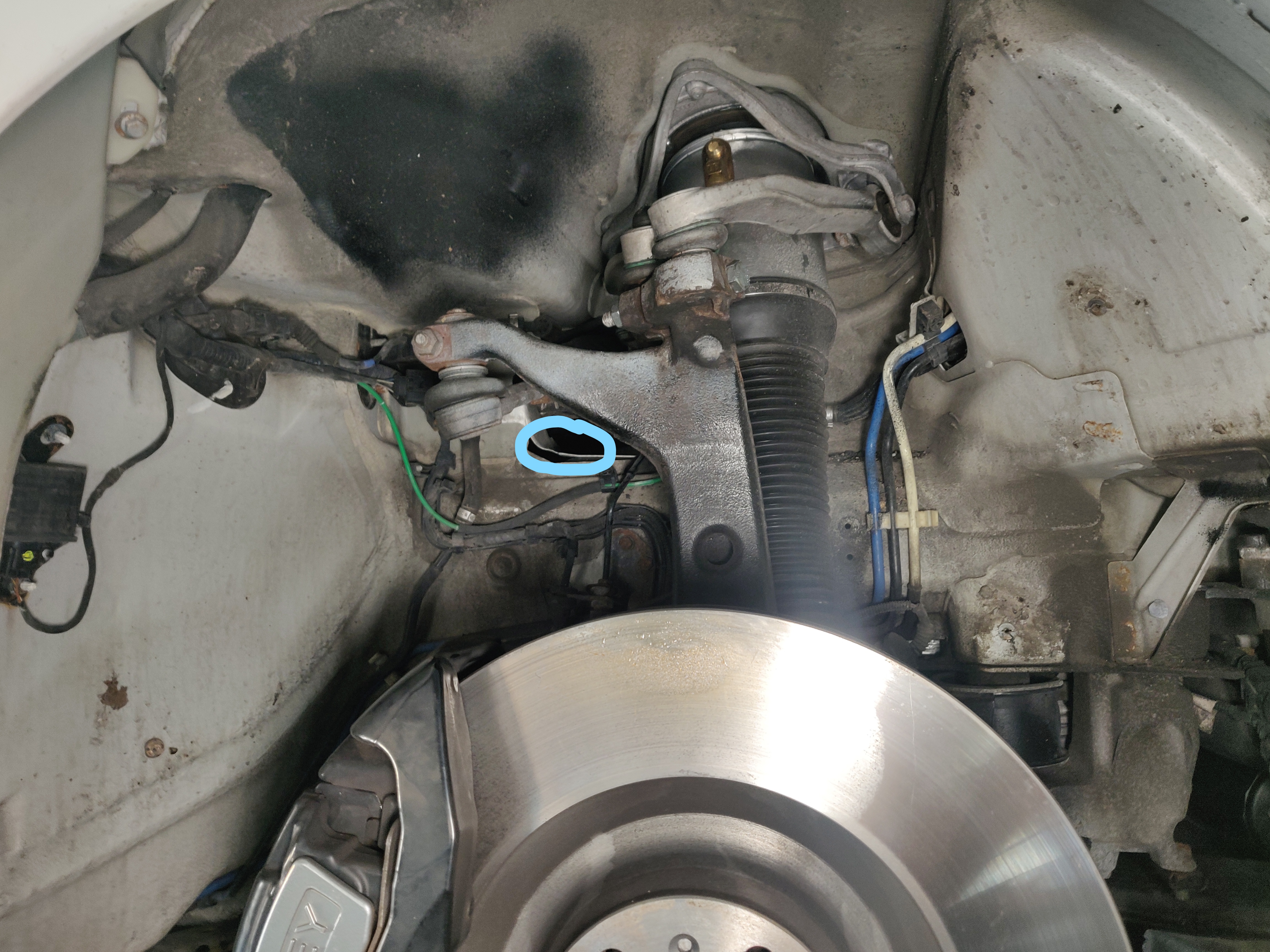

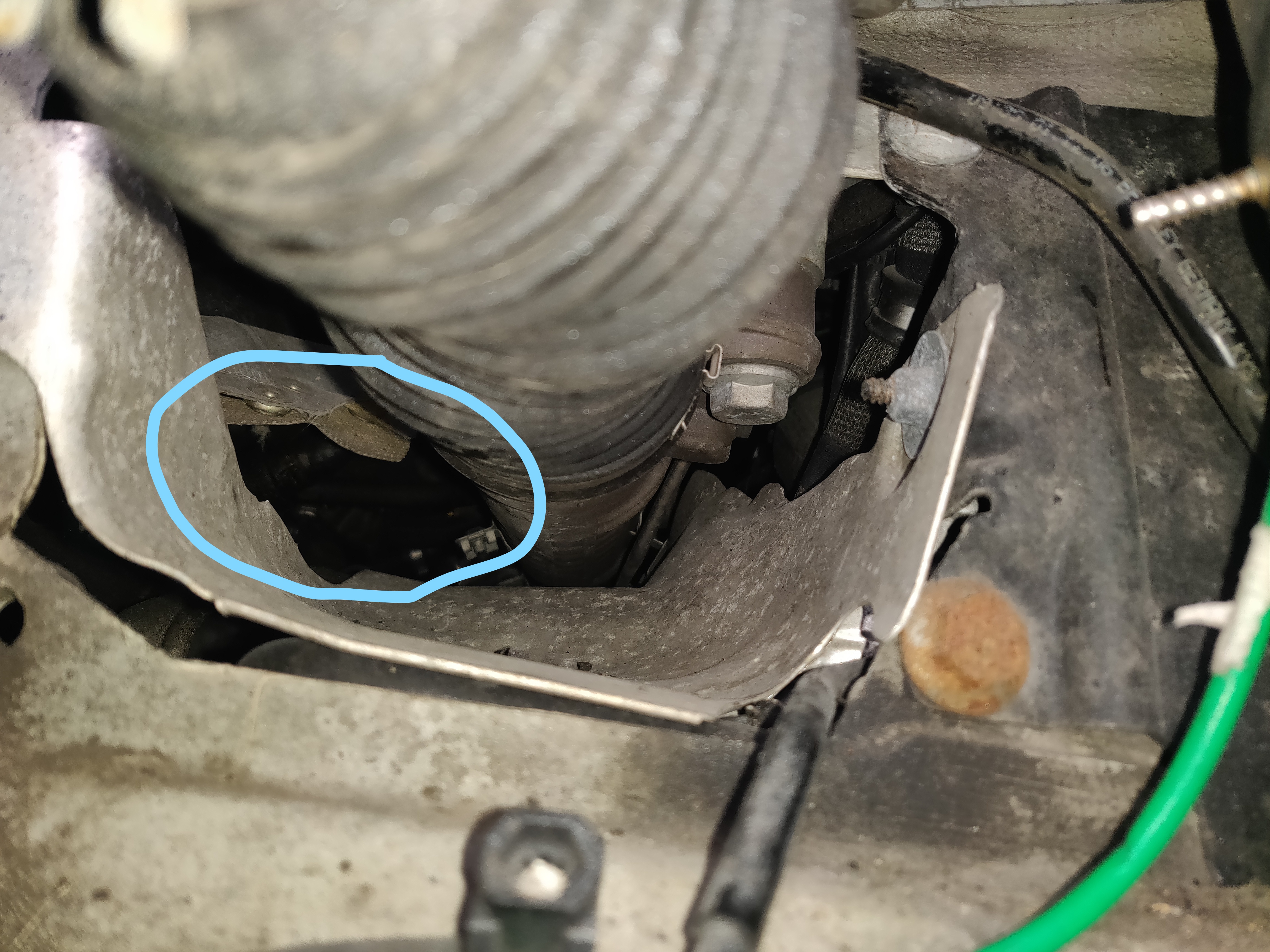

Here are some pictures to show the perspective of what/where I am looking

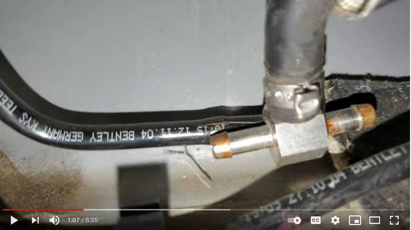

Also Jason's video here at 1:33, looks like this T joint is the nasty source of a few of these

Hello @silvertonesx24 ,
Yes that is my video, and I believe that you hit the nail on the head, that it is most likely the tee closest to the passenger side wheel well, now, this may be a crude suggestion of repair, but I would try it if I only had that one leak, iirc the heat shield is only held on by one bolt/screw in the area of the red arrow, the other end of the shield slides into a z clamp, so easily re-slid back I to the z, removing the heat shield would give you a little more access room, I would probably try either a very small amount of JB weld, or high temp black rtv, or the like, do NOT force to much into the crack that you clog the pipe, just enough to seal the crack, let cure for the proper time required, and smoke test again.
Not sure as to all the gunk, but did you ever have blown out CV boots, or leaking Valve covers, so, prior to trying the sealant repair, be sure to clean the area with the long tube attached to the Brake Kleen spray nozzle, ALSO be sure the exhaust is cold... !

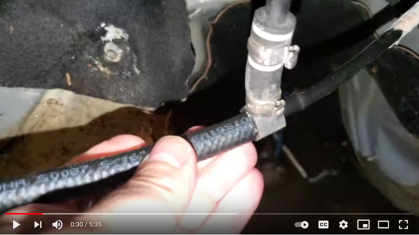

Thanks! I'm glad that it wasn't just me, thinking a small dose of JB weld might solve this. At least worth the try as that is my only leak.
Break Kleen is a great idea..I'll have to find an extension tube to get the spray in there and clean that up before trying to patch, maybe pick up a siphon spray gun
Now that I look at it again, I don't think my leak is from the closest T joint, it is from the second closest one. The one here at 1:28 in your video. I'll have to smoke check again to be sure, weird place for it there and not the other T joint.

Thanks @John Fiammetta @Johnny Hotspur GT , unfortunately today didn't go too well, I simply cannot tell where the smoke is coming from. Removing the heat shield gave me the maneuverability to work, but I can't find the exact leak! It seems like it is from behind the vacuum assembly shown above. I see a T connection there, but from my perspective, I can only see one end of that T connection, the side that faces the passenger wheel well, and I still don't think smoke is coming out from there!
Lathered everything up that I could see with JB Weld- still a leak somewhere. The mechanic that eventually pulls this engine to replace this eventually will have a good laugh.
Very frustrating, so close, the leak has to be right there.. yet so far...

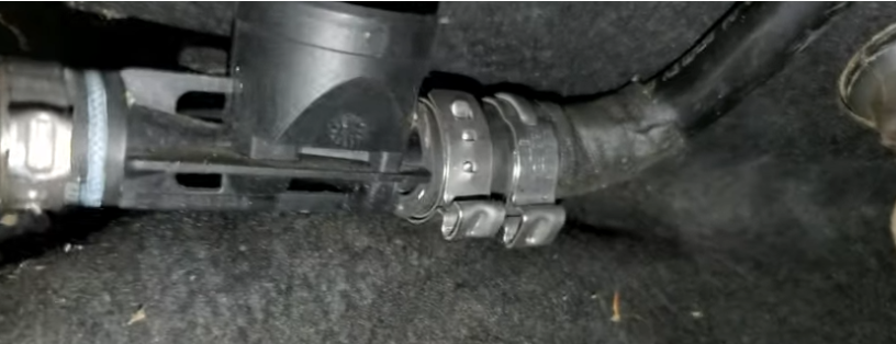

From Johnny's video
This connection is perfect.
I thought it maybe was this connection, but it actually looks to be coming from behind or under this connection,
So it must be this one? I can only reach the left side of this one. IF the leak is on the right side where the plastic meets the coupling, I guess in this case, I'm out of luck and it's an engine out to replace.

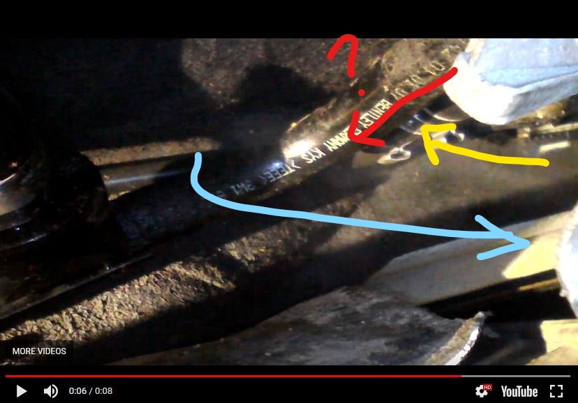

Perhaps my leak is indeed coming from the Passenger side of that tee, now that I look at the video carefully, it has to be?
Blue arrow is the direction of the smoke that's leaking out. Red arrow, that would be the area of the possible leak (behind the tube with "Bentley Germany" on it. The yellow area- that's the T that runs up to between the intake manifold?
So difficult in there with a small space, scope, inspection mirrors, and a light. The smoke only shows me the general area of a leak.
