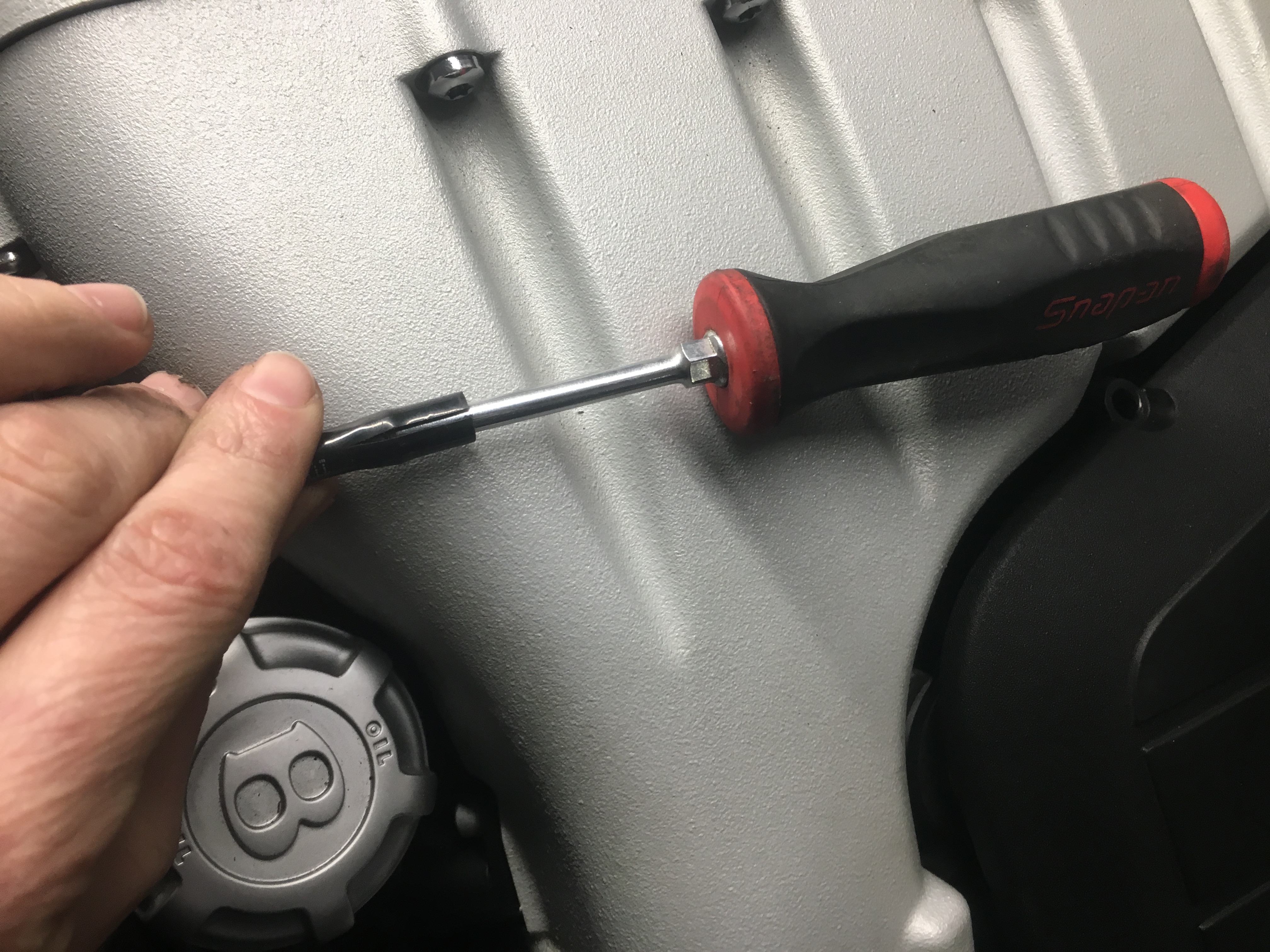

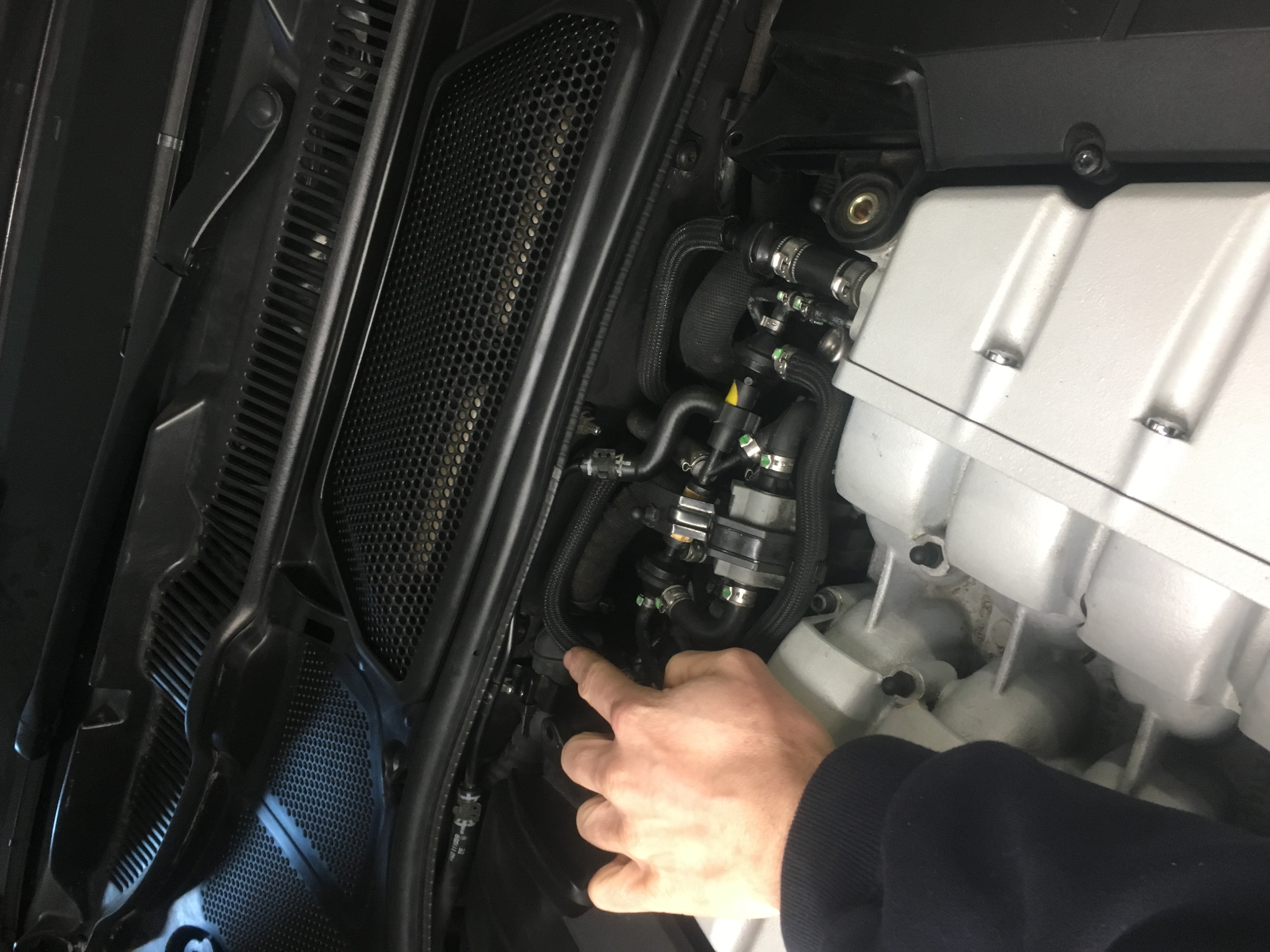

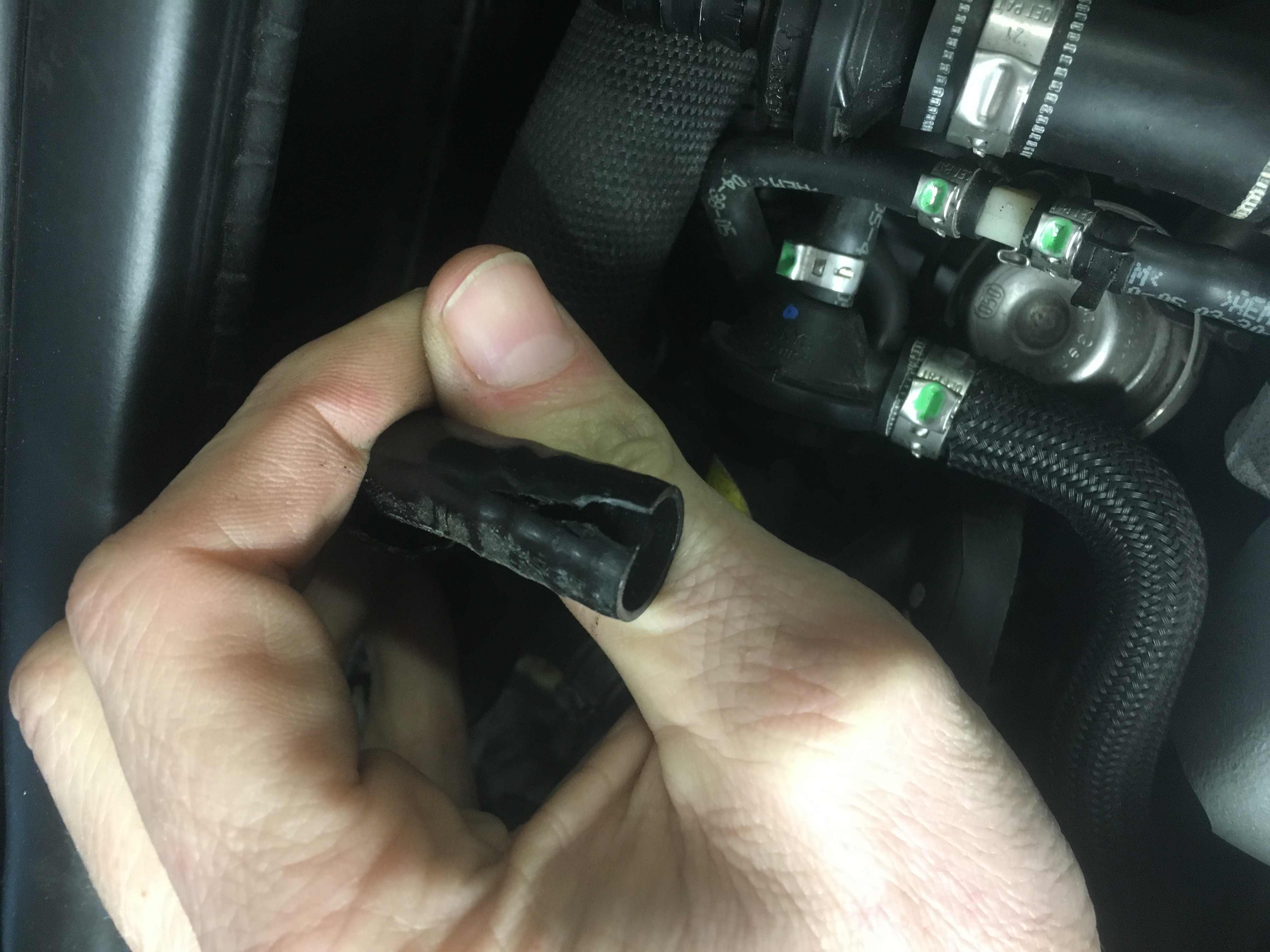

This is the location of the split hoses going to the manifold... I haven read anything about anybody else having a split hose there.
Actually, the hoses (that you identified) going to the manifold are quite commonly prone to splits and subsequent leaking. Also, hoses below and to the left of the radiator (looking at the front of the car) are also prone to leaking. Neither of these conditions require pulling the engine. However, the vac hoses on the top of the transmission (under and behind the shift mechanism) do require the engine/transmission out to be repaired.

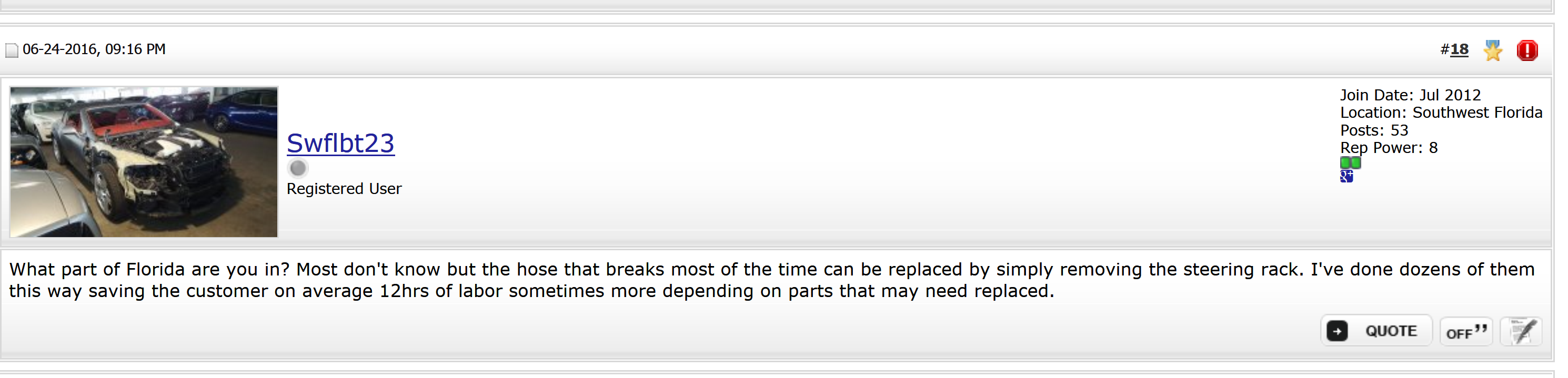

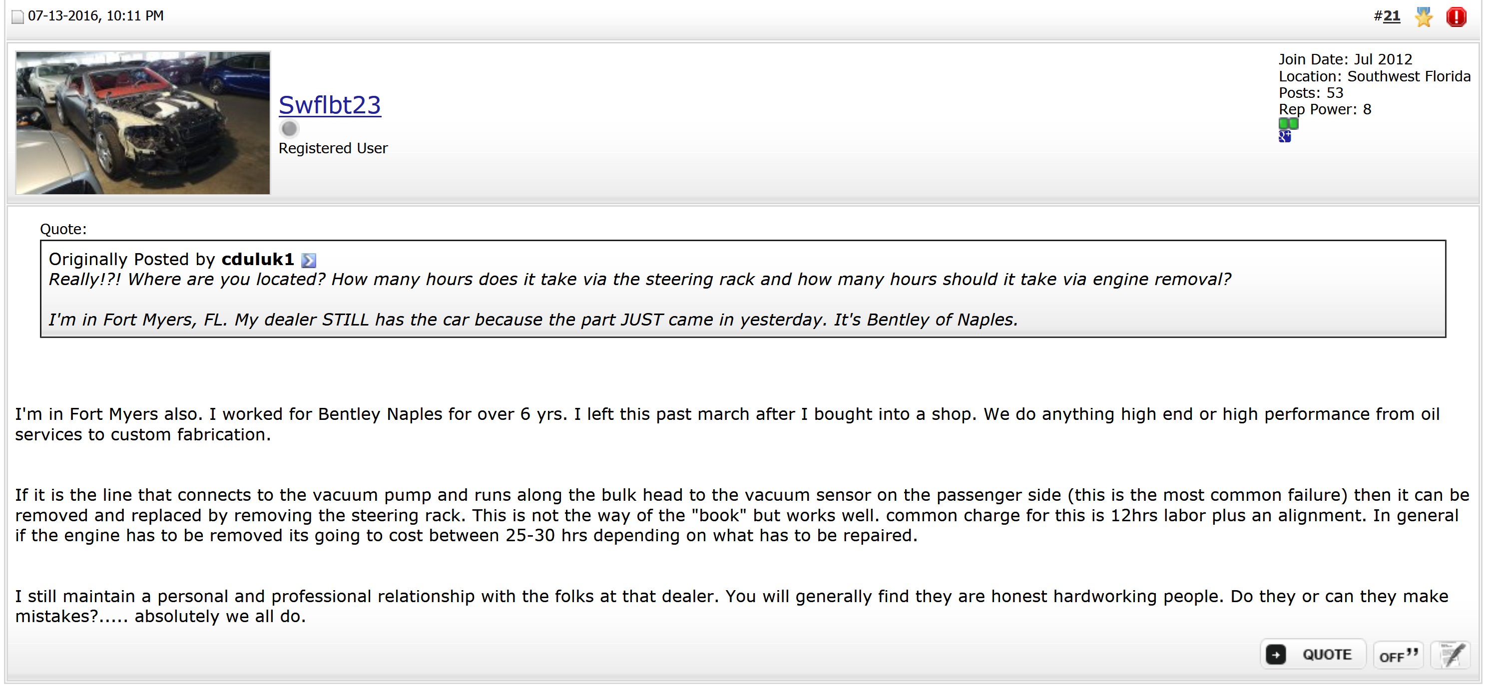

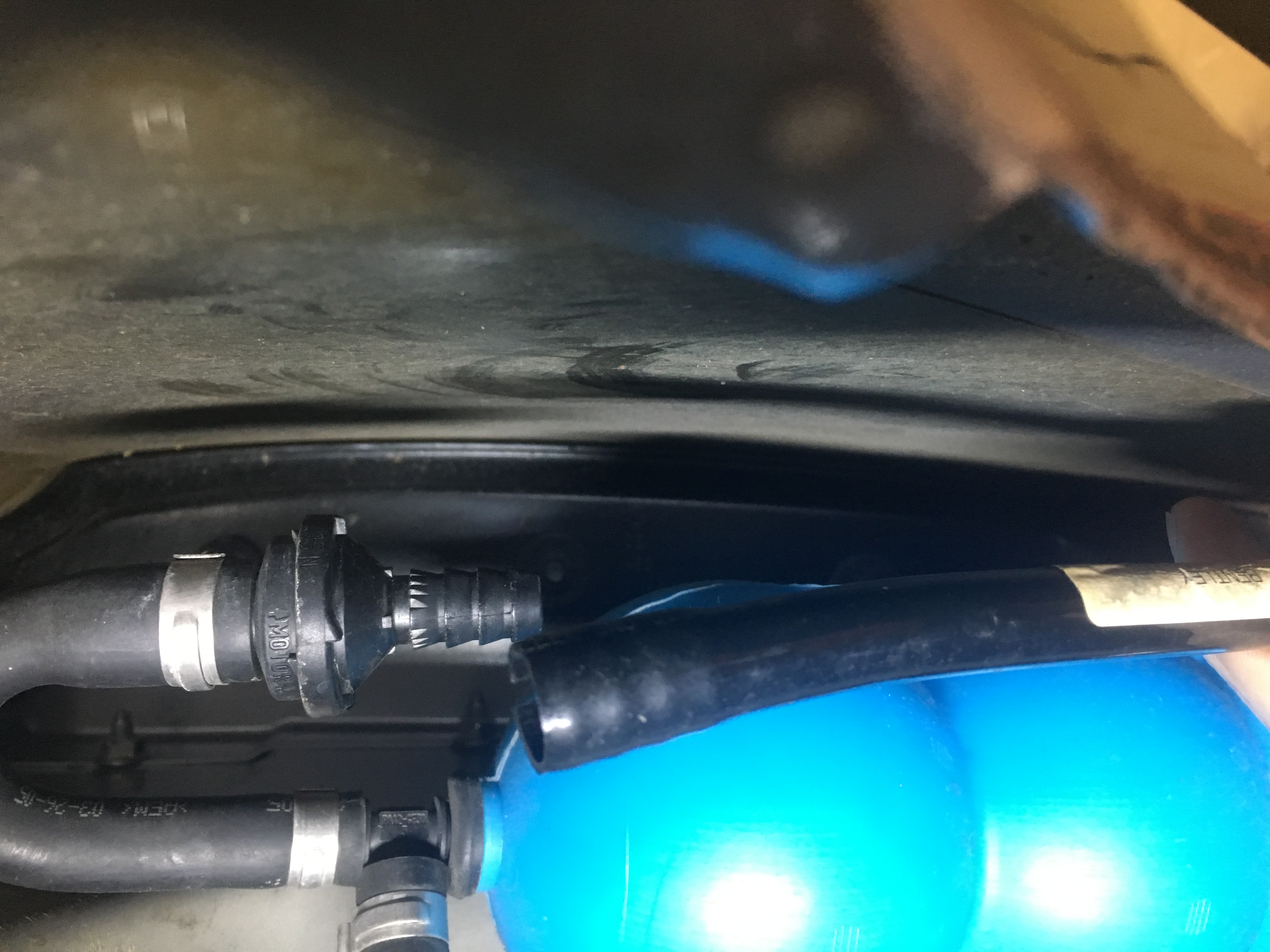

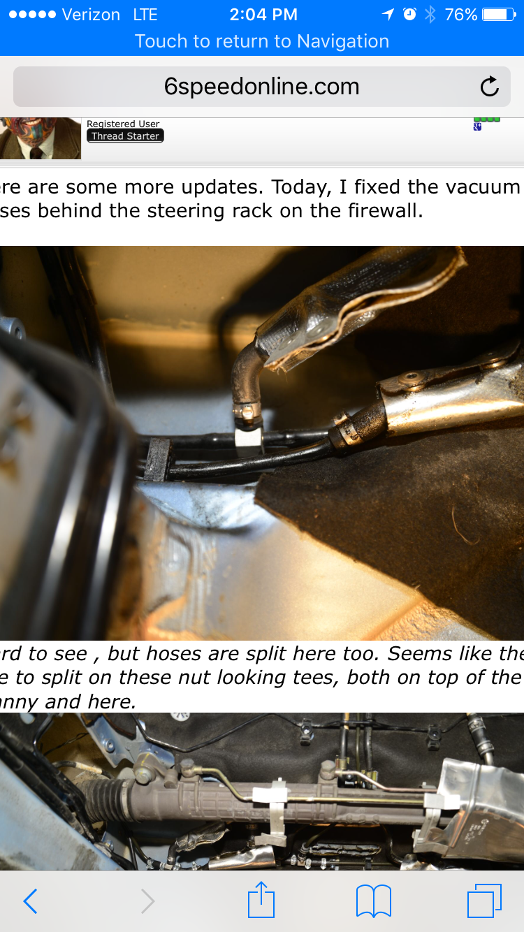

The smaller hose in the pic with the screwdriver in it showing the split is from behind the steering rack on the passenger side..... It came right off as soon as I moved it. My understanding was it is a engine out to do the ones behind the steering rack... Am I misunderstanding that? I was initially debating which vac line set up I had with it being a 06..... You can see in the pic with the manifolds there are the lines and vac system behind the manifolds. It first appears like the updated ones or what's on the flying spur.... Can somebody confirm that this does indeed have the vac set up on the transmission. Basically there are very few of these in my area so I'm going off mostly pics and info from this site.

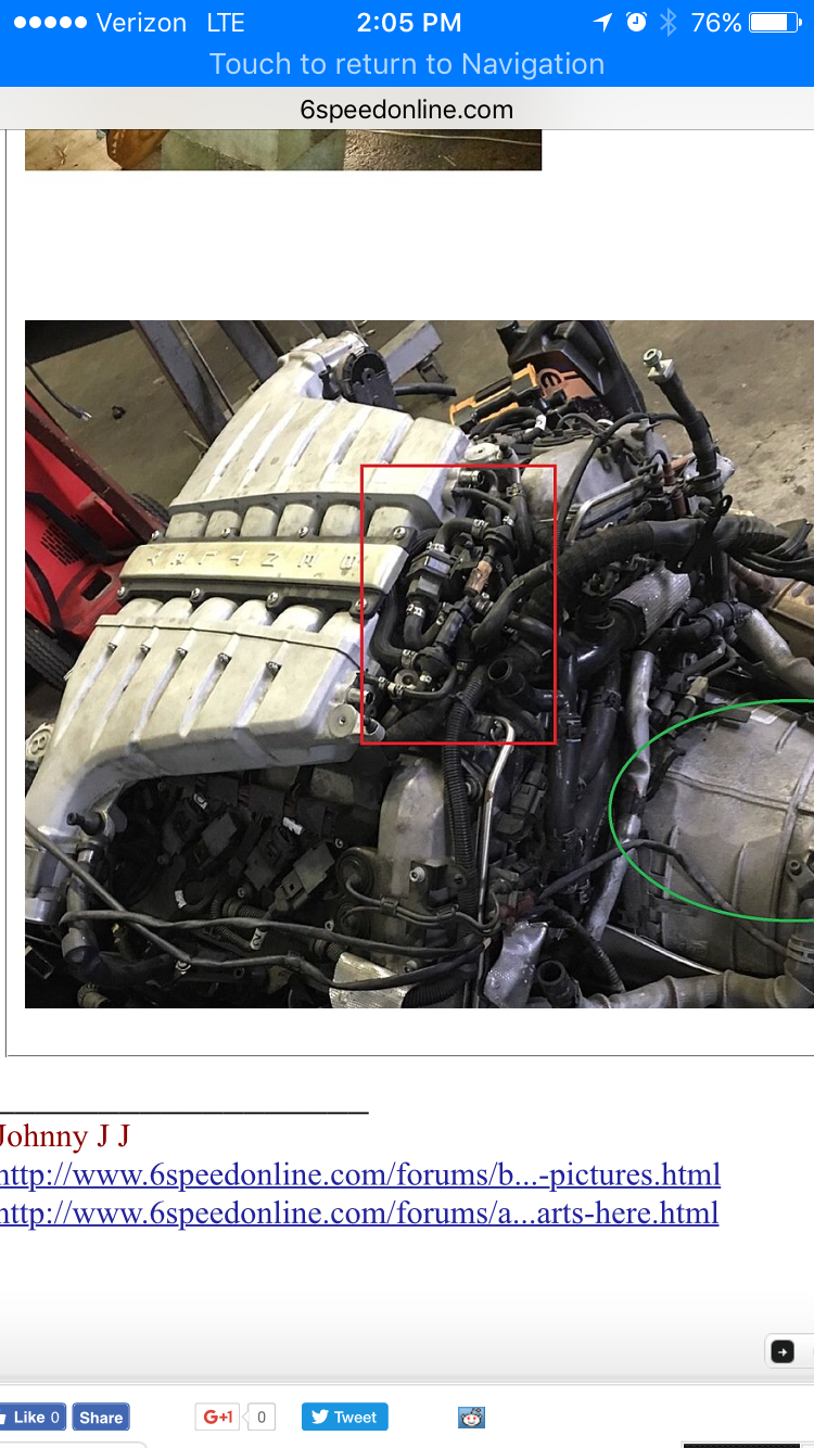

Both pics are from Zoas thread... the first pic is where I found the smaller split line. I had to use a inspection mirror and smoke test. It was clearly split, it came off as soon as I was able to reach it, that's why it is out... it is the smaller line pictured in My thread.

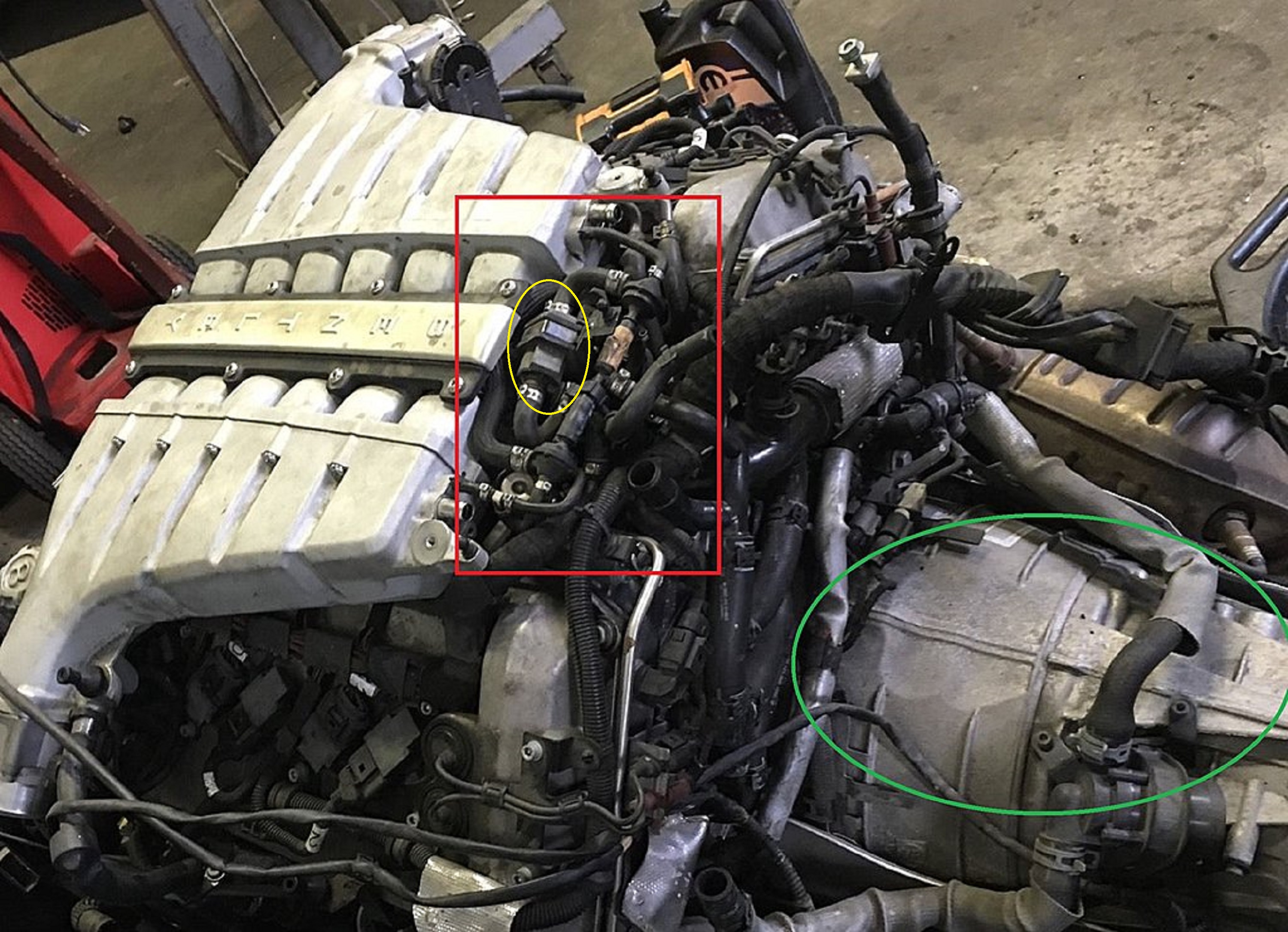

The second pic also from Zoas pic that shows the "updated location and the Flying spur location" it I itialky looks like the same vac modules in my car... but everything I have read says my vac lines are on top of the tranny... I'm not right in front of the car this minuite to take a additional pic. Thanks guys!
Hello AJ,
I believe you are referring to my picture of the updated GT or FS setup, in my picture you reference you will see one of the gray electric vacuum solenoids that control vacuum flow that I have outlined in a yellow oblong, and as I CAN see the same in your picture, you have one of the same solenoids visible, you DO HAVE the updated version, and therefore NO lines on top of your transmission, as far as replacing the vacuum lines by the rack, someone on here has stated that they in-fact replace said lines without removing the engine/trans package.

Originally Posted by PMS
a 2006 does have the dreaded vacuum junction mounted on the top of the transmission as noted in both Zaos and JohnnyHotspur's photos.
Hello Peter,
Unless it is a late 06, from what I have gathered some late 06's into 07 had the relocation of vacuum circuit and solenoids to the rear of in-take manifold, I know of some on here with 07's have stated they have had or the previous owner had the engine pulled at the dealer to have the "lines on top of transmission replaced", BUT did they actually see the lines on the top of said 07 transmission, or is it just an assumption that because the engine was pulled to repair a vacuum leak some automatically think it's the lines on top of the transmission, even though there are no lines located there....
As others whom work in the shops have stated, the dealer will still pull the engine/trans package to replace the vacuum lines that run along the bulkhead (rack area).

Originally Posted by Johnny Hotspur GT
Hello Peter,
Johnny, thanks for that clarification. I have seen three 2006 BCGT with the vac hoses above the transmission and just assumed ALL 2006's used the same configuration.
