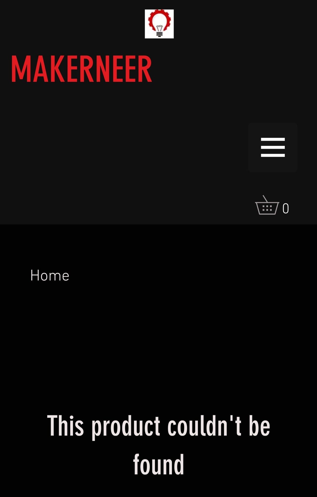

Hello @BruceR ,
Just a heads-up, the link in your first post now shows product not found...
Johnny

Looks like he may have dropped the item from his catalog - maybe because mine didn't work out so well.
