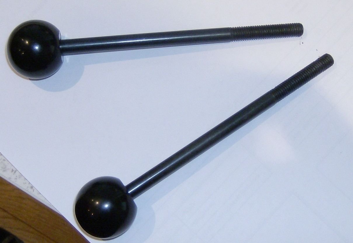

The guide pins that VW specify can be found by googling "VW special tool 3411"
I made assembled my own:

Thanks Dark Green and all, pins ordered.
The 3411 style pins were very inexpensive as several ‘clones’ of the vw pin are available online from some of the vw/euro parts houses.
