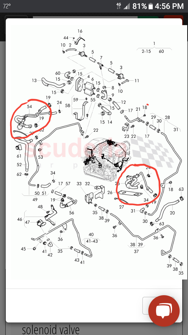

Regarding p0234, since a vacuum test on the diaphragm shows that it is functioning the problem is more likely a wastegate solenoid. The wastegate is opened by turbo pressure vented through n274 and n272 solenoids. (FYI usually VAG vehicles refer to the two solenoids as n75). They are located on the right and left side of the engine. Bank 1,right side is easier to get to then the bank2. A bad solenoid or if the solenoid piping is compromised one of the wastegates or both are not opening. The misfires are not causing the overboost. Attached is a diagram of the solenoid locations on a 2013 Bentley. The photograph is the bank1 wastegate solenoid on a Gen.1 Bentley. I believe Gen2 solenoids are located the same as Gen. 1?
Removal of the front end and radiator, for the bank1 solenoid and possible engine removal for bank2.

The bank1 solenoid is just above the alternator. The other solenoid is tucked back in that space behind miscellaneous components. This photo is of a Gen1 Bentley for reference.
