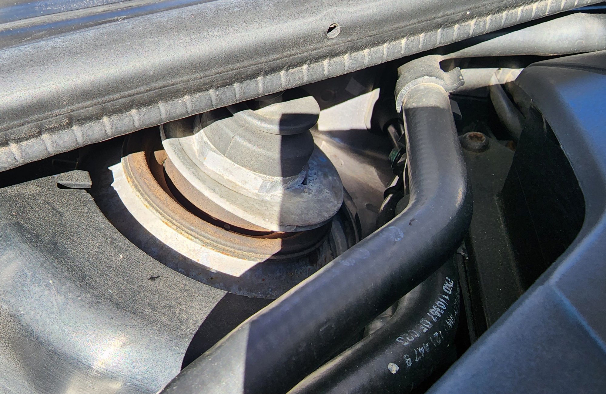

So did you find a solution ? I have the same problem
My car has exactly the same issue. I replaced both front struts myself with RMT rebuilt ones and the front drops about 3 inches over 4-5 days. it immediately goes back up when I start the car and no suspension MIL light is showing.
I checked for leaks using soapy water with the wheels off and no weight on the suspension and did not find any - though I'm thinking if there's no load on the strut it won't leak anyway. RMT says the struts were fully tested before shipping so they don't leak and I need to re-calibrate the system. I just have an Autel Diaglink not a Ross-Tech so I don't have any way to re-calibrate. If I'm not getting any MIL light I'm wondering if I should still get the Ross Tech to do a full diagnostic or just press my case with RMT and ask them for replacements ?
I appreciate any and all suggestions

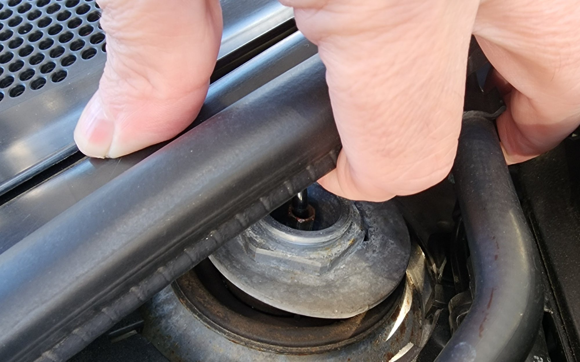

Found the leak
Thanks Johnny, I followed your suggestion plus the methodology suggested by Louis from Audiworld and I found a leak at the top of the passenger side strut - see attached pictures.
The only thing I did differently from your instructions was that I put the car in jack mode to lift it and get the wheels off then I propped up the lower control arms, took the car out of jack mode to fill the system then checked for leaks. I also checked the valve block at the rear but no leaks there. I didn't start the engine as there was enough air in the accumulator tank to fill the system.
My only question is will a leak in one side explain a drop in both sides ?

Prior to removing the wheels, the moment I opened the driver's door I could hear air filling the system from the accumulator tank. The compressor did not start and I did not start the engine. This raised the vehicle to standard height. Then I put it into jack mode, raised the front on jacks removed the wheels, jacked-up the front wheel assemblies using bottle jacks under the ball joints then started spraying my soapy water over the air line connections on the strut as well as the bottom and on the top in the engine compartment. After about 5 minutes I took it out of jack mode and could immediately hear air filling the system from the accumulator tank - again the compressor did not start and I did not start the engine. Since the front of the car was on jack stands and the entire wheel assemblies raised on bottle jacks I could not tell how much it raised but I assume it was to standard height. I then removed the rear cover to spray the valve block and when I checked the fronts I could see the bubbles oozing out the top on the passenger side. Everywhere else looked ok.
So if a leak one one side will cause both sides to drop then I'm pretty sure it's just the passenger side that's leaking.
Thanks again for your help !
After about 5 minutes the bubbles started to ooze out of the top on the passenger side.
As soon as I took it out of jack mode I could hear air filling the system from the accumulator tank - the compressor did not turn on
