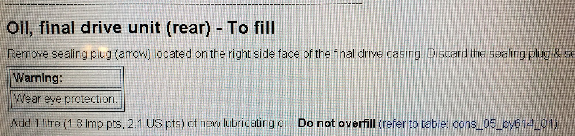

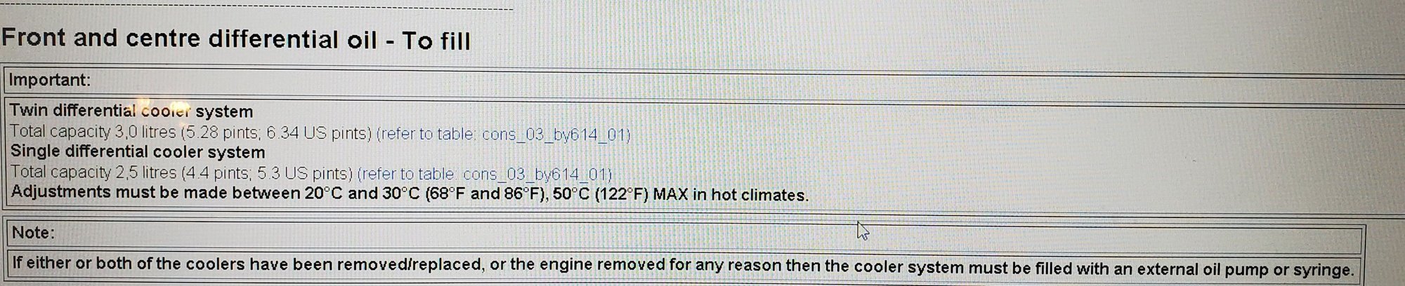

Hello Ed, @trottier.ed
I think you may have some confusion as to the differentials in your GT, it is either 1 cooler or 2 coolers, not 2 or 3, and these coolers only have to do with the front and center differentials, as the rear differential that you are referring to does not have a cooler, nor does it hold anywhere near 2 quarts, it holds 1 liter or 2.1 US pints, it is not a fill to flow out level filling procedure.
I would drain and refill with the proper amount.
See attached screenshots.
Johnny

​​​​​​Hello @trottier.ed ,
I just want to be clear, as you mentioned the 1 or 2 coolers again, the coolers have nothing to do with the final drive (rear differential) as it has no cooler, the 1 or 2 coolers are for the front and center differentials, so the rear differential volume is the only volume.
As far as what damage could happen, well, I am not 100% on this but, I was driving on my first long drive from NJ to Newport Rhode Island, and I heard a rear differential whine when on and off the throttle after some miles driven, kind of like when the ring and pinion are not set up right, and being that the vehicle only had between 9,000-10,000 mile on it, I honestly didn't give checking the level of the fluid prior to my drive much thought, but what I did do first, was to loosen the drain plug to see if I had any water contamination, the oil was clean and no sign of water, so I moved on to the next item on my list before the drive, well the whine bothered me so much that I thought the differential may explode, as I thought maybe it was dry, did someone else drain it, as I only tested a small amount coming out, well long story short, I did just as you did, I purchased 3 quarts and found a place to drain and re-fill the rear, and when only a quart of fluid came out, I was pissed at myself for not checking for the proper fill before the road trip, well I filled it to flow out just as your guy did, and I still had that slight whine, and thought that I did damage by not having it filled to the proper level, only later to find out when I returned home and checked the info, that the level was correct, and now I over filled it, and now I have slight seepage around the pinion seal that was not there before I over filled it, and I still have the whine, but I have a whole spare rear subframe assembly, so I may just swap out the diff...
Good luck !
Johnny
