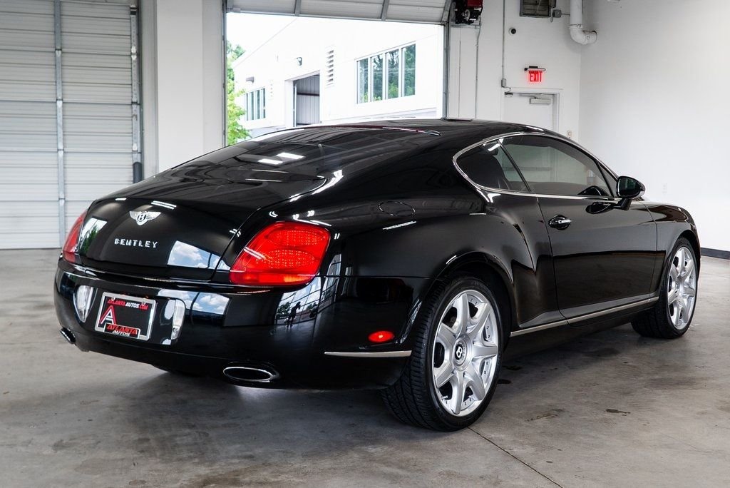

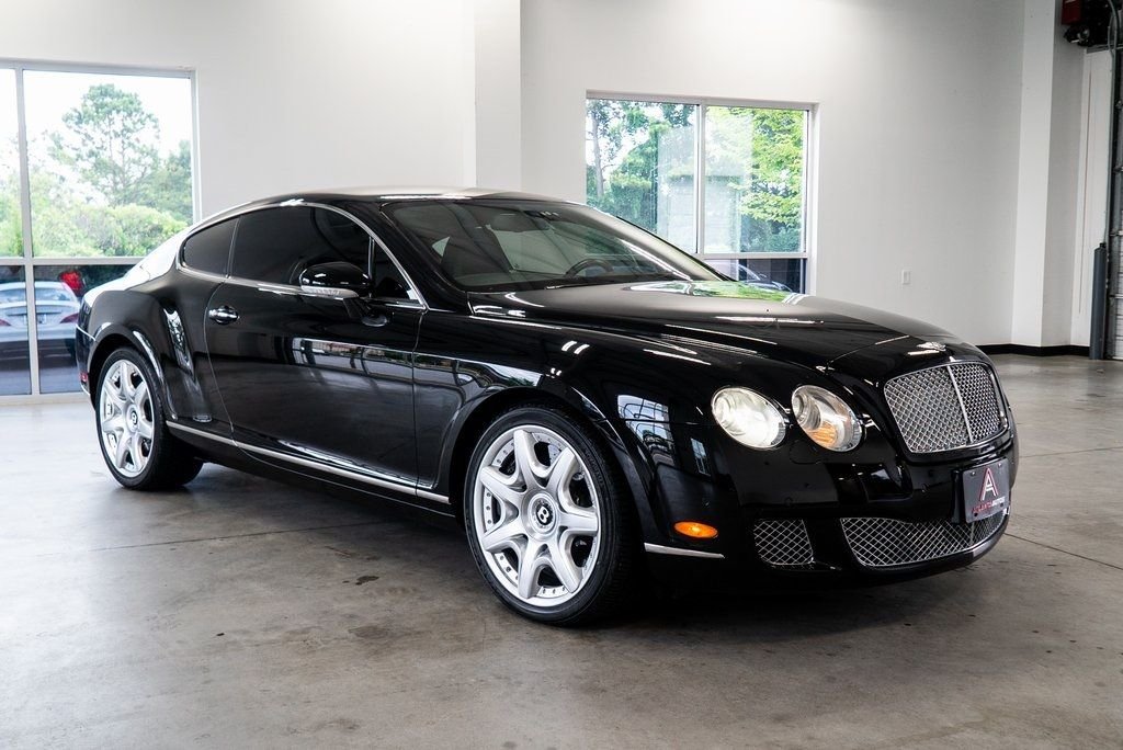

As to you comments, let's clear up the first issue of carbon ceramic brakes only in "front", as we had another member back in Dec 2015 being told he only had carbon ceramic brakes on the front of his 2007 Diamond Edition GT, that was simply untrue, it's either iron brakes all around, or carbon ceramic all around, never mixed together, if you would post pictures of all four wheels showing the rotors, we can all then agree on what you have, from the one picture you posted above, I say that you have carbon ceramics all around.

You’re exactly right, the car does have carbon ceramics all the way around.
