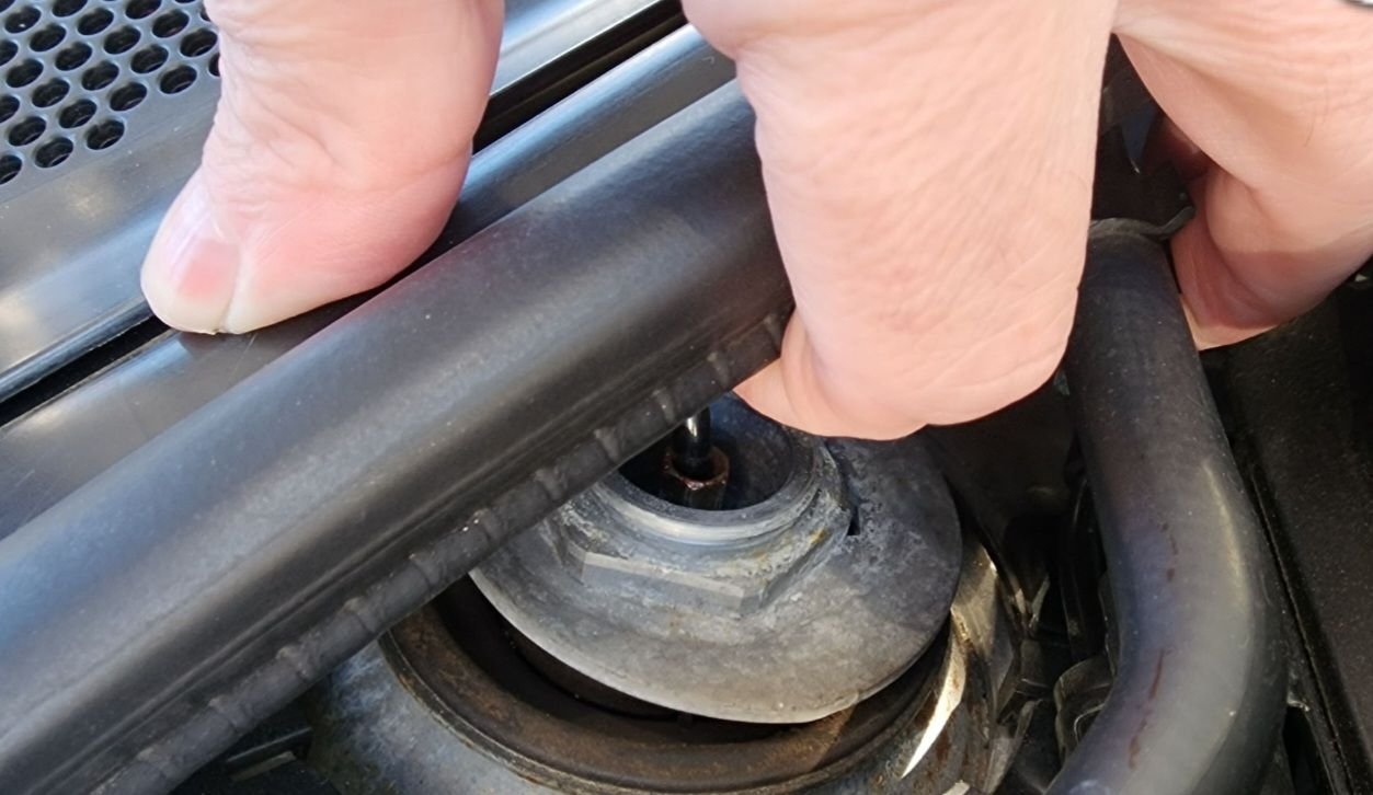

I found driver side is leaking as in picture, shall I remove the entire suspension to fix it or just unscrew the small screw and apply Teflon to it and put it back, any ideas please
