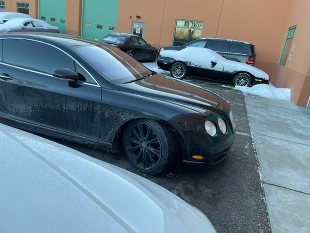

So not sure if it’s the snow or that it’s 0 degrees out but the suspension on my GT is not happy. Worried that changing out this head unit i put my suspension out of whack. Getting “Car too low” warning and noticed this when I dropped it off at the shop. Tire is almost touching. Wonder if I get my suspension out of sync or something. Seems odd too lose 2 air shocks at once.

They're both connected on the same "air circuit" as it were, so when one leaks it drops.
As I mentioned on the other thread, I think it's pretty obviously a bad air strut in the front. Mine failed after I had a detailer really, really, really hose down everything because I was scared of salt. They got the seals somehow, car dropped a day later. Two new struts, I think $3,500 total and car is back to normal. I drove it on collapsed front end, because reasons, now the hood doesn't like to close all the way because I scraped the fender and clearly bent something, don't recommend.

Originally Posted by British
Trying to be optimistic admittedly but mine doesnt look as low as yours. I am hoping that the 0 degree morning is causing some issues. I had that same warning light yesterday but it cleared pretty quickly. I am planning for the west, hoping for the best.

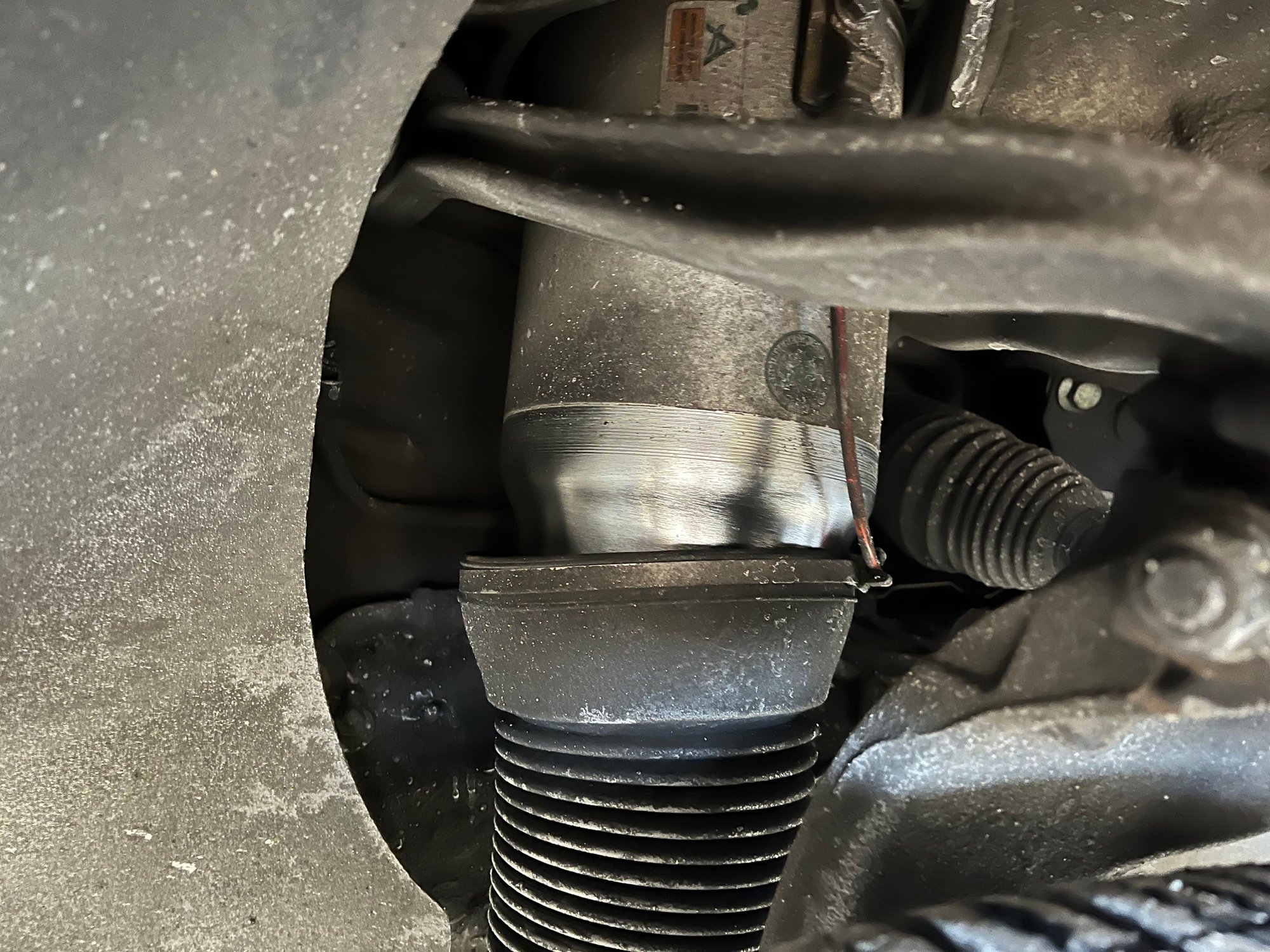

Soo @British looks like you maybe right LM Motorsports saying the boots on them are damaged, sending me photos. Luckily the suspension work I am doing they are already taking off the struts so not much more on labor but looking at $1100 per strut up front.

Just a heads up, the blown out strut you have on your vehicle now as pictured, is an Arnott, and Arnott are not oem or original equipment at all, also be careful as to their new in-house design that does away with the active dampening that the original factory equipment has.
I for one will never buy Arnott due to their deception as to rebuilt vs. remanufactured, then their deception of not informing buyers that they removed the active dampening when they first sold their "New In-house design", there is a resistor that plugs into the original harness plug that fools the suspension control module in to thinking the proper equipment is installed.

The photograph above shows the accordion plastic shield pulled down from the strut. That would not cause a leak. The air bladder is inside the upper large area. Hard to say what failed based on the photo.
The replacement airbag is pressed into the lower hydraulic strut assembly. This is a metal to metal interface with an o-ring. When assembling mine, sealant in addition to the O-ring was applied. That interphase looks susceptible to minor leaking. Spraying soapy water on the outside of the strut without pulling down the plastic accordion strut protector would not reveal leaks.
