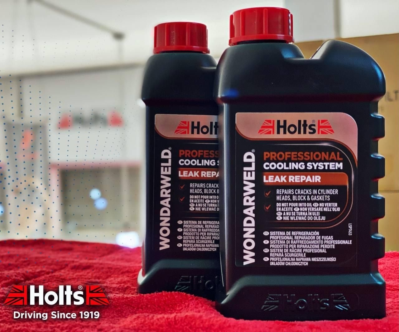

Hello members,
follow up to this thread, my mechanic advised to try block sealer products before taking the engine out, as the crack might be minor and could be fixed temp with this seal
today we together went through the procedure as instructed by sealant manufacturer to disable targeted cylinders, in my case it was 8,9 and 10 on bank 2, removed fuse #2 and #25 in the engine fuse box.
we then removed the thermostats and installed an old non working thermostats, flushed the coolant out and filled it with clean water, burped the air out fully and poured the product, started the car for 1 hour running only on bank 1, coolant cap was off for 45 mins and it never boiled and temp on vcds never exceeded 84. After 45 mins idle drove the car for 10 kilo and let the car to cool down overnight as instructed. Tomorrow will flush the water and fill with red coolant from abro and burp the car very well then block combustion check it compared to all cylinders and test drive it.
will update this thread tomorrow.
My car is 2005 gt with only 69800 kilo
vcds only shows p0545 egt 1.
car drives good and only overheat after 3 mins idle after driving, as long as the car is idle from cold start it never overheat, must drive it and then when standby it starts to boil within minutes.
sorry for the long explanation and my bad English 😅

A follow up to this thread, I have been driving the car for a week now and I can tell you this liquid block sealer is magic 😎
the temp gauge is normal and live data vcds shows the thermostats opens at 101c and car temp never exceeded 103c on vcds
when driving the car it stays on 97c on vcds
the gauge is at normal position.
bleeding the car was a tough job to do.
every morning before I start the car I check the coolant level and when I open the cap air pressure comes out, is this be normal ?

Hello @Shaqovic ,
That is just a tad on the hot side, but depending on your local temperature, it may be correct.
I must say, your deactivation of the failing cylinders was key to making the sealant work, I am not sure that I have read that in the past, but it makes perfect sense, no combustion pressure to blow the sealant out while it is curing.
As to the pressure release in the morning, after cooling all night, are you sure that it is pressure, and not a vacuum, is the upper hose hard in the morning (cold), or soft, and easy to squeeze ?
Is it spitting out coolant in the morning when removing the cap cold ?

@Johnny Hotspur GT - the same effect you can get by disconnecting coils from sparks? asking because i have other car with v8 engine I may want to seal it
@Shaqovic - what sealant you used - will try it if you have positive opinion

I agree, deactivating the targeted cylinders did help.
as to this procedure, it is writing on the bottle and also most videos I’ve watched instructed to do so.
regarding the pressure issue, it’s like opening a bottle of water which was thrown in the sun the whole day, maybe someone can drive his GT and try open the cap next day and revert.
on google some says it’s normal because of high pressure, and some claim it’s not normal.
I will double check the upper hose next time
I have used the product 3 times and each time I burp the car and flush and refill with tap water, each time used 2 bottles so in total 6 bottles were used then refilled with green coolant mixed 50:50
I did not test combustion after first 2 bottles, but my mechanic suggested a 3 times flush and refill with the sealant.
hope my thread would help

Two very simple ways to check if your still getting combustion pressure in the cooling system.
1. Nose / Sniff test. First thing in the morning or a cold start. Take off the filler cap and start the car. As it warms up have a good smell in the expansion battle.
If you smell any petrol odours, then you still have cylinder pressure getting into your cooling system.
2. Order a cylinder leak tester. Its a bottle of chemical thats changes from blue to urine yellow if any hydrocarbons are present in your cooling system.
In the uk ebay sells them for around £15.
