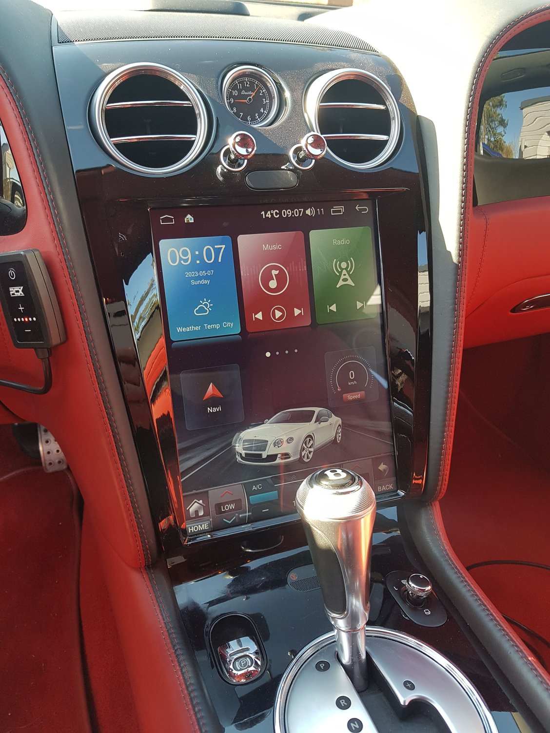

I haven't heard of Mozart Electronics before, but that is very similar to what other Bentley owners (including myself) call the Tesla-type screen.
Search for "Tesla screen" on this forum and you will learn a lot.
One of the images in your link is exactly the main screen in my Bentley. I am very satisfied with mine, but it is not 100% perfect.

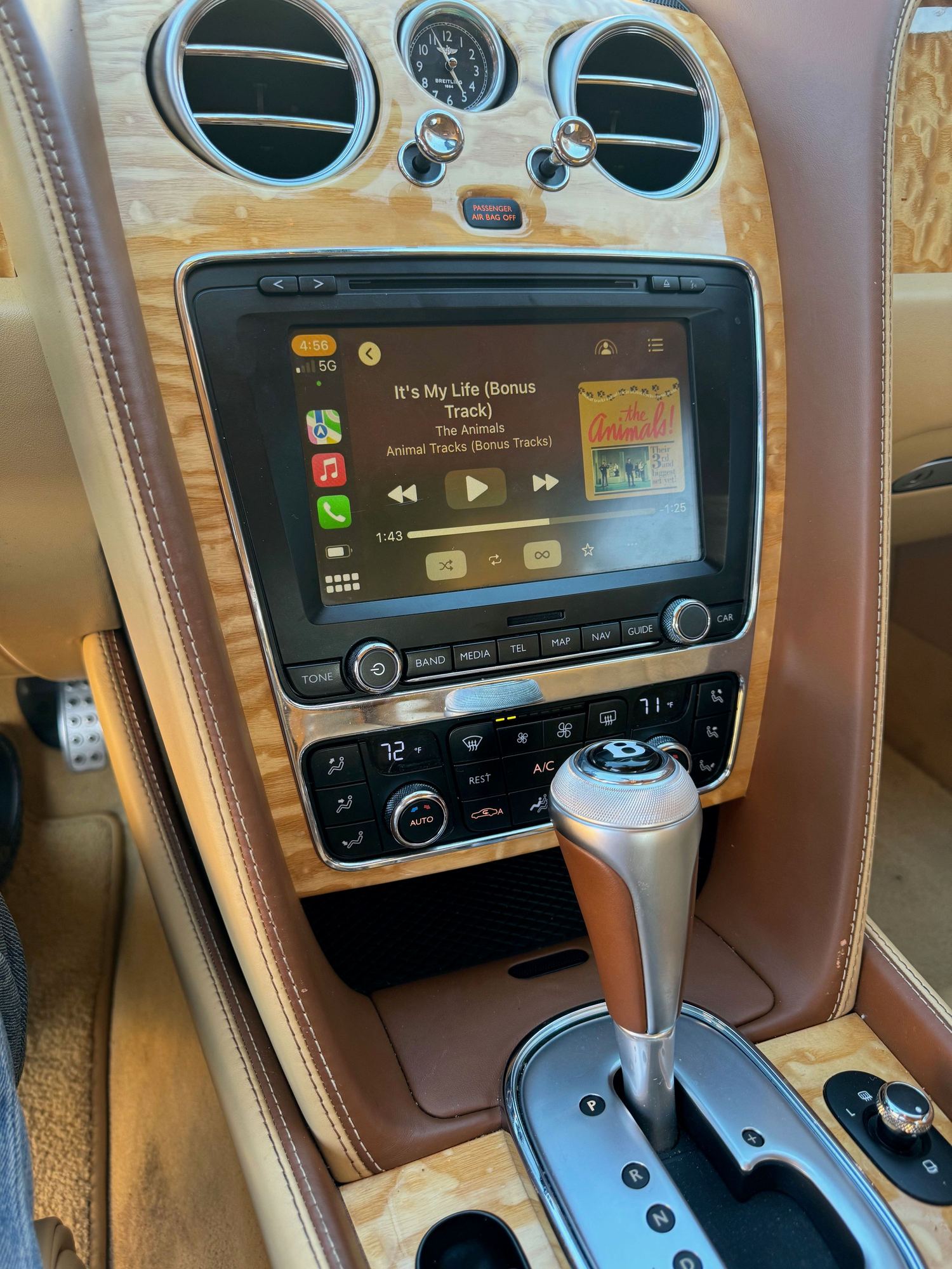

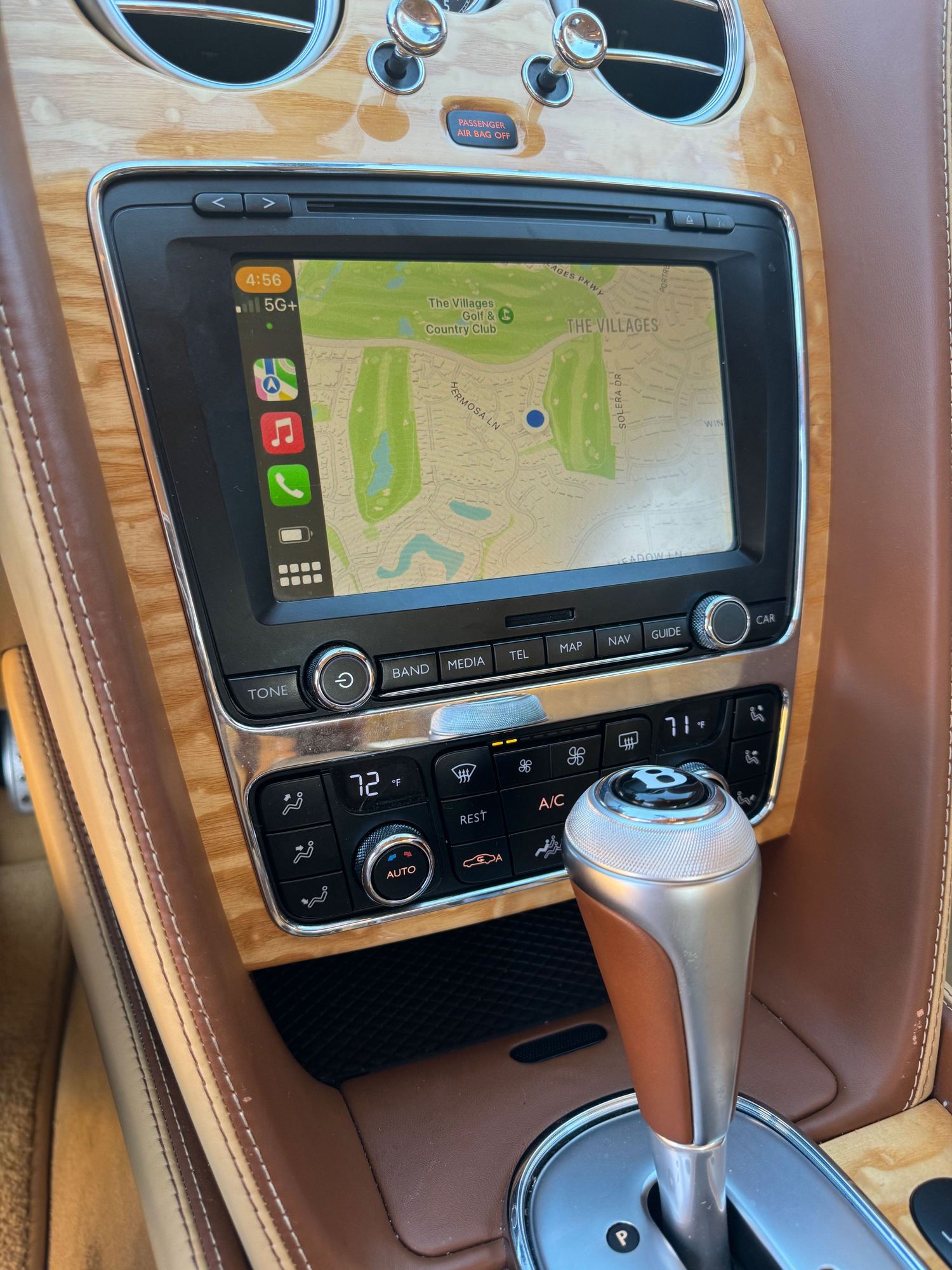

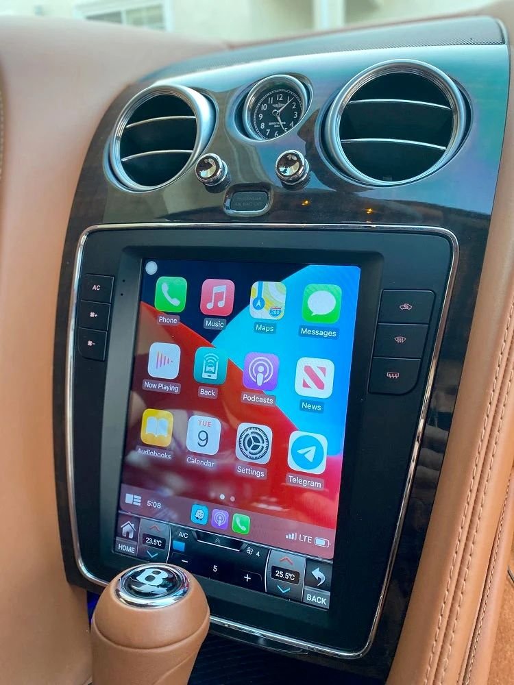

I own a 2013 GT Speed and just installed Apple CarPlay (does Android as well). I did a lot of digging as most of the ones I saw, including the Mozart version and other similar ones, had a big drawback. They did not use the steering wheel buttons and had to have a separate microphone installed. Made mo sense. I did eventually find one that does use the steering wheel buttons - the menu button long press swaps between the Bentley display and the Apple CarPlay display (more logical - no need for added buttons to do that or using one of the buttons below the screen), uses the voice button for Siri (Hey Siri/Siri works well) and uses the steering wheel volume button. In addition, it uses the car's OEM microphone - no need to add yet another one and have to wire it in. In addition, you only need to select AUX as the input and do not have to run a cable through to the multi-media unit in the glove box and plug in there (although see below). It is not necessary.
The vendor is Kremer Sino (yes - in China) and it is available through AliExpress - https://www.aliexpress.us/item/3256804683272133.html. It is nothing like as expensive as the Mozart units. I did ask Mozart about use of microphone etc., and got this answer: "Unfortunately, Bentley modules can't work with the original microphone, however, we are the only sellers that supply top of the line quality microphone with the module. (Not the cheap microphones that other sellers provide)." I did not buy it because of this and the price.
There is one issue with these add-on units - it is not all plain sailing. They suggest that you can simply add the extra bulky cables and add-on unit behind the original infotainment unit. Will never happen! Had the same issue with a Mercedes. There is simply not enough room. If you watch the video for the Kramer unit you will see that they wrap the unit in foam and simply slot it down into a gap at the back of the area you pulled the original unit from. On my GT Speed that gap was simply not there. There was no way to get the cables and the Kramer unit behind the existing infotainment unit. All is not lost though. I pulled the two main add-on cables through to the top of the glove box - there is a small pop out panel at the top above where the CD/DVD player is. (You can use a wire coat hanger to feed the cables). So in my case the add-on Kramer unit is in the top of the glove box. Works just fine. You will notice that the Kramer unit looks very different to the Mozart and similar units. See photos of the finished install in action on a Gen2. It is set to automatically fire up when I get into the car.
Hope that is useful!

@PeterHS That looks amazing! It retains the stock look that I love. However, the only issue that I'm wondering about is whether this can replace/restore a failing OEM head unit that is doing the constant rebooting bentley logo issue. Did you have that?
I think the issue is related to a HDD failure. DId you have that issue as well? - or did you just want to add airplay?

Yes it retains the stock look - with the Tama Ash I did not want to lose that! Did not have an HDD fail or the standard infotainment unit failing - just wanted CarPlay! Was so used to it on my other car... also convenience: for example looking up a destination on Apple maps on my iPhone and then having it automatically pop up on the screen in the car when I got in with no need to re-input.

@PeterHS Cheers to you - it looks awesome. I'm thinking I get my OEM unit fixed, and add this to it. That would be the best outcome for me.

Not sure about affecting or being affected by the rebooting thing. I did not have that issue. Just wanted CarPlay with keeping the original screen and wood veneer. I would check what he means by "mic built in to the unit". Given the response I got from them it means you have a separate mic and it is plugged directly into the add-on unit they supply with a 3.5mm plug. Not what I wanted at all. Did not want two mics. A video I saw showed hiding the new mic above where the screen is behind the veneer. Not ideal. Also note what I said about the room you have behind the infotainment unit to fit everything. It is usually nothing like enough. You will see other videos on YouTube where the add-on unit is underneath the carpet in the passenger footwell or double-sided taped to the left side of the center console. All rather "Heath Robinson".

BTW, I have Piano Black accents with my otherwise Hotspur red interior, and the shiny black plastic around the Chinese touchscreen is really spot on. I feel like I have a brand new 15-year old Bentley since I installed that screen. heh
