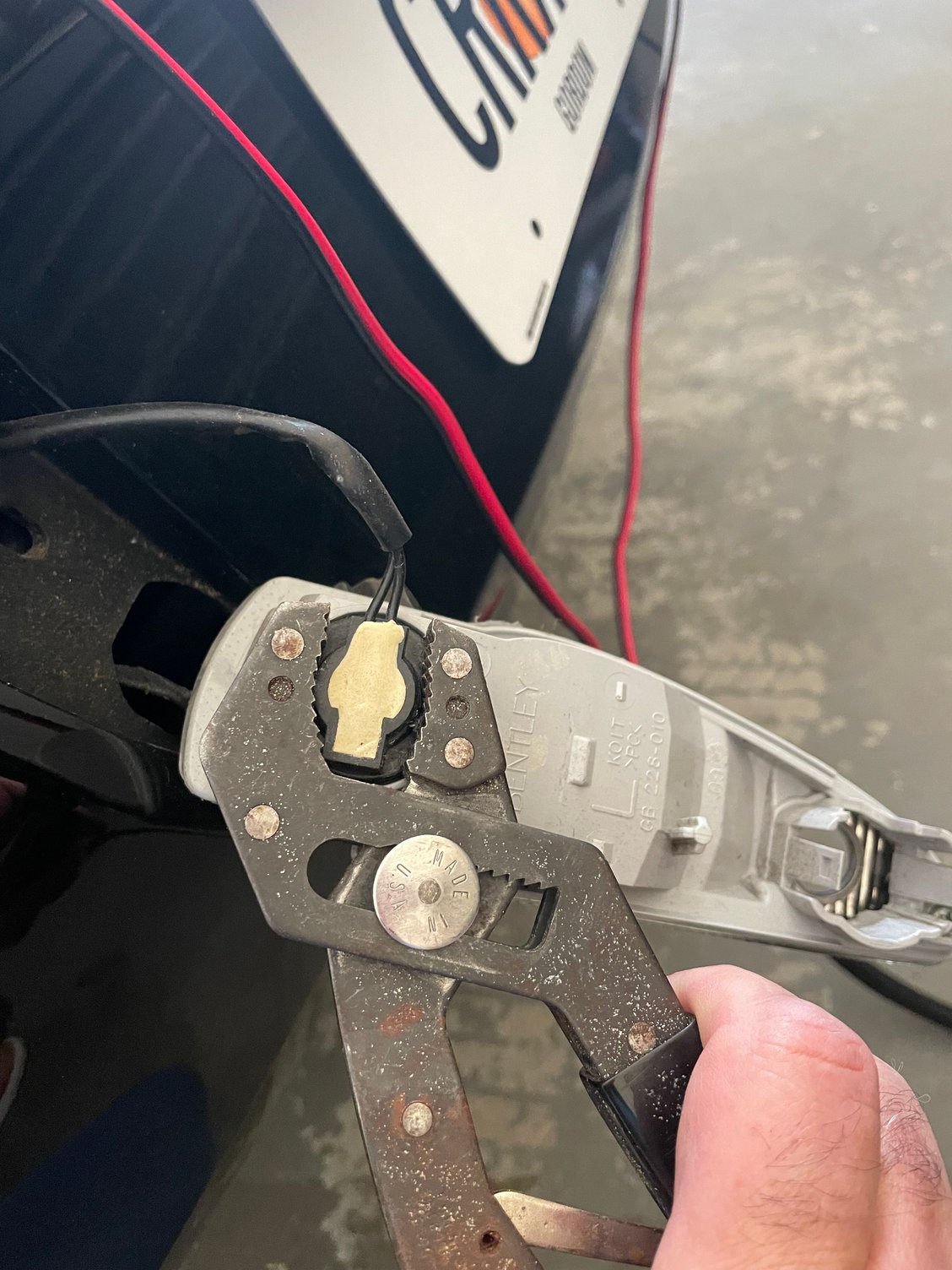

Problem Solved
Originally Posted by Mars911
This appears to be the bulb part we are looking for. Does anyone recognise it and know the part number for just the bulb holder and wiring? If not, does someone have an idea for the best place to look for it?
I believe the connector is part number 1J0973802 and the female plug may be 1J0973702
I believe, but still need to work on this one, that the actual light housing is part 1K6945259
https://www.laglobalparts.com/Catalog/Details/28233

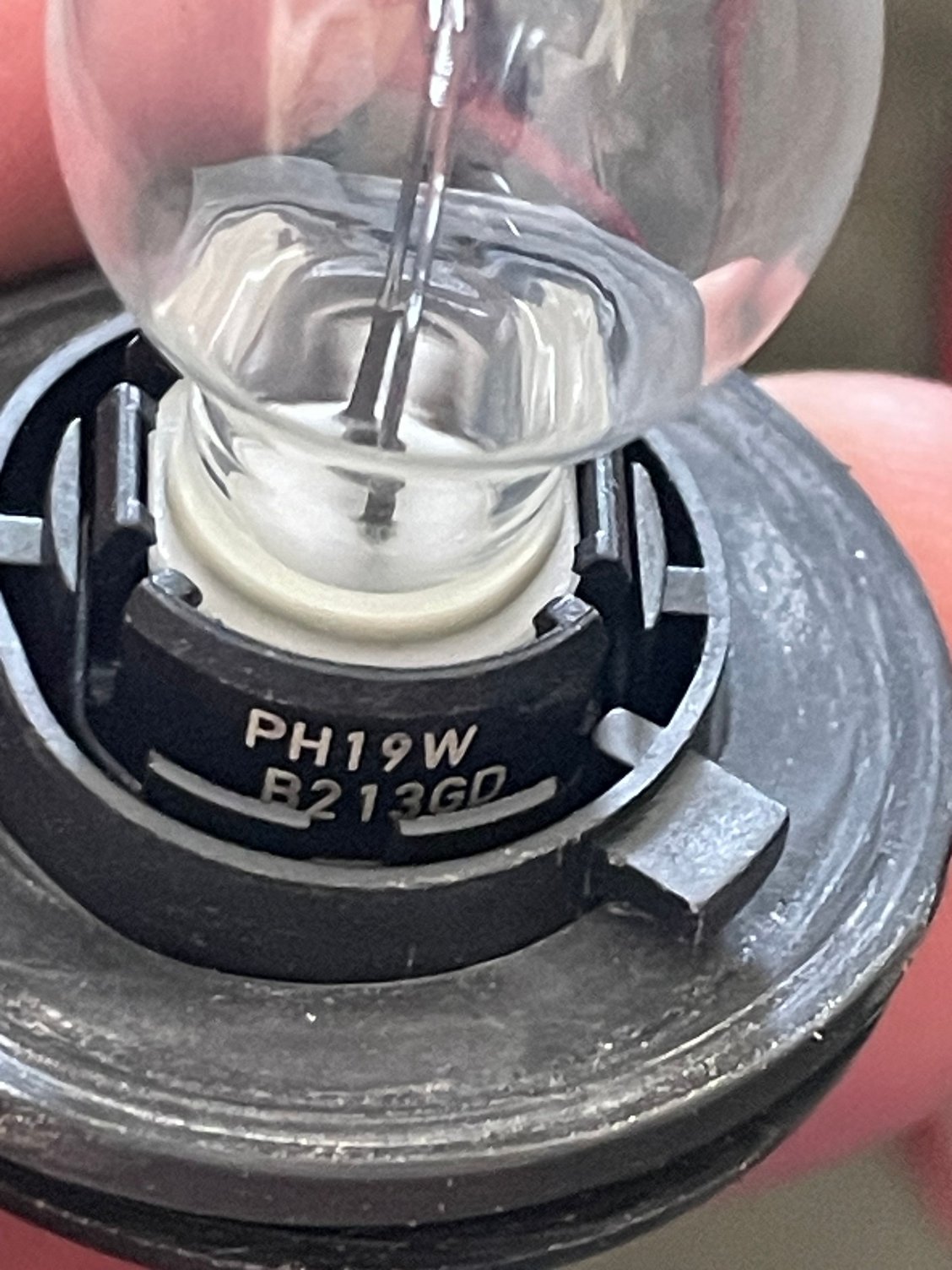

Good news, I was able to get the light to twist out of the housing and install it into the new housing I had purchased on eBay. I used a pair of pliers to turn the light socket counter clockwise to get the socked to come loose. I turned it slowly and it felt like it was going to snap. The same when I reinstalled it into the new light housing. After that it went right back in.
Carefully turn counter clockwise to remove light
Bulb inside the housing
