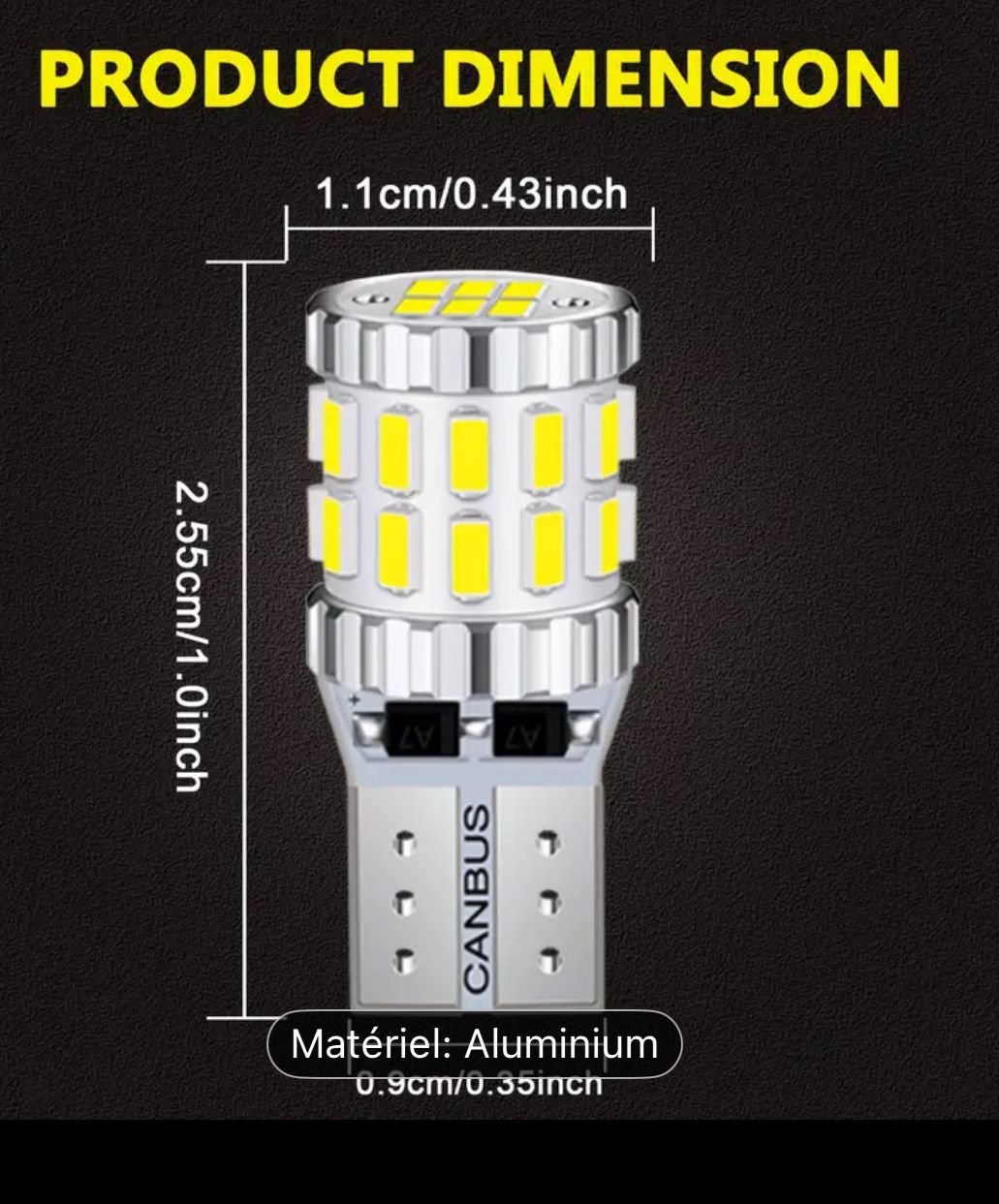

I replaced my housing since my housing on one side was discolored. My bulbs were still good so I did not try to switch it out, but the bulb was in there pretty tight and I was not sure how to get it out and didn't want to mess with it and possibly snap the tab holding the bulb in place. I believe the bulb is replaceable. Bentley does sell this as a single component and I do not know if they switch out the bulb or not.
the bulb is not replaceable
believe me , i tried , it broke
the wires are one piece from the bulbs into the socket
hopefully I have all needed tools to fix that
i I put 2 LEDs and melted the base onto the wire
Final cost less than 5€ + 30mn work
Compare to 200 for both R & L sockets and bulbs at bentley 😂
it seems also that socket + Philips bulb is not sold on the aftermarket
The reference if anyone finds a supplier let us know 2003-2010 Bentley Continental GT GTC (2004-2011) Flying Spur (2006-2012) Reverse Lamp Bulb ONLY Left or Right
3W0941071D
supersedes 3W0941072D
part number 1J0973802
the female plug may be 1J0973702
light housing is part 1K6945259
used that kind of leds but any W5W canbus with enough lumens will do
