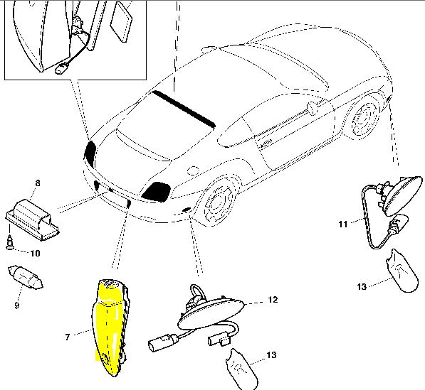

Reversing light: Part # 3W0941072A (see item #7 [yellow highlight] in pic. Plate light (item #9)=N0177252

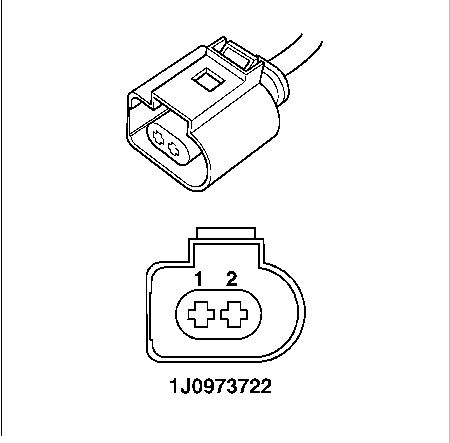

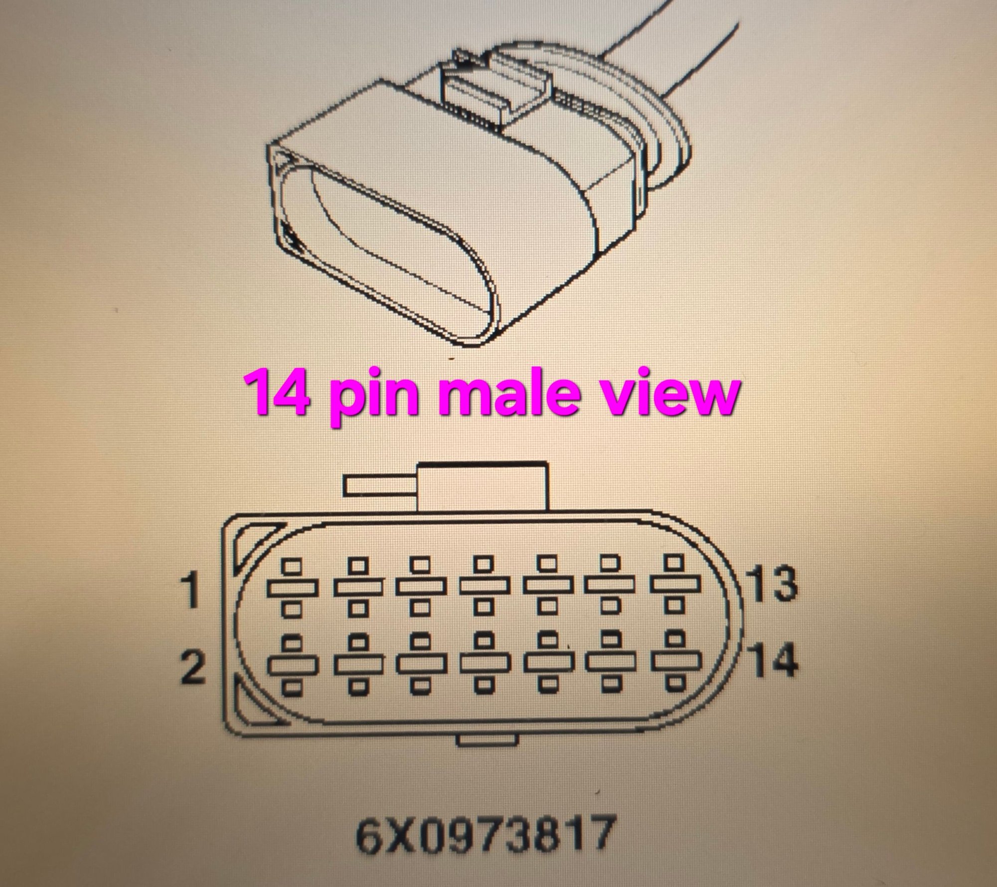

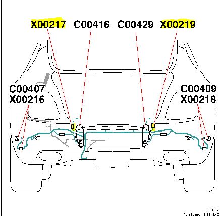

I've never changed these units/bulbs. Here are some additional pics. If you can't get at the connectors from within the trunk, you may have to remove the rear bumper.

here are the locations for the connectors (see yellow highlight)

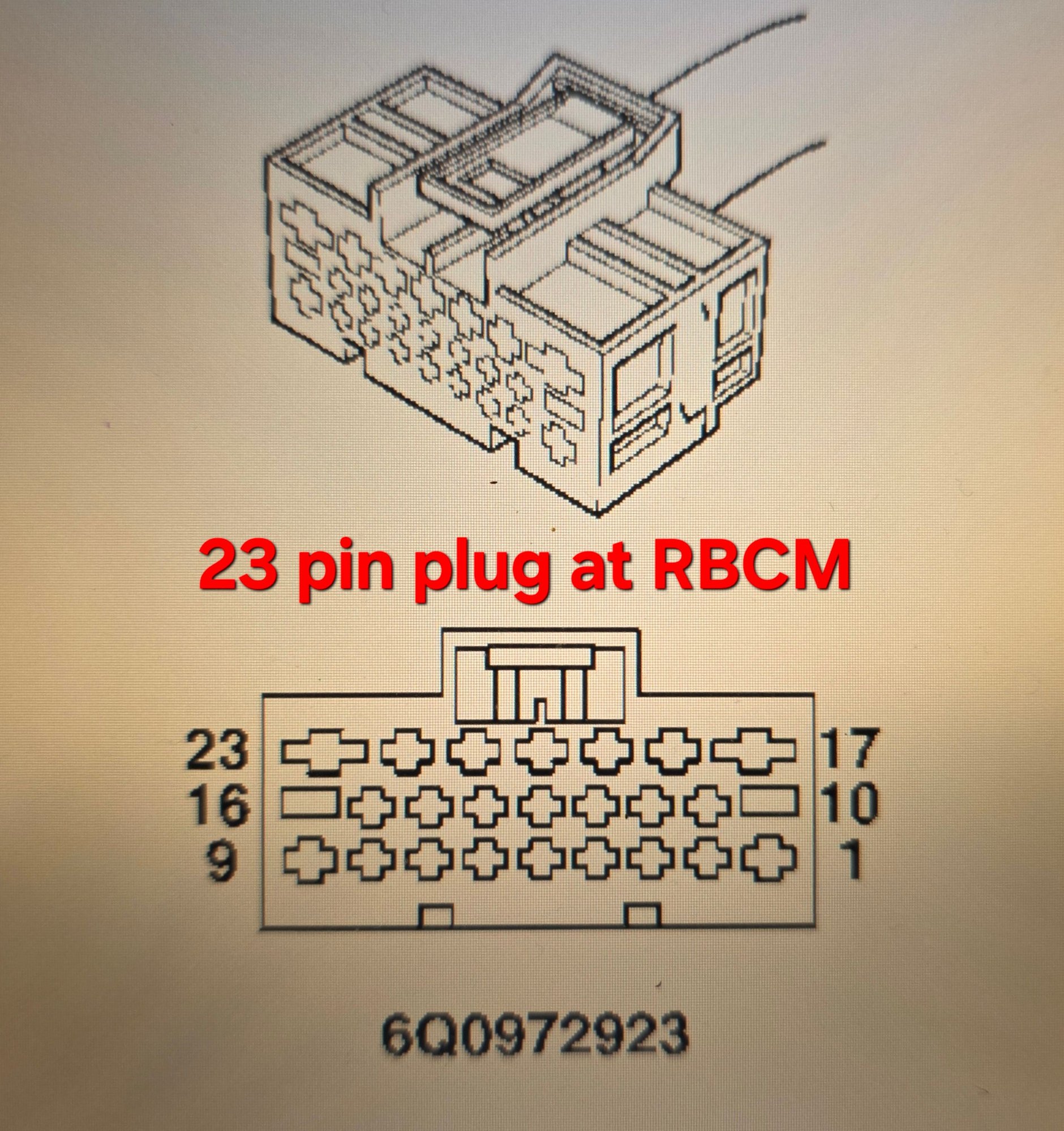

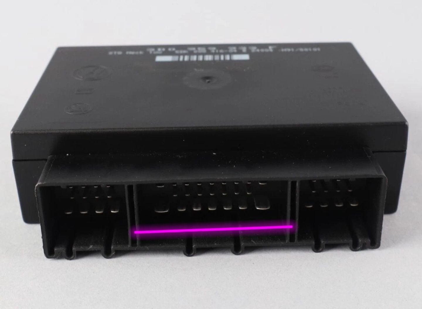

Hello
i’m hacking the thread just to ask if anyone knows were is the darn reverse light fuse !
I ve read all doc online and paper but no fuse ..,
I’m pretty sure the contactor on the gearbox is not directly connected to the battery…
but all 3 boxes fuses are ok but I have no +12v on both lights 🤬
Thanks for any idea

Hello @Yoann6 ,

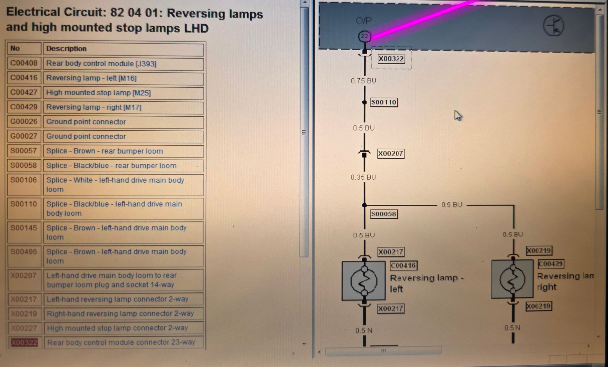

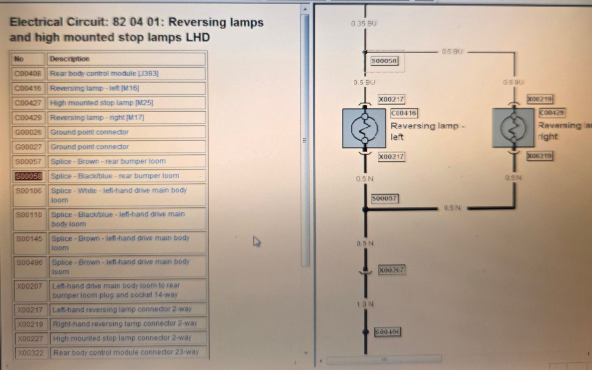

As you have said, I also have found no fuse dedicated directly to the reverse lamps, but other fuses that also go to the Rear Body Control Module, such as stop lamps (CM) that feed to the RBCM, same as for the gas lid release, and the bootlid release, open and close, these all go through the RBCM.
So eventhough your taillights / turn signals, and brake lights may be working, I would check all fuses that tie to the RBCM, starting with number 59 in the Facia fuse box.
Then I would verify power at pin number 22 in the 23 pin plug of the rear body control module itself, (pin 22 is a black and blue wire), this is, with everything plugged in, and the shifter in reverse, engine not running of course, if 12 volts is present at pin 22, then I would, or you could check here first, the 14 pin plug at the rear exterior up behind the bumper, pin number 13 is the same black and blue wire to the reverse lamps, it is only one wire that is later spliced into two to feed each lamp in the bumper loom.
Good luck !
Johnny

WOW ! You’re amazing!
even with the schematics ! You should open your own Bentley Garage !
If you want to move to the Riviera , MP me …
I’ll be happy to help and return the favour
btw where did you found the electric plans?
is that from IETIS ? I searched online but no luck
I’ll try this asap. I’m going in Italy with a stop at Bentley Firenze for maintenance, they took care of the car from day one … so , I’d be better served than with the jerks around home… ( not the ones in monte-carlo , pretty serious and square there, but their planning is full for weeks, and i prefer not to wait longer with last year maintenance skipped )
