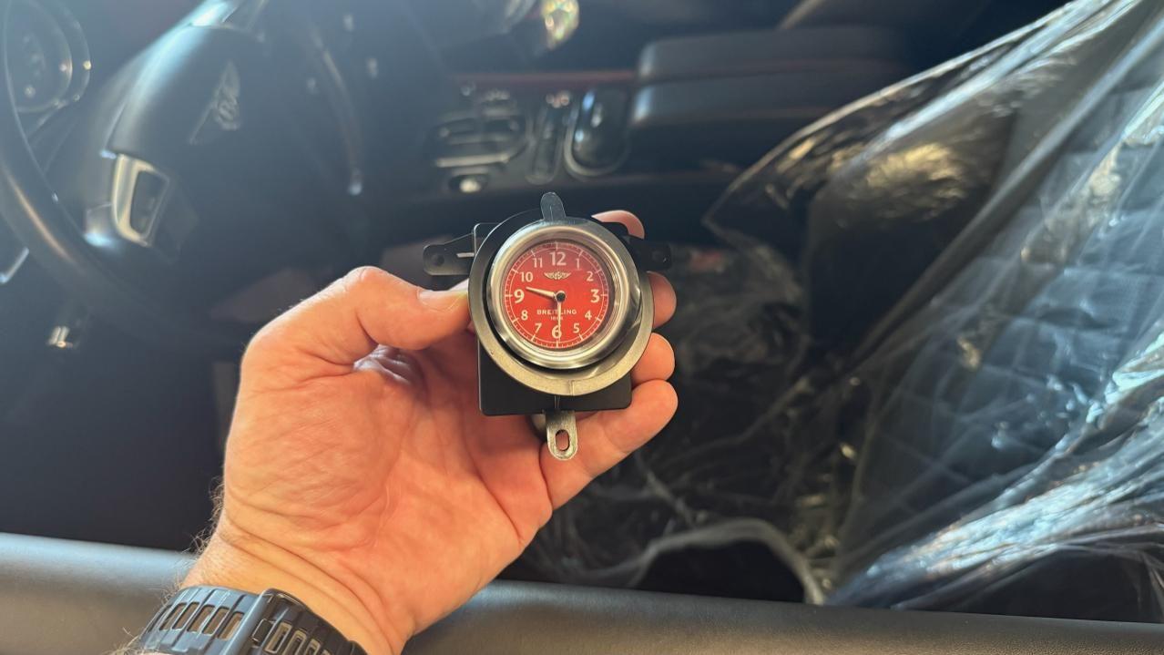

I'm embarrassed to ask, but for the life of me I am unable to sync both my analogue and the digital clocks on my 2017 Continental GTC Speed.
I''ve read the manual mutilple times, viewed all the videos available on the topic and searched this forum without any luck.
The problem is when I adjust the digital clock on the infotainment system the analogy clock changes as well and they're off by 3 hrs. How can I change one without the other being affected or simply put how do I sync both clocks.

Update: It turns out that the previous owner(s) or dealership replaced the original clock on the vehicle with a faulty one. The original analog clock is suppose to be red faced to match my stitching based on the VIN number. This one wasn’t and didn’t work.
Moral of the story: get a warranty or CPO, if something doesn’t seem correct be persistent with the dealership.
P.S. The dealership has ordered a brand new analog clock.
