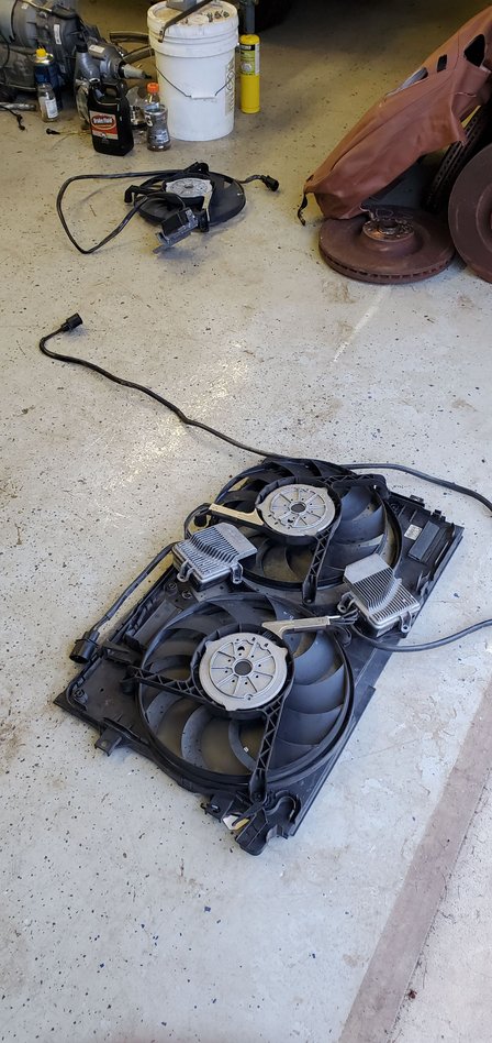

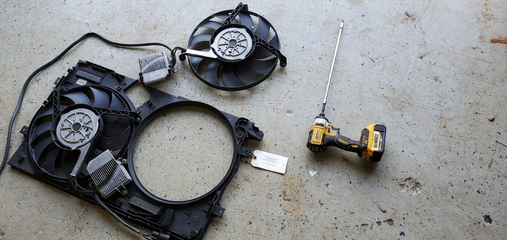

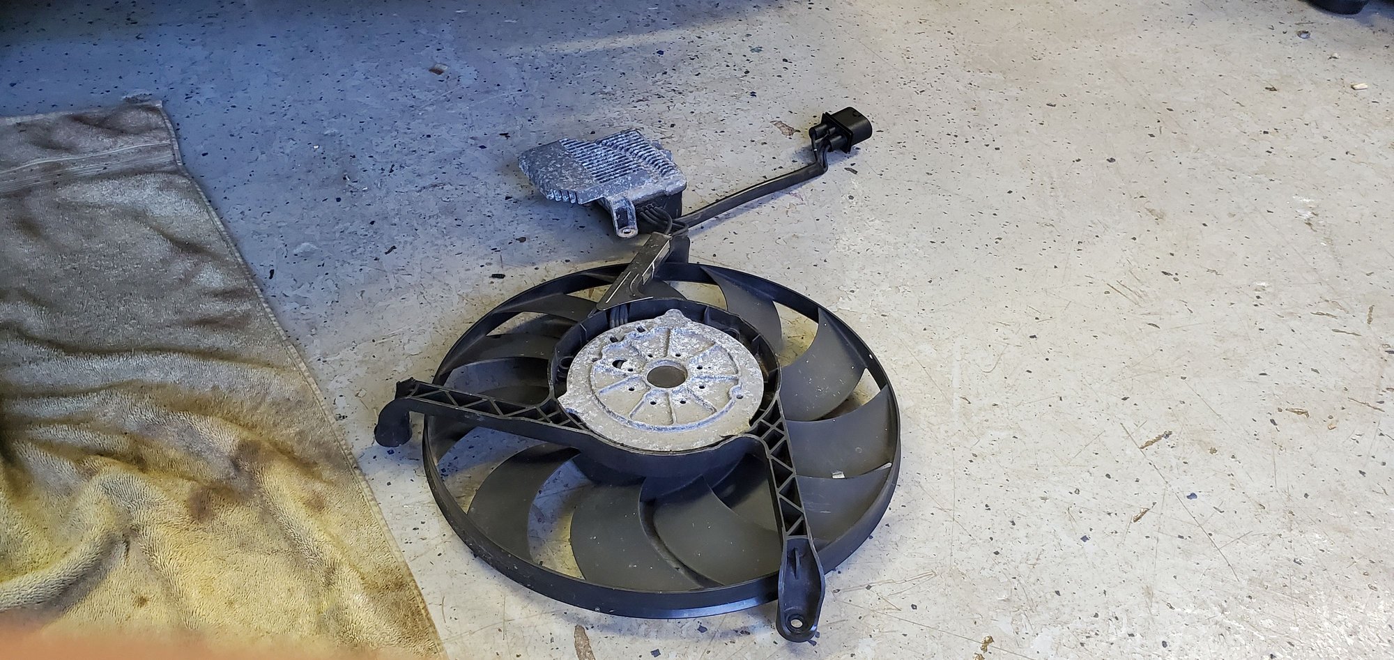

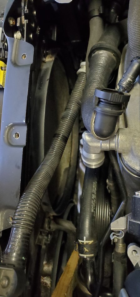

this "Fan number 2 difficulty in movement/blocked." is an error on vcds or what? What is the full scan, pls put it here.
Picture of VAS fault code for fan added to post number #8.
Old Nov 3, 2024 | 09:24 AM
sazam's Avatar
Joined: Jan 2023
Posts: 524
From: float: CH/AT/CZ/PL
Rep Power: 34
sazam has much to be proud ofsazam has much to be proud ofsazam has much to be proud ofsazam has much to be proud ofsazam has much to be proud ofsazam has much to be proud ofsazam has much to be proud ofsazam has much to be proud of

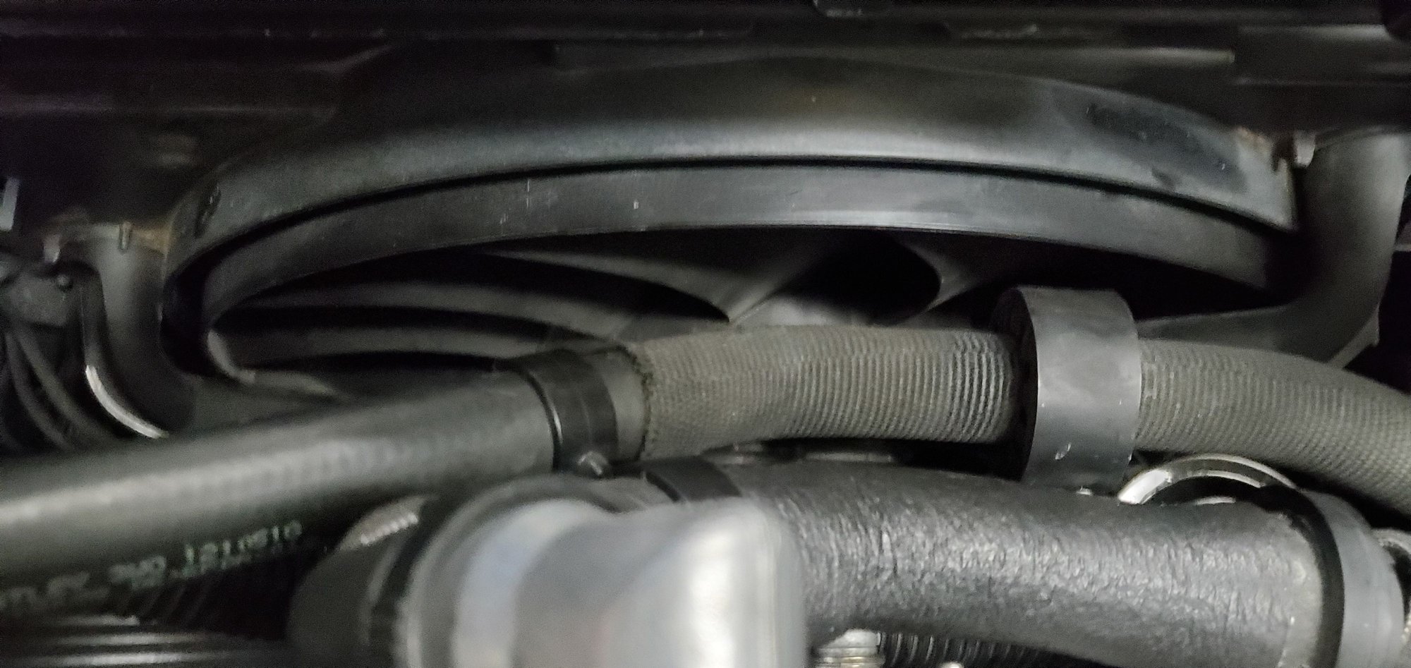

and you confirm that the fan is stuck? tried to move it by hand or smth?
Old Nov 3, 2024 | 09:44 AM
Johnny Hotspur GT's Avatar
Administrator
Joined: Jul 2014
Posts: 3,942
From: Montgomery NJ
Rep Power: 1002
Johnny Hotspur GT Is a GOD !Johnny Hotspur GT Is a GOD !Johnny Hotspur GT Is a GOD !Johnny Hotspur GT Is a GOD !Johnny Hotspur GT Is a GOD !Johnny Hotspur GT Is a GOD !Johnny Hotspur GT Is a GOD !Johnny Hotspur GT Is a GOD !Johnny Hotspur GT Is a GOD !Johnny Hotspur GT Is a GOD !Johnny Hotspur GT Is a GOD !
@Frank ( Sunnyside ) ,
As Sazam stated, verify if either fan is stuck, or, if you feel any resistance difference between the two, as the fault code is showing "difficulty of movement", meaning that it is seeing a higher than normal amperage draw on fan number 2, it could either be worn out and failing, or if sitting for some time, needs a little help to free up, during my rebuild, my original fans were a little tough to turn, I used my power washer on the fan blades to spin them up to very high speed, they spun very freely after that, although one developed a howl as seen in one of my videos.
Johnny
Johnny

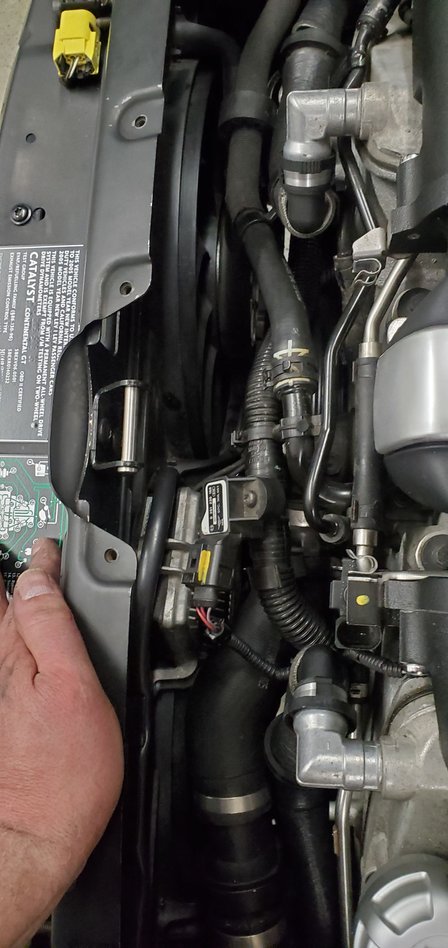

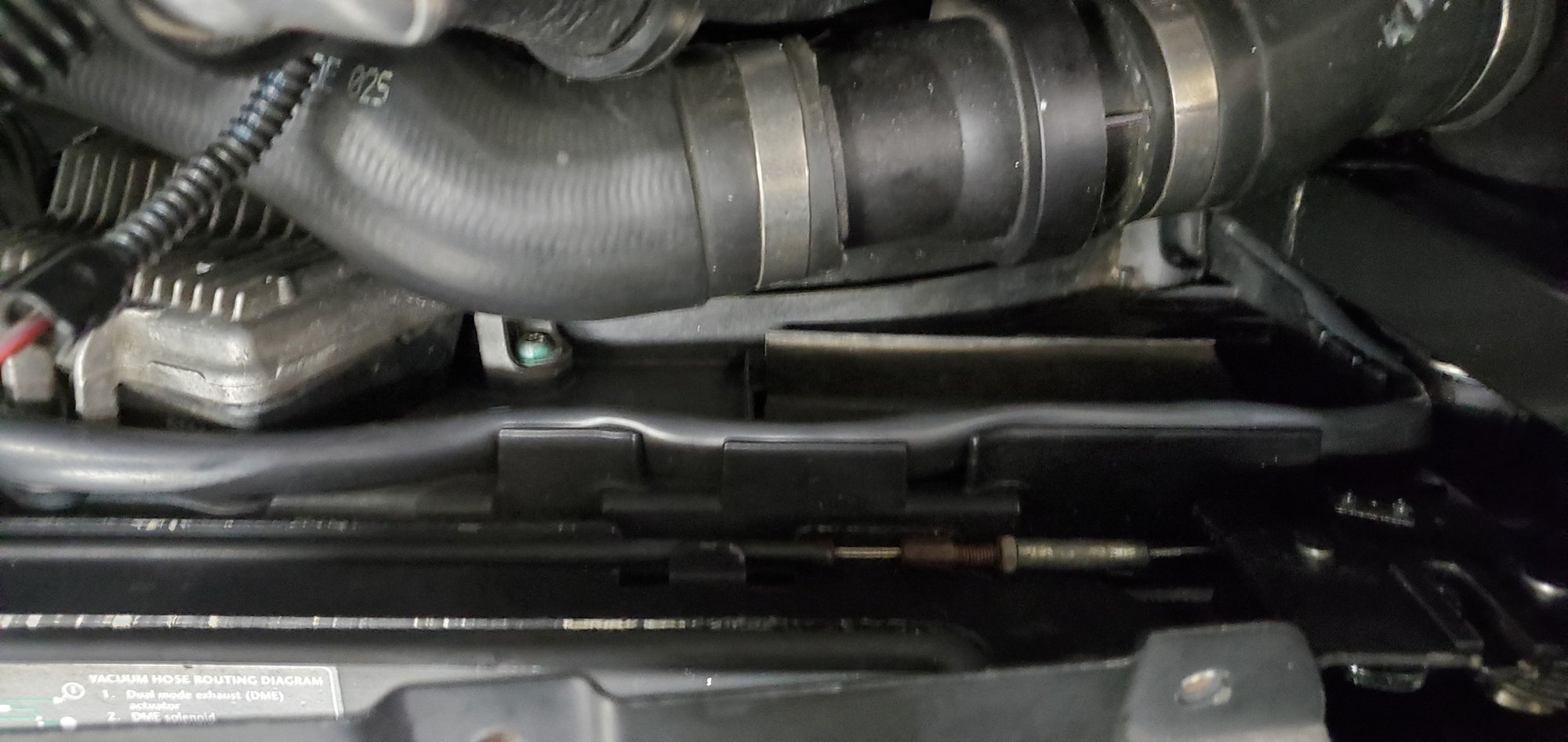

Can the fans be easily accessed without removing the cooling pack?
Old Nov 3, 2024 | 04:23 PM
Administrator
Joined: Jul 2014
Posts: 3,942
From: Montgomery NJ
Rep Power: 1002
Yes, with a few swear 🤬 words, and some cut up hands...
I did mine after the vehicle was completely back together.
Johnny
