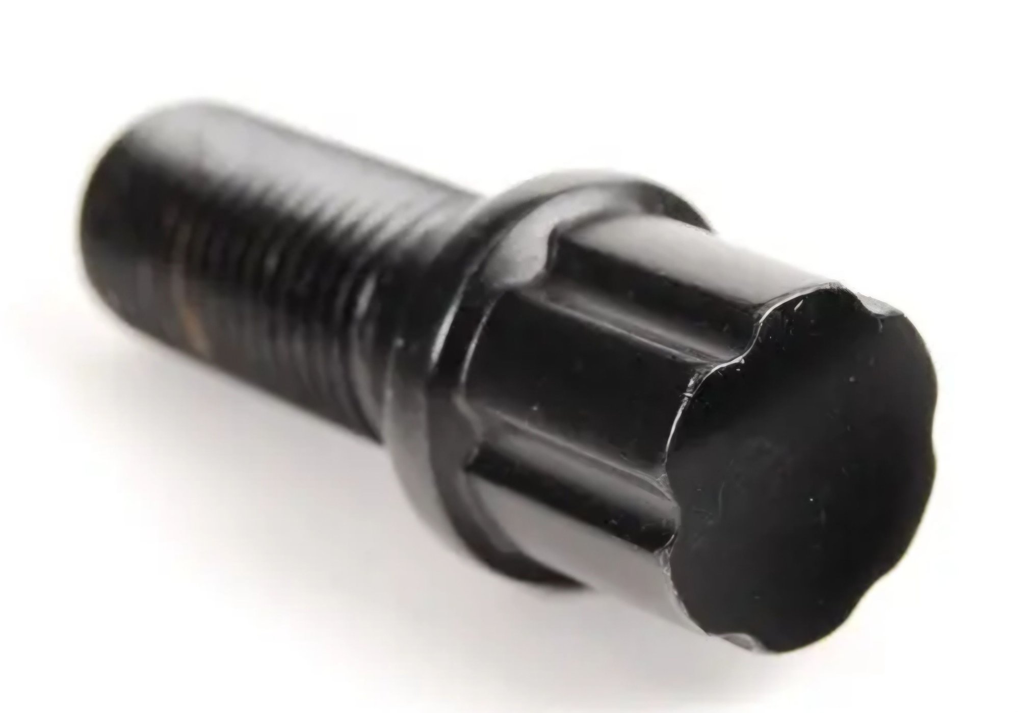

UPDATE PARKING BRAKE FAULURE.
So I have now got round to taking the left rear caliper off to find the parking brake motor cracked and full of crud and muck.
Problem I have is that I didn't get the wheel locking nut with the car. I managed to hammer on my other gt speeds locking nut and thankfully removed the wheel nut. In doing so I ruined my GT Speed locking nut. So I now have no way of getting the wheels off my Speed and the remaining wheels of mt Time Attack car.
Does any one have any ideas please.

Hello @Frank ( Sunnyside ) ,
If you have the multi point locks as shown below, you can purchase the complete kit, 50 - 60 usd depending on where you look, if you have a different style lock ( like my A8L W12 does) let us know, post a picture of it.

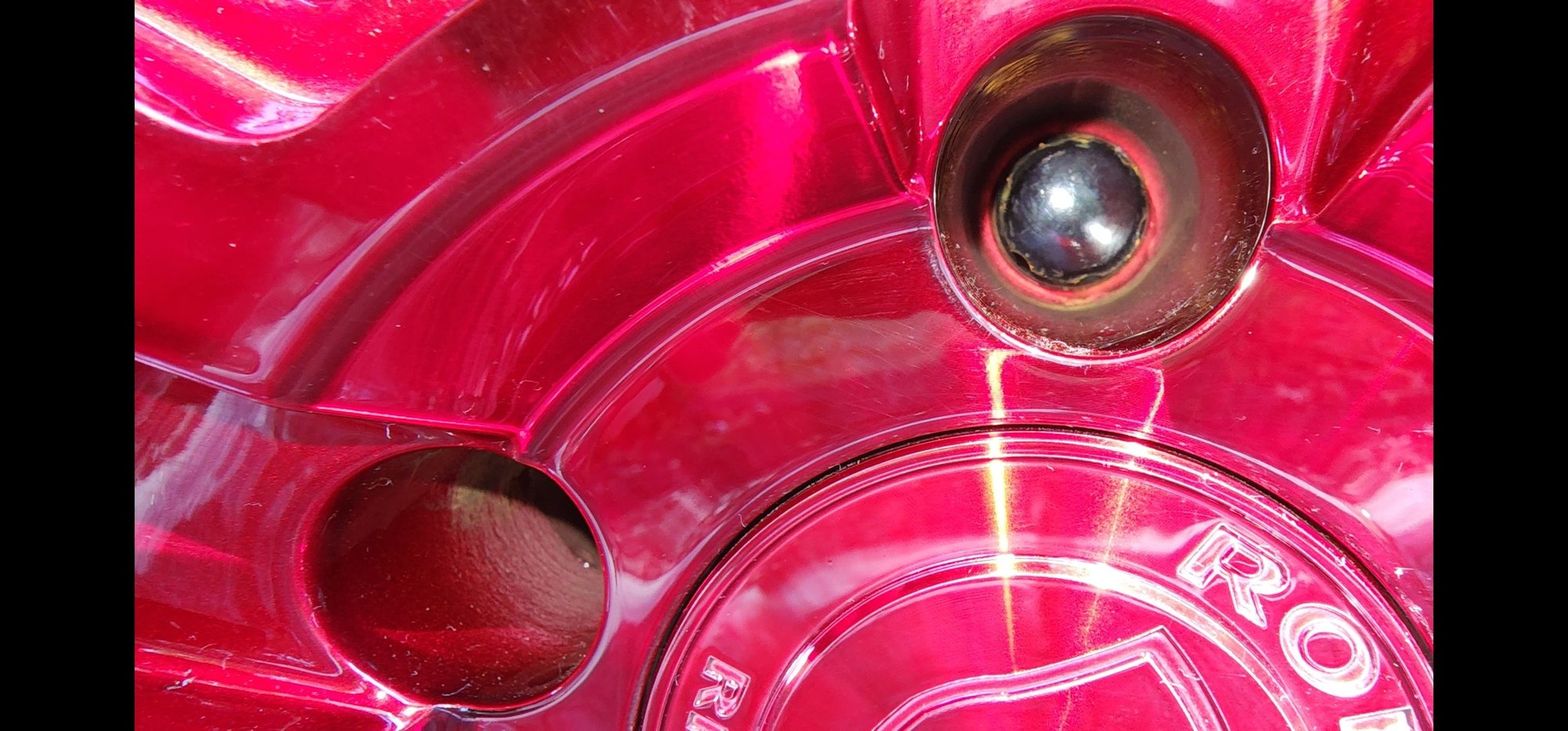

Here are the locks that my Audi has, the only reason I mentioned this type of locks is, I believe someone else here had the type my Audi has on their Bentley, but as I type this, I may be confusing the gentleman over at AW that put Bentley wheels on his A8L with the Audi locks, but I am not sure at the moment, sorry for any confusion.
My Rohana Wheels use a totally different lug bolt with a special socket for same, if you go this route in the future, and you put the special socket and a breaker bar with extension in a tool bag in the boot, just remember to never forget to put it back after you take the tool bag out of the boot while cleaning, or for other purposes, makes it really fun to call family to bring you the socket as you are stuck with a flat...
As far as the parking brake motors, yes, I believe that they are the same as the D3 A8, as there are posts here by @Dark Green and @John Fiammetta discussing same, and iirc, DG says that he used the A8 motors on his GT.
Johnny
Edit: Not sure what is happening to loading the pictures, I loaded 7 pictures with a description of each picture as allowed in the comment box, but they just came out as code, trying again without the comment box use...
Audi VW VAG TYPE.
Audi VW VAG TYPE..
Audi VW VAG TYPE.
My Rohana Wheels type.
Aftermarket type for my Rohana Wheels.
Special socket for aftermarket Rohana Wheels.
