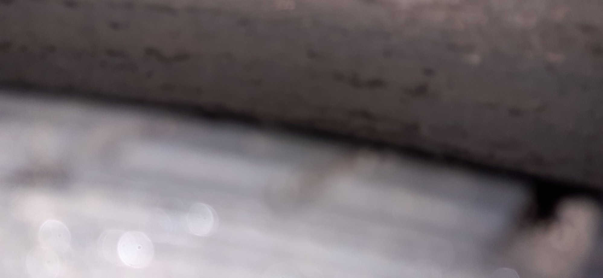

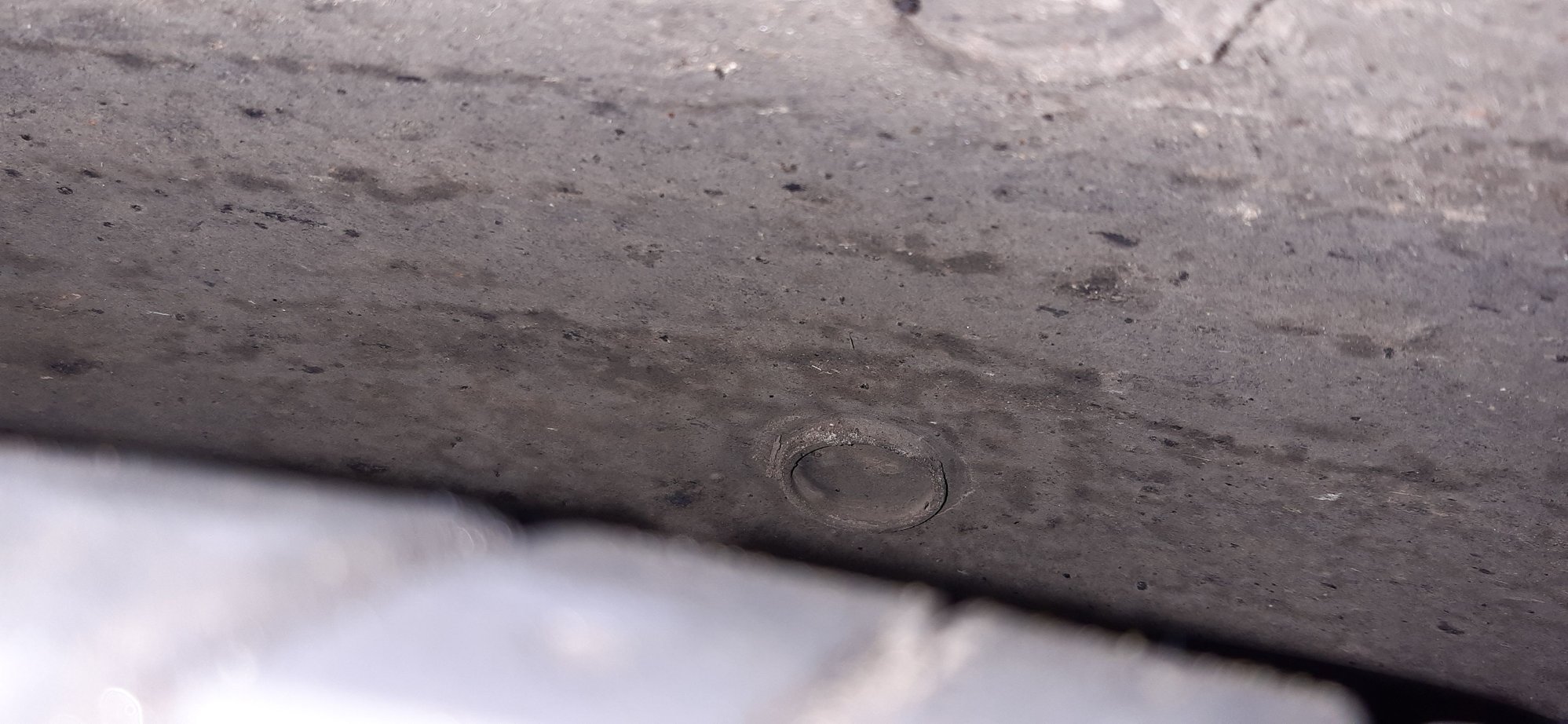

AIR SUSPENSION.
This is how low the car sits with the air bags holding air on there own with no help from the system. The minimum pressure is kept by the little valves on the bags. This keeps enough pressure to allow driving of the car.
If a bag bursts then that suspension unit / corner will fully drop on its bump stops.
I have added a picture of the gap between the top of the tyre and arch lining.
Min gap tyre top to arch liner
Wheel gap
Wheel gap

Hello @Frank ( Sunnyside ) ,
I see that you have the vehicle on wooden blocks at the rear, and the yellow ramps at the front to gain access for lifting with a floor jack, if all was fine before the flat house battery, then I wouldn't jump right to the suspension control module, so, please try jacking the body of the vehicle up about an 1/2 of an inch at a time, meaning, a floor jack on each side, lifting both sides somewhat evenly, you want to have the vehicle just below normal height, as too far down turns the system off, and just a bit too high past normal, will want to release air, you should also try with Ross-Tech VCDS to put the suspension control system through it's "Output Tests", which should aid in getting the system to react.
Johnny
Old Nov 2, 2024 | 06:05 PM
Frank ( Sunnyside )'s Avatar
Joined: May 2010
Posts: 1,674
From: Scotland
Rep Power: 106
Frank ( Sunnyside ) has a reputation beyond reputeFrank ( Sunnyside ) has a reputation beyond reputeFrank ( Sunnyside ) has a reputation beyond reputeFrank ( Sunnyside ) has a reputation beyond reputeFrank ( Sunnyside ) has a reputation beyond reputeFrank ( Sunnyside ) has a reputation beyond reputeFrank ( Sunnyside ) has a reputation beyond reputeFrank ( Sunnyside ) has a reputation beyond reputeFrank ( Sunnyside ) has a reputation beyond reputeFrank ( Sunnyside ) has a reputation beyond reputeFrank ( Sunnyside ) has a reputation beyond repute
Johnny
Thanks Johnny.
Then that's what I'm going to do. I only have 2 trolly Jack's so will try and use 2 bottle jack in conjunction.
Each and every time a fault is repaired I will make an update. Right up to my first race When ever that is in the future?
Thanks for the advice....as always 🙂
