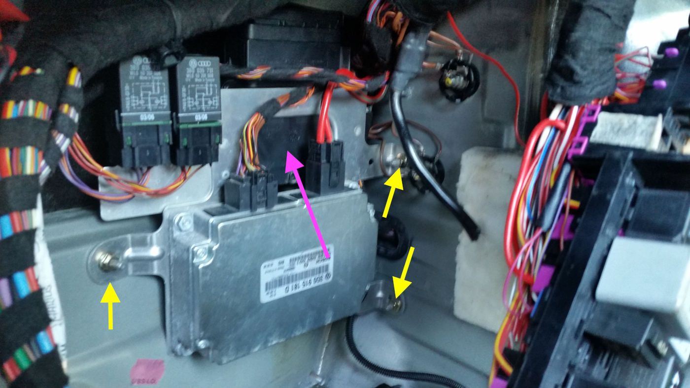

Ecu
Originally Posted by Johnny Hotspur GT
Hello @Frank ( Sunnyside ) ,
To release the connector, you pull the handle to slide it out, then lift it off.
Johnny
Where exactly is the ecu? I removed battery but can not find?
Old Jan 20, 2026 | 08:55 AM
jeyjey's Avatar
Joined: Jan 2026
Posts: 81
From: Ireland
jeyjey
Marked in magenta. It's on the back side of the plate, so you'll need to remove it (marked in yellow).
Thank you.. 👍 Super helpful
