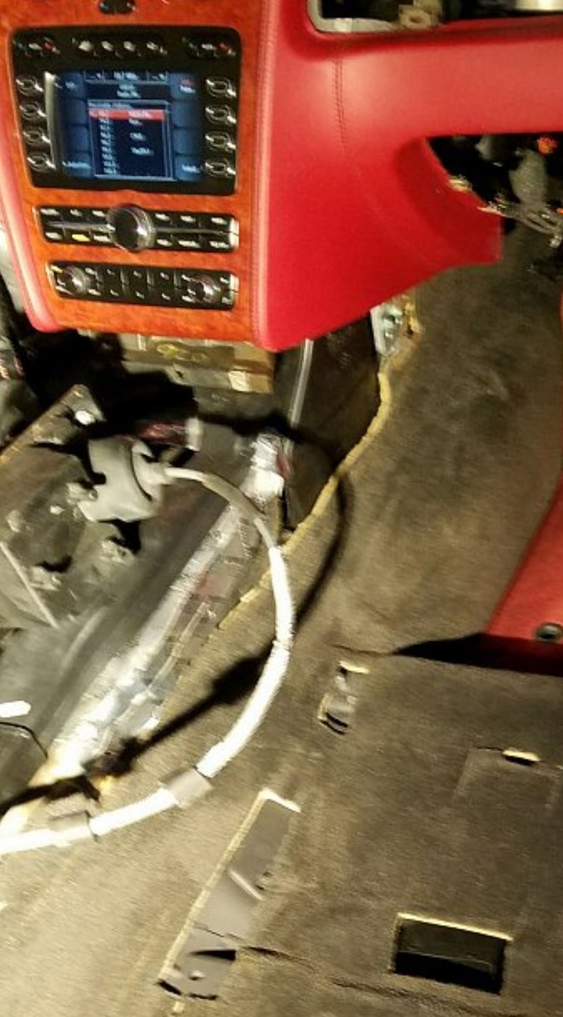

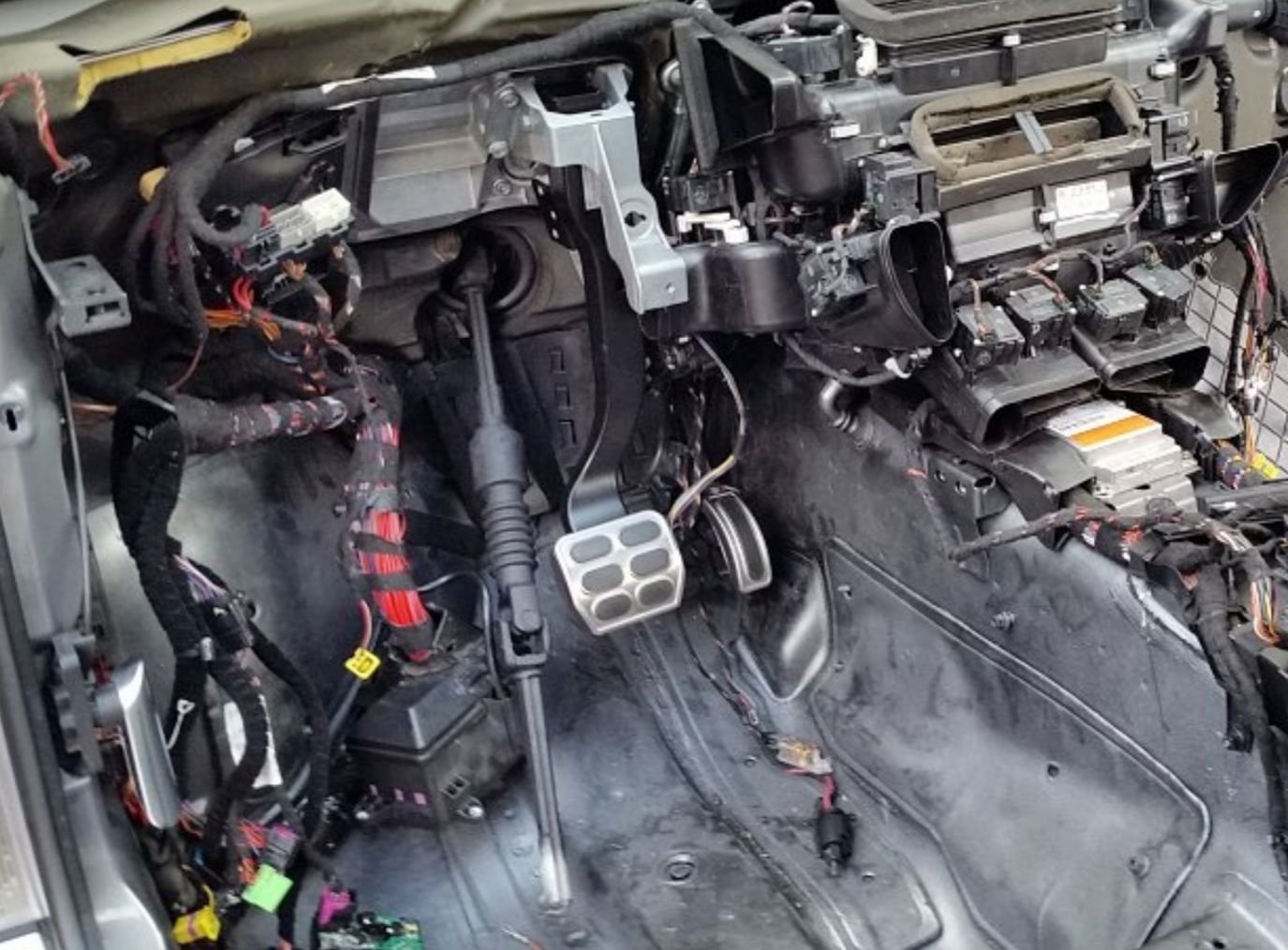

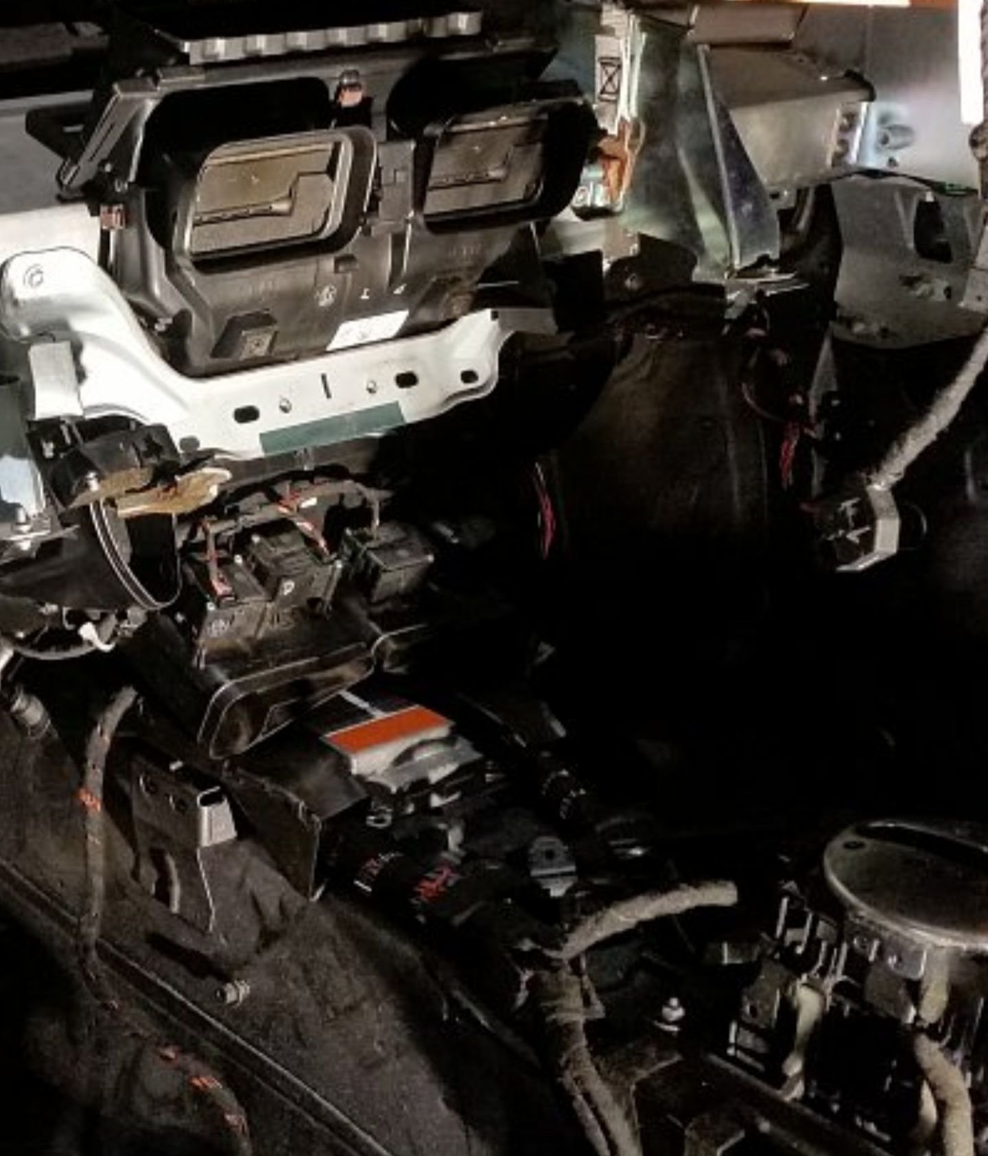

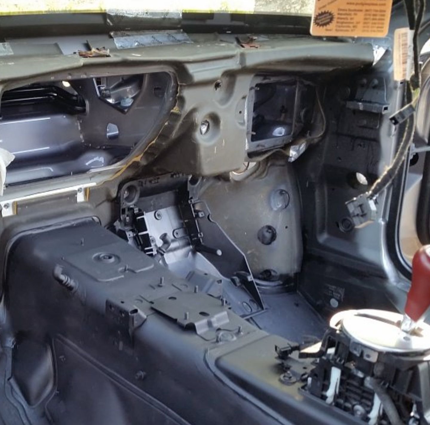

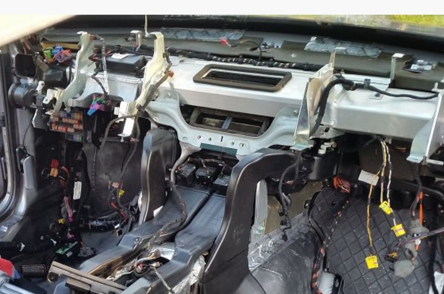

If you do have to remove it, I would start at popping out the rear seats, they are very simple 10 minute job, then the rear console wood trim pulled upwards from the rear and out, next the front center console wood trim, then the front center armrests, I would not remove the front seats just yet, next remove the rear console, you have to split it from the front console by turning the locking screws on the inner sides were they join together, the a few more pieces to get the front console out, then pull the HVAC ducts running to the rear out by pulling reward, then see if you somehow can get at the module, I would NOT pull the dashboard completely out or at all, I because of the year of vehicle, would cut a portion of the plastic dash out in the area of said module to access the mounting nuts.
Here are some pictures and the link to my rebuild.
