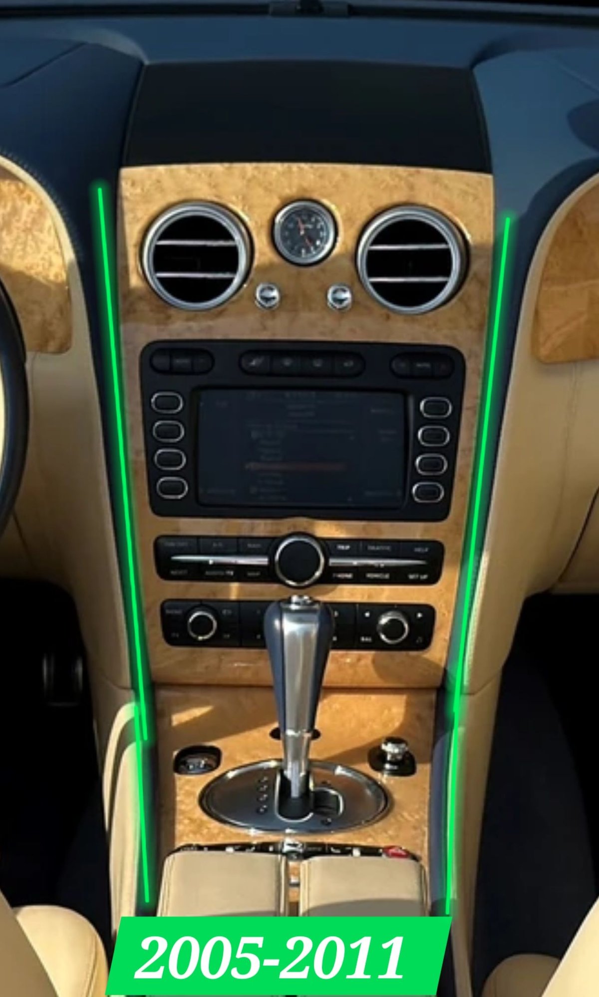

As to this unit fitting the 2004 2011 GT or FS, I think not, and I contacted the ebay seller to inquire about it fitting the 1st GEN GT/FS, I even sent them pictures of my vehicle, they "Sunny" came back with after reviewing my pictures that all is good, and "go ahead and buy now", which I didn't, see my pictures below for my understanding, as the 1st GEN vehicles have the dash lines inline with the center console, and the woodgrain trim around the Infotainment head unit goes all the way down to meet the woodgrain trim of the console, whereas the second GEN has the sides of the center of the dash coming down into the insides of the center console, and the Infotainment unit on the 2nd GEN does not go all the way down to the console, nor does it's woodgrain trim, therefore having a pocket with a rubber padding, whereas the 1st GEN would be left with a hole of unfinished plastic framing of the dashboard structure, I also believe that because the 2nd GEN center of the dash goes to the insides of the console, that the Infotainment head unit trim may be narrower left to right, therefore leaving a gap on a first GEN, but someone with a 2013 may measure that for us, or even your 2016 so that we can compare the measurements of width.

Yes, there are 2 different styles. Most sellers will only have 1 option, There is a Gen 1 version and a Gen 2 version, so they will fit the early models, They do not market this very well but they did design 2 different models for the Gen 1 and the Gen 2. There is a site that has both available.

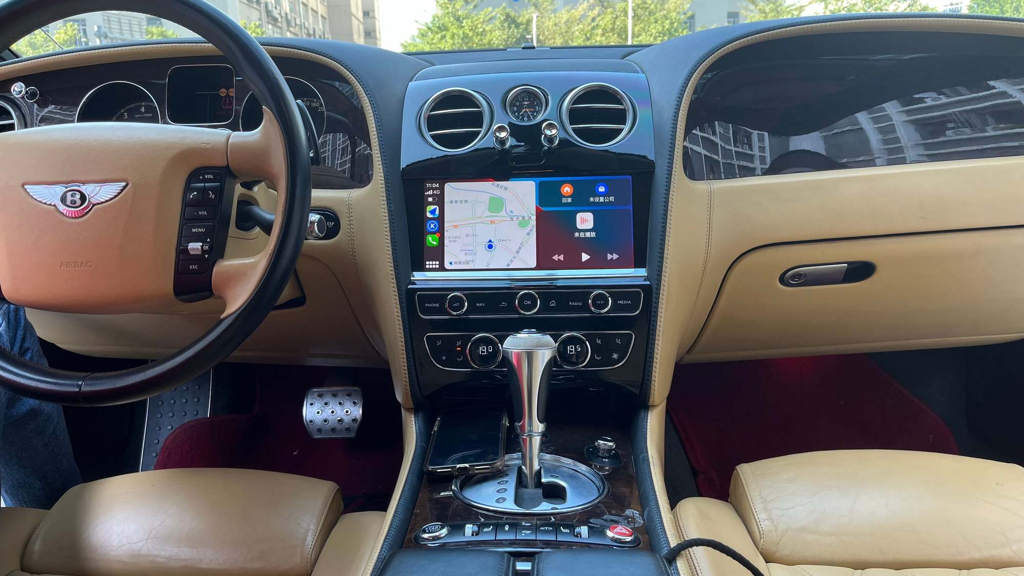

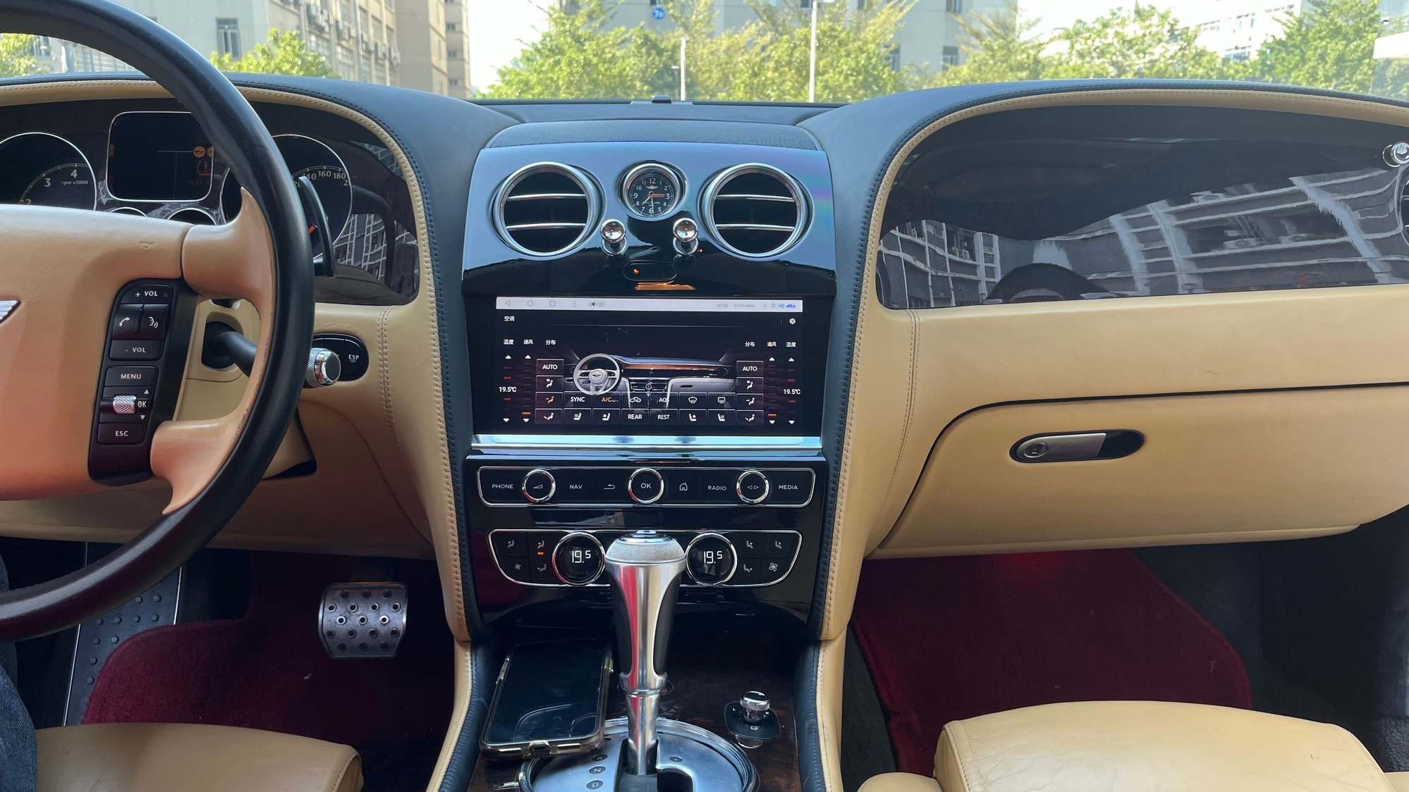

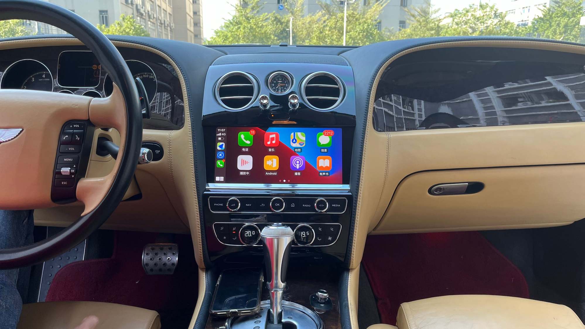

Good afternoon, a while ago I installed a carplay on the original radio that came with the car, there is a thread that was opened a long time ago with a video that was posted on YouTube by whoever installed it for me.
I have to say that I like stock cars without modifications and I opted for this option. But what made me take this option the most was that at the end of the day the original Bentley radio should be the most reliable for the car since if it fails we lose control of many parameters of the car as we already know.
The most negative point of all this is that the screen is not touch screen and the resolution is what we already know but it is totally reliable or at least it is reliable for me since I don't know if it has been installed for two years.

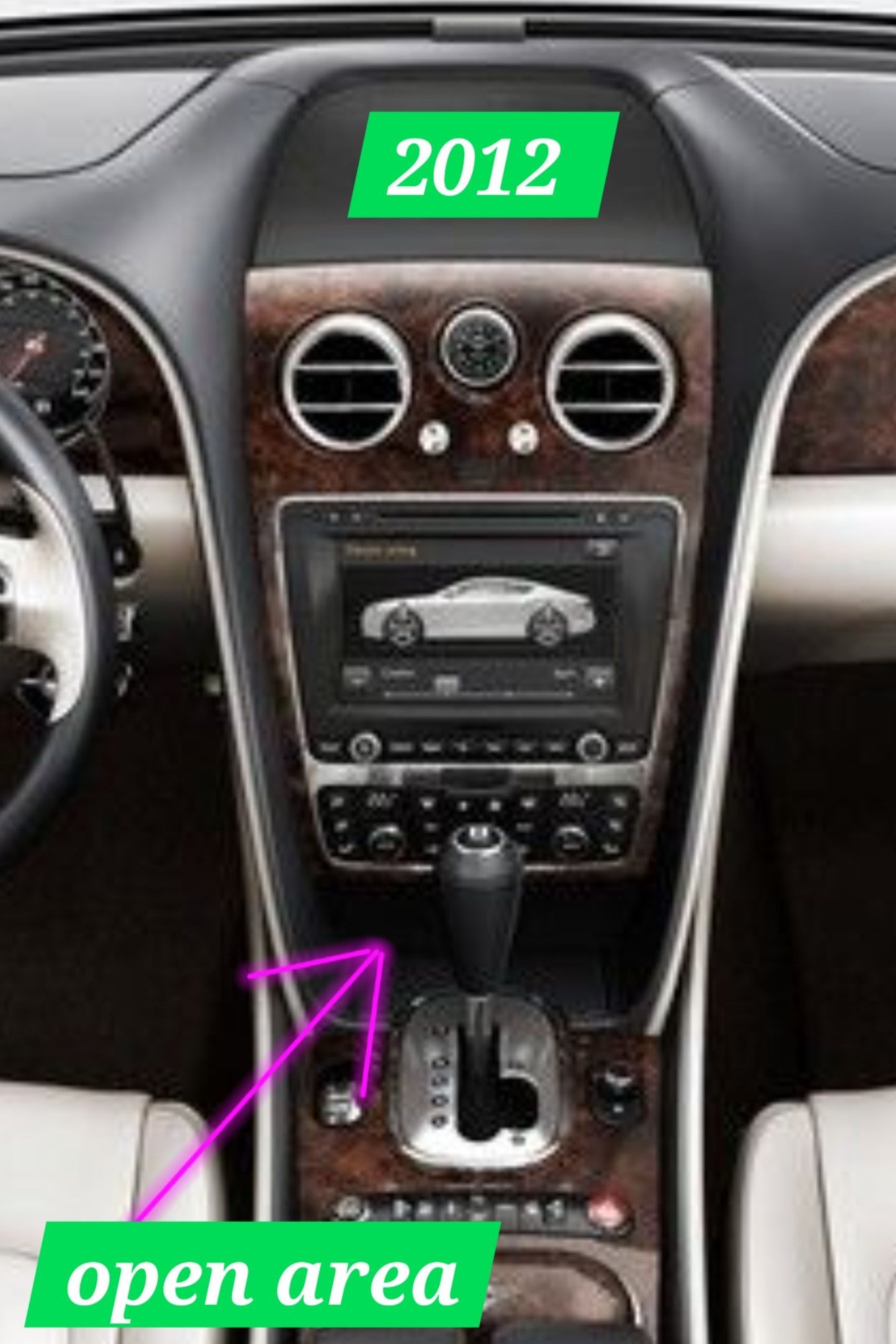

Here is the 05-11 design.
