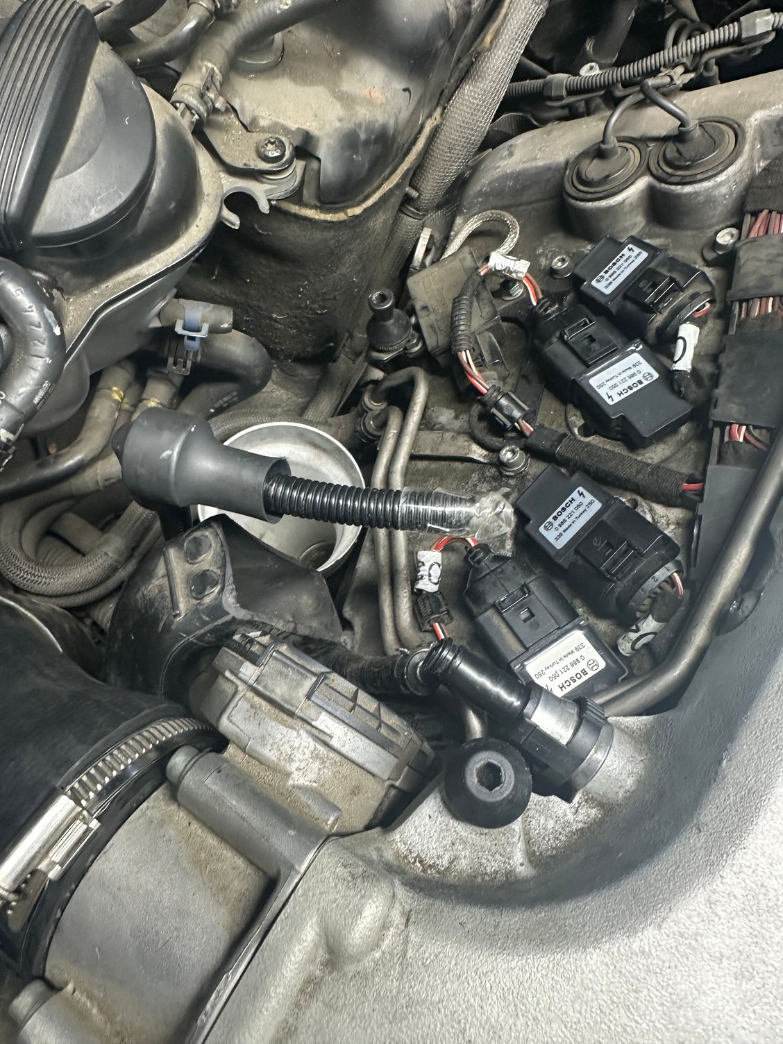

Hi,
while changing my spark plugs yesterday I broke this hose it was plastic. Does anyone know the name of it and where I can buy it a new one? Would taping it together cause any issues? See images below

Originally Posted by wsuhottboi
anyone?
That's the crankcase vent hose. Get some 3/8 0il cooler hose at a car parts store. Cut to length and push on the barbs on each end. These lines manage alot of vacume.

This worked! Thank you for the advice!
