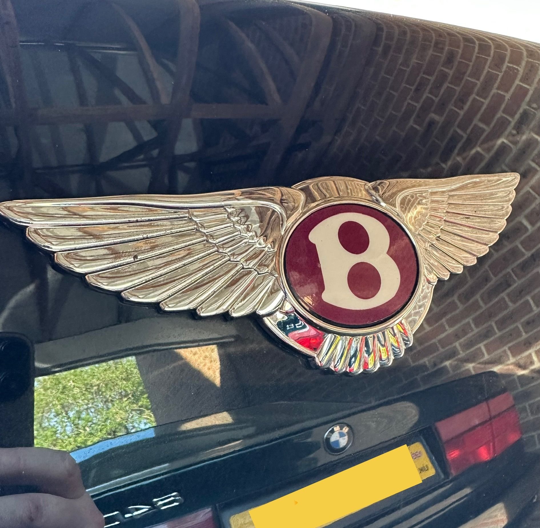

They look like complete badges which will probably stick on with double sided tape. I just bought vinyl stickers to stick over my black badges - there was nothing wrong with the originals, they weren’t faded or damaged, I just fancied the dark red.
I think they look ok for £14.

Dan did you just apply the sticker overtop of the faded B? Where did you get that sticker?

I purchased mine from Flying Spares and they were perfect front and rear. They were a heavy duty sticker possibly with a metal backing for the front. It made it look brand new.
I carefully peeled off the original using a razor blade if I recall correctly and put on the new one
