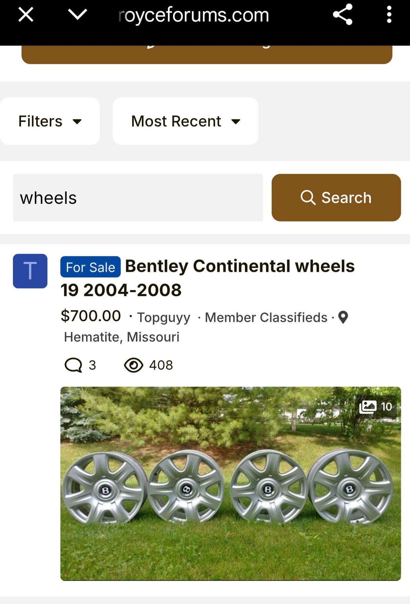

To All,
Please do not interact with @Roberto88 ,
He is a scammer, he is not in California as he listed in his profile, he is in Cameroon, Douala, Africa., I have corrected said location.
He has 9 items listed for sale in our Marketplace, therefore, if he has contacted any of your via PM, Visitor message, or the like, please ignore.
All of the 9 items he listed, are actually listings by others back to 2019, copied from various sites, so please do not fall for his fake Bentley wheels listing, or any others at all, I am deleting all listings now.
The real listing below.
Johnny

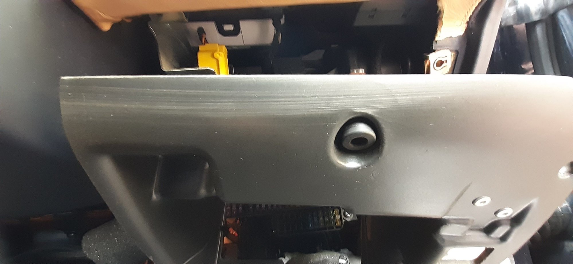

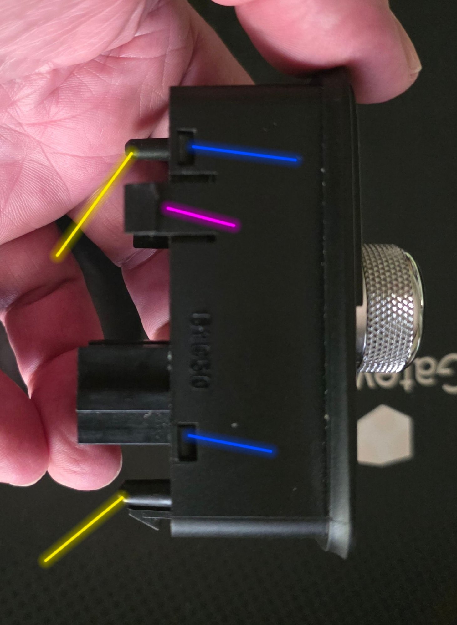

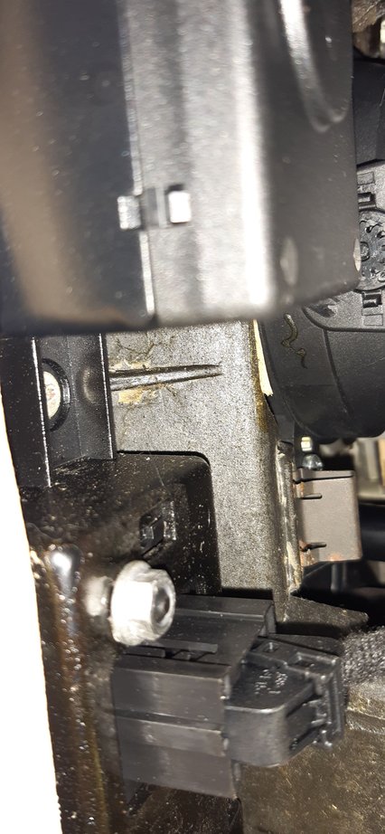

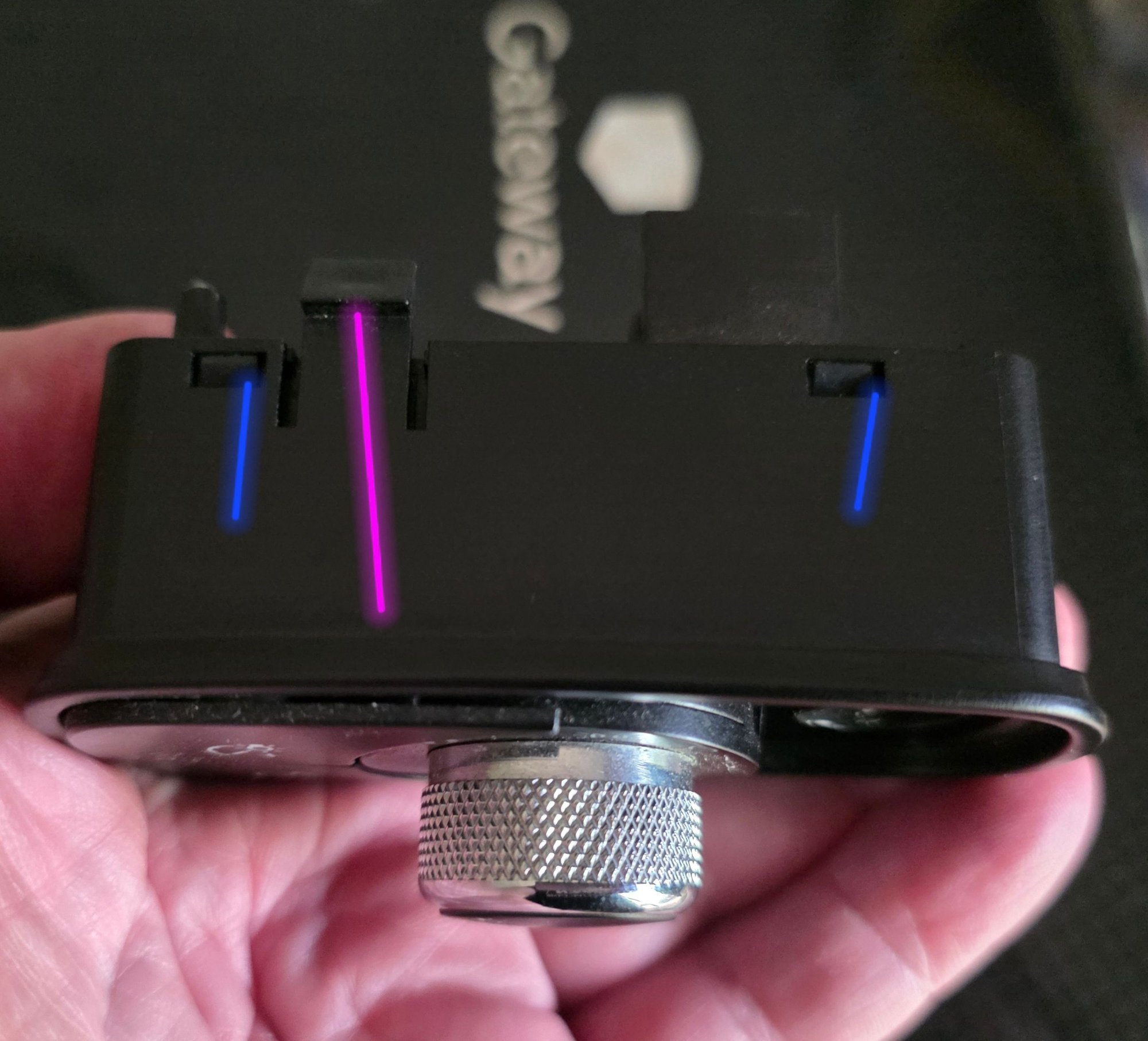

Update
Hi Guys,
Well the Rob guy was partially correct on this one.
you cant just pries out the switch. you have to drop the lower knee roll /fuse box cover and frame ( about 6 hex screws) then undo 2x m6 nuts to free the switch. prising out just removes the switch facia with the **** attached. The switch is still bolted into the dash.
Pics below.

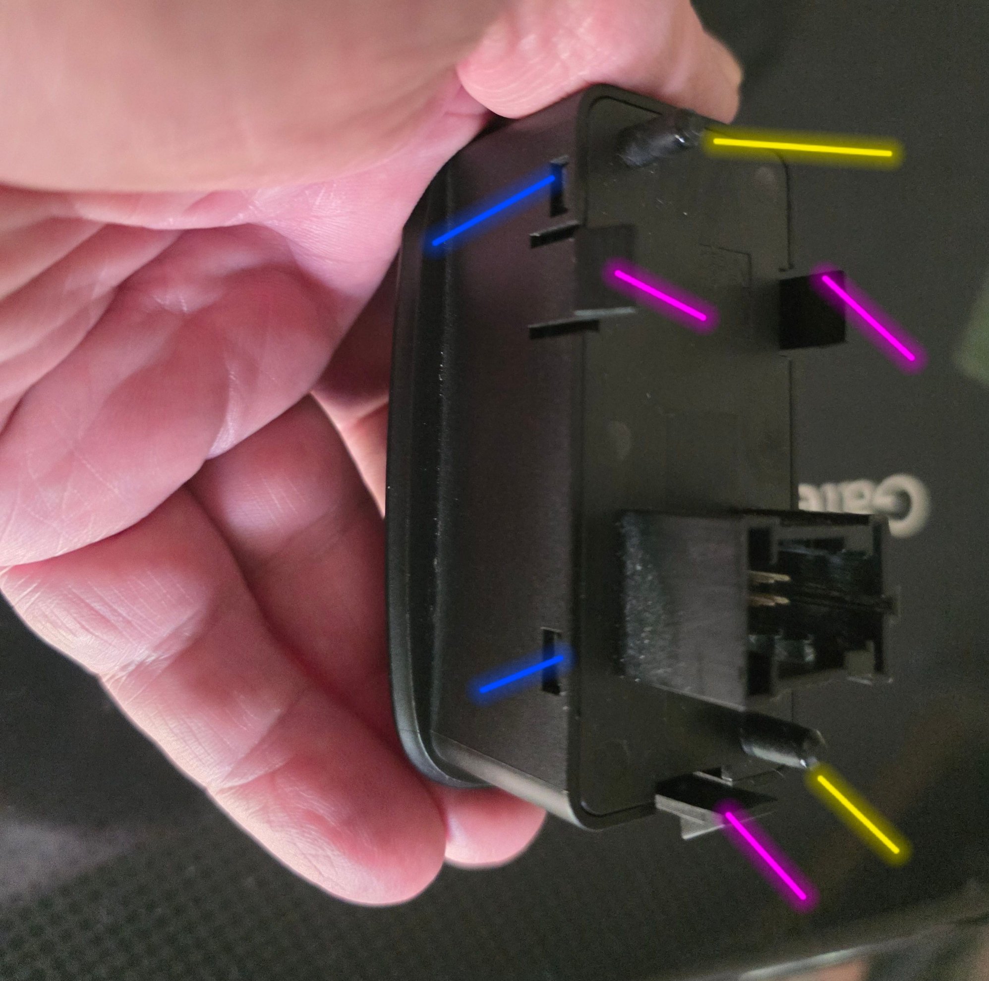

Old May 12, 2025 | 08:34 PM
Johnny Hotspur GT's Avatar
Administrator
Joined: Jul 2014
Posts: 3,956
From: Montgomery NJ
Rep Power: 1002
Johnny Hotspur GT Is a GOD !Johnny Hotspur GT Is a GOD !Johnny Hotspur GT Is a GOD !Johnny Hotspur GT Is a GOD !Johnny Hotspur GT Is a GOD !Johnny Hotspur GT Is a GOD !Johnny Hotspur GT Is a GOD !Johnny Hotspur GT Is a GOD !Johnny Hotspur GT Is a GOD !Johnny Hotspur GT Is a GOD !Johnny Hotspur GT Is a GOD !
@Frank ( Sunnyside ) ,
Well that's odd, I guess someone forgot to install the nuts on both my 05, and the parts GT, as you can see marked by yellow, the studs have no nut thread marks on them, my switch is just pressed in.
Johnny

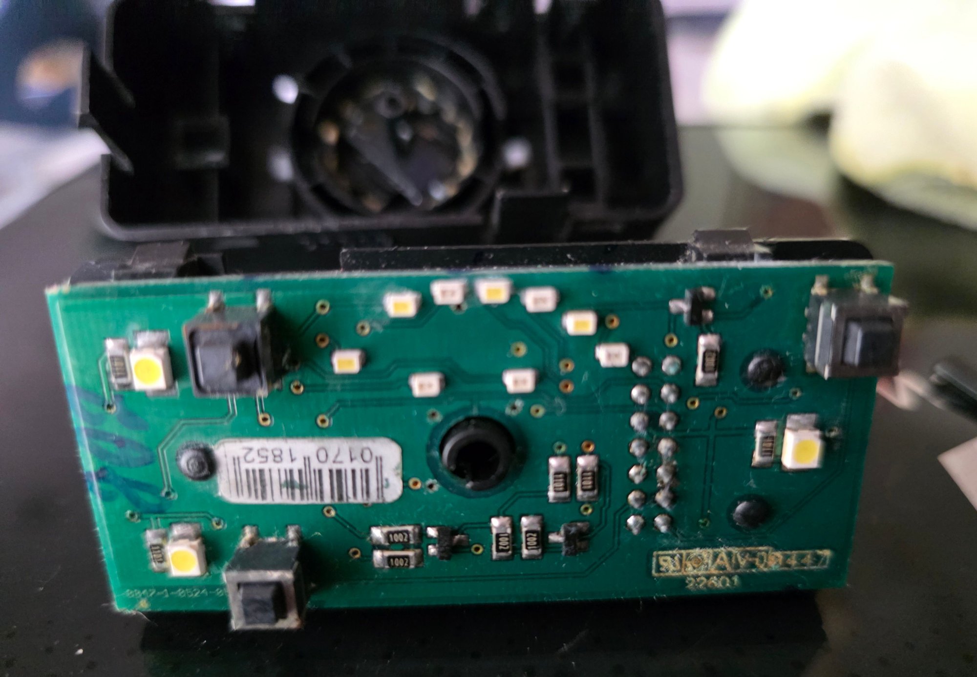

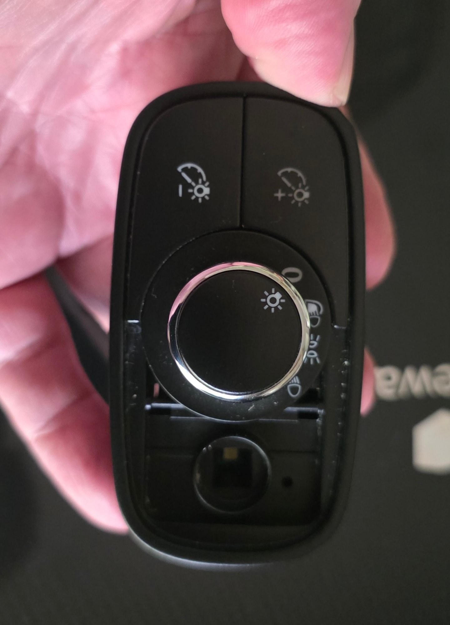

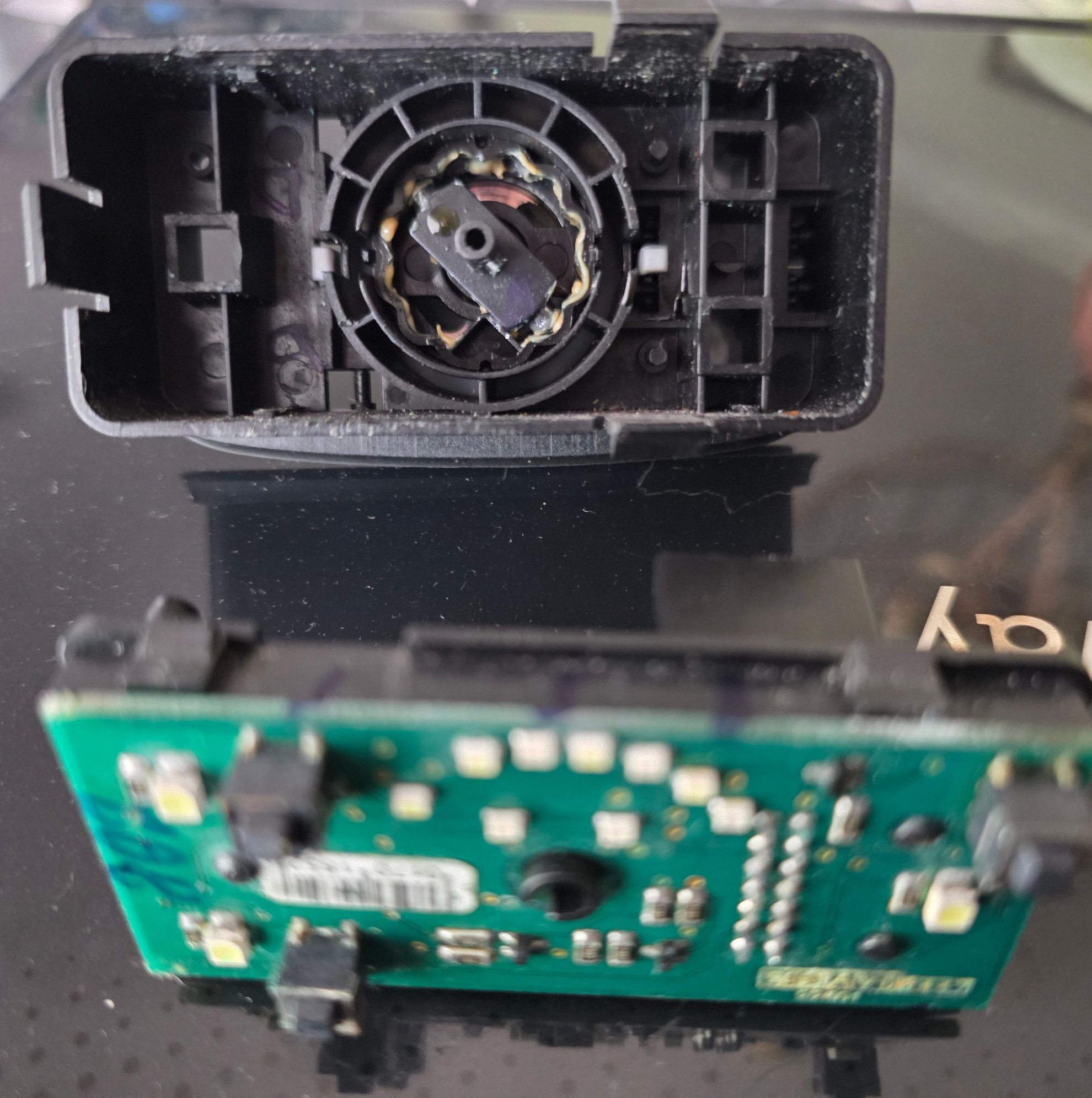

so looking inside this switch, what is causing the "connection" issues, that you need to waggle a little bit to make the contact? Is it fixable?
Old May 13, 2025 | 12:35 AM
Frank ( Sunnyside )'s Avatar
Joined: May 2010
Posts: 1,675
From: Scotland
Rep Power: 107
Frank ( Sunnyside ) has a reputation beyond reputeFrank ( Sunnyside ) has a reputation beyond reputeFrank ( Sunnyside ) has a reputation beyond reputeFrank ( Sunnyside ) has a reputation beyond reputeFrank ( Sunnyside ) has a reputation beyond reputeFrank ( Sunnyside ) has a reputation beyond reputeFrank ( Sunnyside ) has a reputation beyond reputeFrank ( Sunnyside ) has a reputation beyond reputeFrank ( Sunnyside ) has a reputation beyond reputeFrank ( Sunnyside ) has a reputation beyond reputeFrank ( Sunnyside ) has a reputation beyond repute
It's now fixed.....A used item my mate gave me lol..
I will however take a close look at the defective item.
​​​ite.Thanks
Frank
