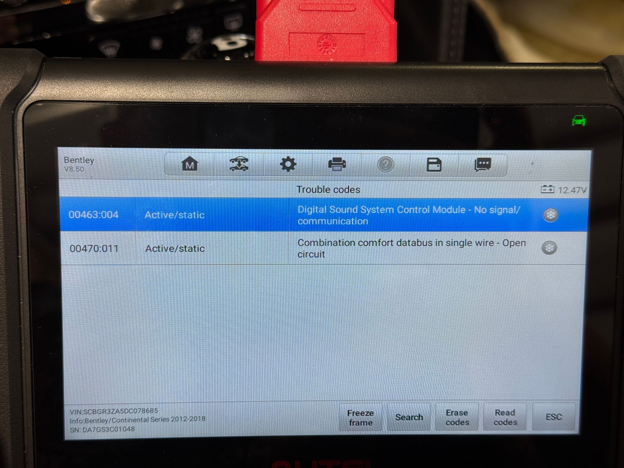

Hey guys, another GTC owner here. Charged battery on sunday and bricked the rig. It spins starter but won’t fire up. If you do hard reset: it may start for 3-5 seconds and dies.
What have been done:
- Checked ECM1/2 and all under hood wiring for corrosion and reseat it all; trunk wiring and BCM wiring under glove box.

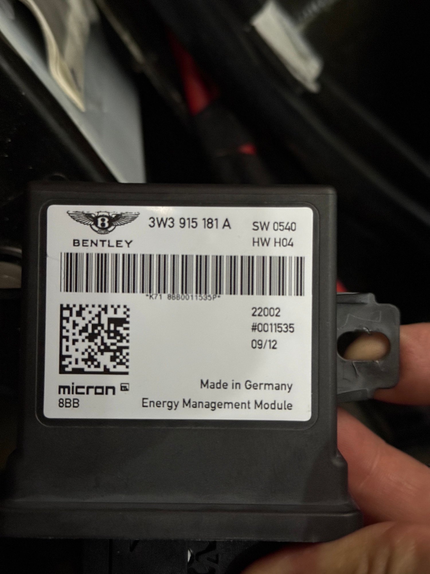

- Changed Aux battery with new one, constantly running 12.7v +. Couldn’t program/register the battery (feature not supported?!), but new battery gives exactly same issues.
- Checked fuses. Ground lines.
- Changed relay 53 (since it was the only after market one.
Same symptoms. Same codes. About to give up and need an advice. Would not mind to compensate for professional help.

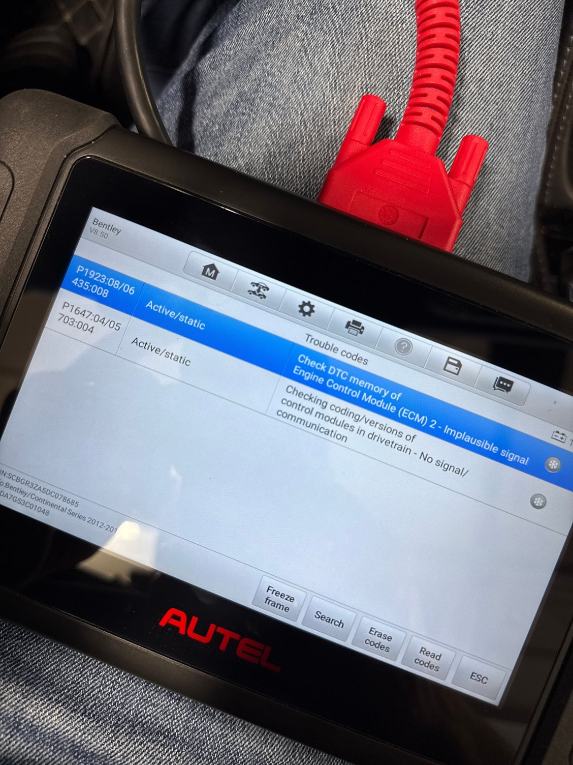

As to your issue, please give us some detailed information as to the status of the vehicle before this occurred.
Was the vehicle in any collision, or any damage of any kind ?
Have any repairs or replacement of the airbags, airbag module, ABS braking system module, steering column module, or either engine ECU'S taken place ?
Do you have Ross-Tech VCDS instead of the Autel ?
Have you read the fault codes of engine ecu number 2 as per P1923 instruction ?
I take it that P1647 is from engine ecu number 1, if not, where is it from ?
A full scan would be of great help, as other individual modules can cause this P1647 code, a Ross-Tech scan or ODIS VAS 5054 would be great, as they give detailed in depth reading, whereas, I am not so sure with the Autel, if the Autel has a full scan readout, please post it here.

"Have you read the fault codes of engine ecu number 2 as per P1923 instruction ?"
If it's some sorta specific task - then no, But when I read all codes, ECM2 shows same error - implausible signal.
"I take it that P1647 is from engine ecu number 1, if not, where is it from ?"
Yes

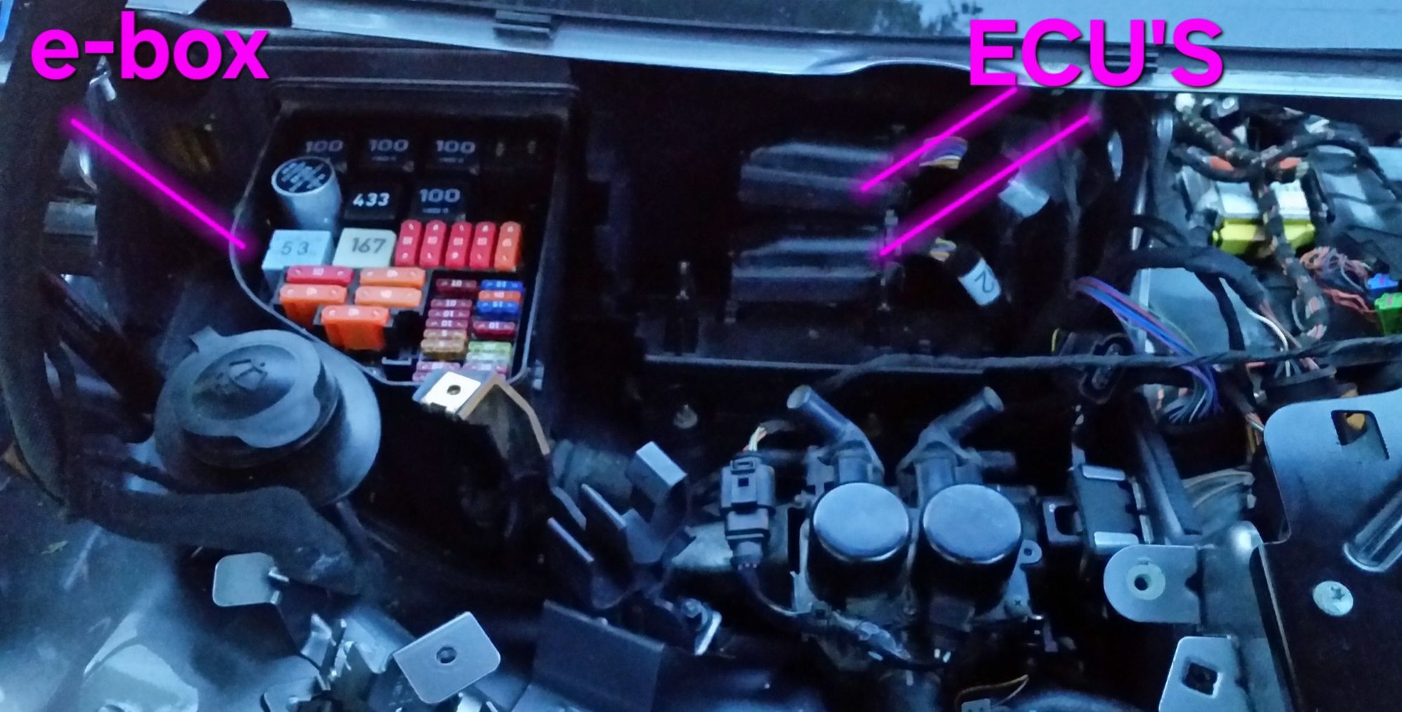

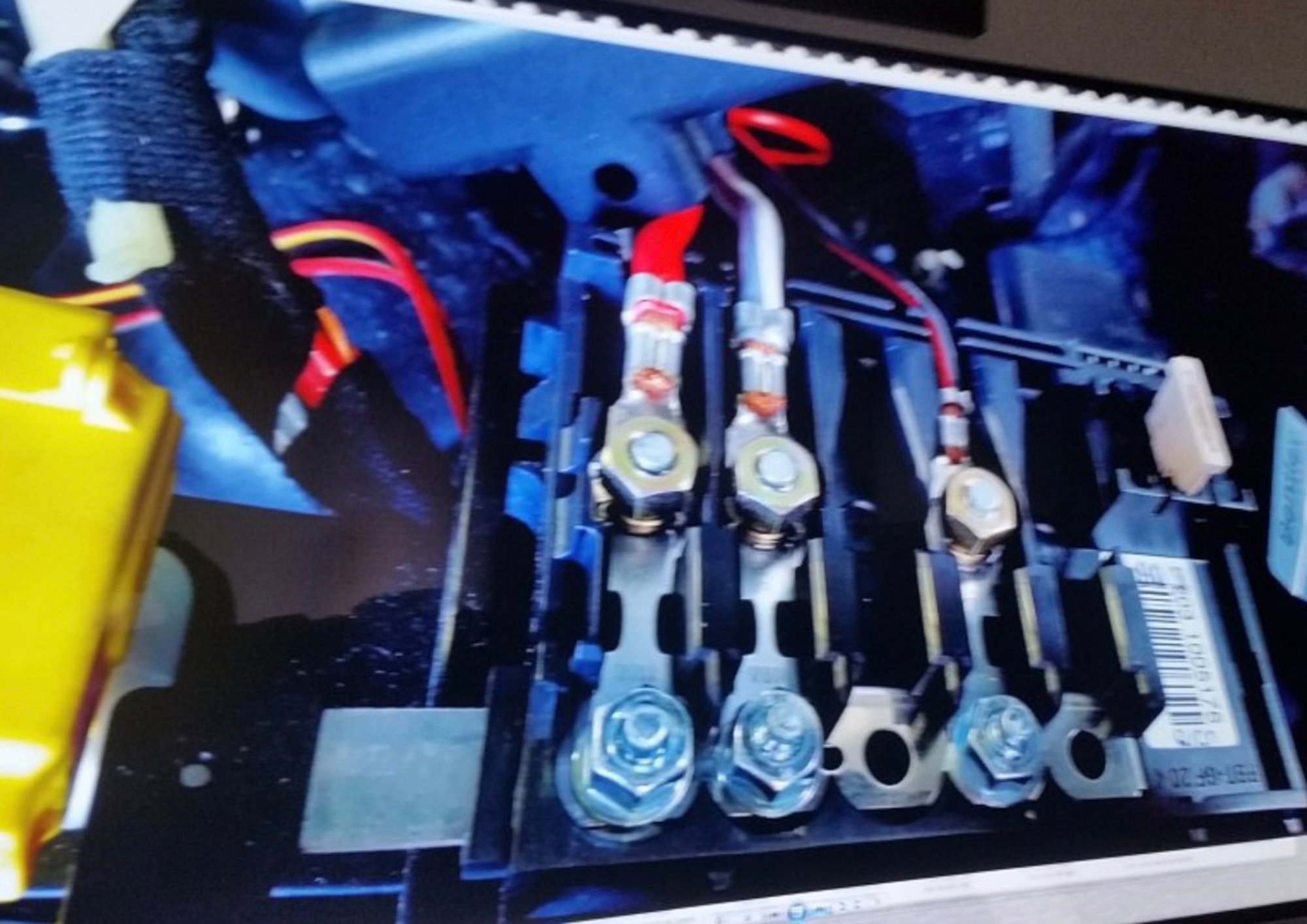

Ok, you have a W12, and it is a 2013, but it is also a GTC, so things may be a little different, but here is the information that is up to 2011 for GT.
Boot area fuses, the mega fuses under the cover on the house battery left side, the fuse box above the house battery that you know already, the fuse box mounted on top of the starter battery.
Interior dash fuses, the Facia fuse box in the driver's side dash knee pad area.
Engine compartment fuse box, the E-Box under the cowl next to the engine ECU'S, remove the E-Box lid to gain access to fuses and relays.
As to the IMMO comment, I would agree to a point, your 2013 has IMMO 4 iirc, and if you had a KESSY immobilizer issue you should have a warning message in the DIS between the speedometer and tachometer, if you had a KESSY module immobilizer issue, the warning should be immediately displayed, and the dash should not power up to allow the cranking of the engine, whereas, if you have an engine ecu immobilizer issue, then the system would allow the engine to crank and start everytime, but the engine would die in 2-3 seconds, but again, it would fire everytime for those 2-3 seconds.
My video below showing immobilizer kicking in with matching key-fob, KESSY, steering column module, instrument cluster, but with non matched engine ECU'S, as ECU'S are from the Supersports engine transmission package I installed, therefore no warning on dash, and all powers up and starts, but dies in seconds due to engine ecu immobilizer kicking in.
So tell us of any warnings ⚠️.

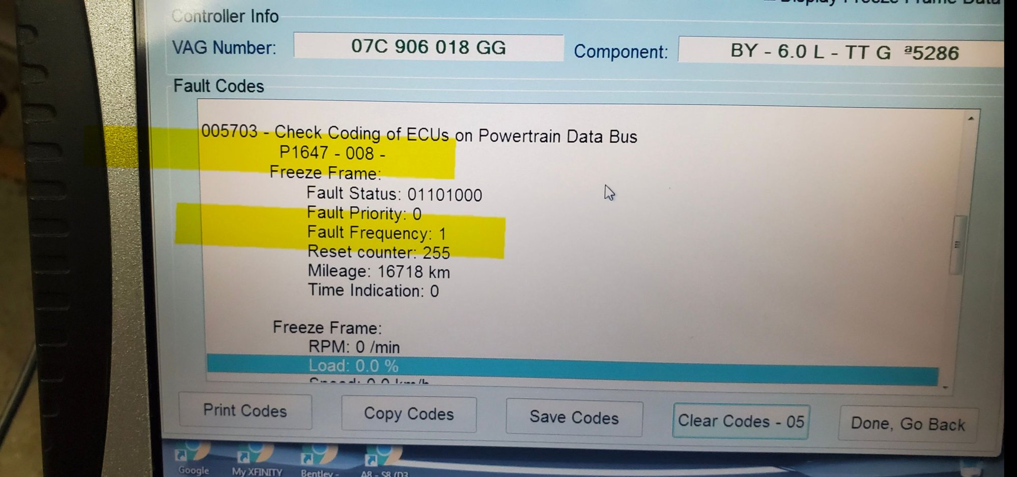

As I think of other issues causing the no start, the (G28) engine speed sensor comes to mind, as that was my first issue upon the installation of the Supersports package, I had fuel, and no immobilizer warning, but it failed to fire over at all, I took out the new one I had installed prior, and installed the broken socket G28, and she fired right over, be it for 2 to 3 seconds as the engine ECU immobilizer kicked in.
Your G28 part number may be different.
EDIT: And now as I look back at my pictures, I see that I had the same "P1647" fault code along with the G28 crankshaft position sensor.
