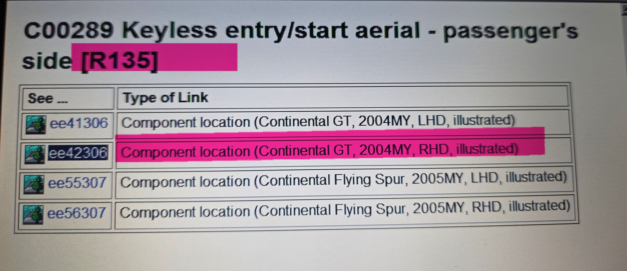

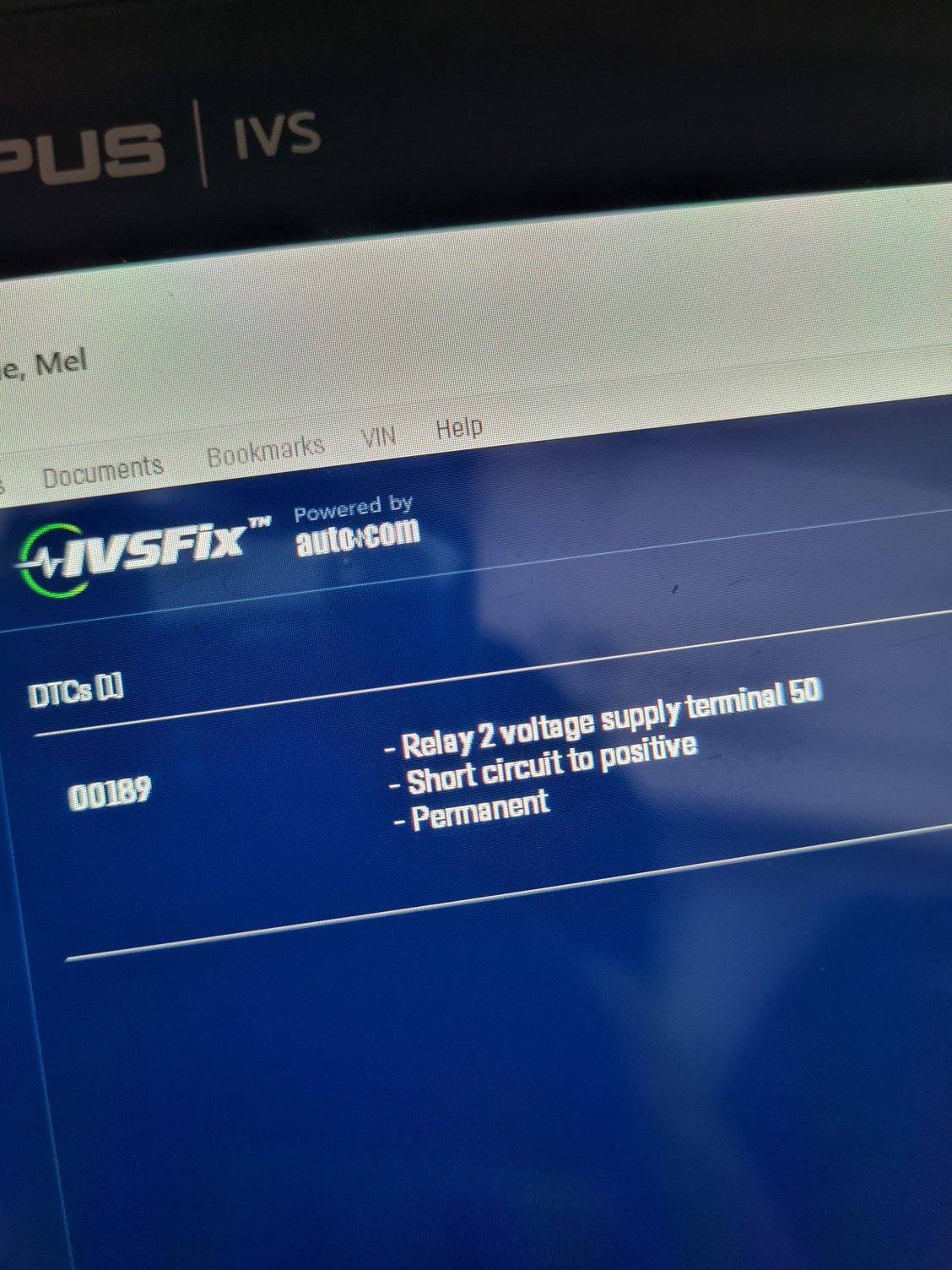

Couple of months ago I came back off holiday and noticed my 05 Continental wouldn't start at all, nothing would happen when turning the key or pressing the start stop. Since then I've been able to get it started with putting ignition on and pressing the starter relay in the boot. After some diagnostic in the local garage and with a Bentley specialist, the code of 0180 Access/Start Authorization Antenna, Passenger Side is appearing, along with Relay 2 Voltage Supply Terminal 50 Short Circuit to Positive.

The fault code is actually 00180, and as you stated, it is in regards to R135, and R135 is not in either of the A-Pillars, be it passenger or driver side, it is in the exterior door handle of your passenger (RHD) door itself, just as R134 is in your drivers side exterior door handle.

If you have no IMMO warnings, and the instrument cluster powers up with the key in the ignition, I would seriously check out the issue with "Relay 2", as it plays a role in the starting of the engine, as does the 80/100 amp mega fuse at the bottom of the house battery.

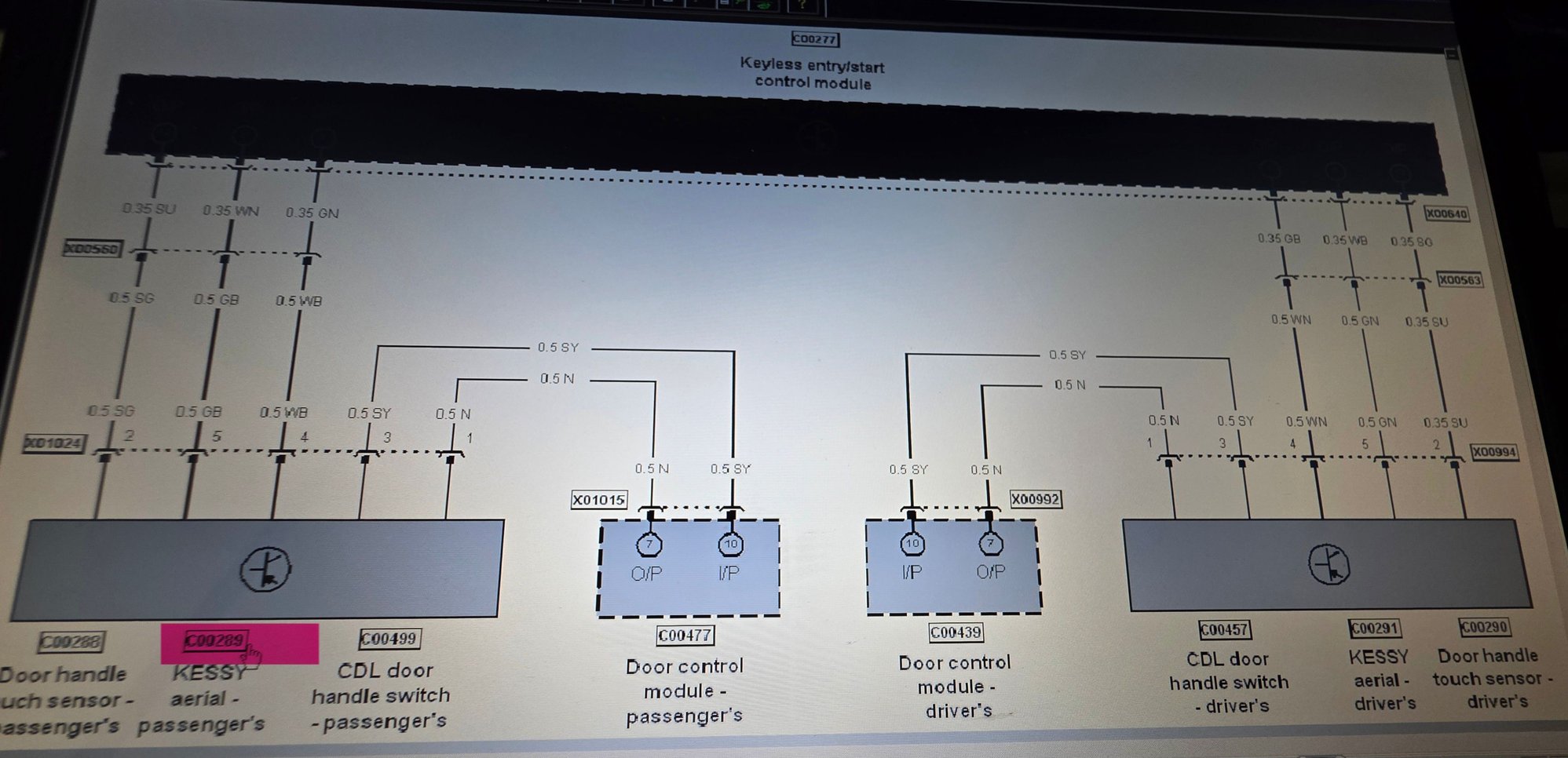

Im probably getting confused with part 3D0909141F that from diagrams I've found is in the boot and A Pillar.
Thanks for providing the info on where the actual part is located.

I've tested all relays and fuses and all are in working condition. I've also bought a née relay to replace the old and it doesn't change anything.
The way I get it started is why putting the key in the ignition, turning the key to the On position so the ignition is on, then going to the Boot Fuse Box, take the cover off the start relay and press the coil in which cranks the engine and it starts up.
I can't provide any other info about code readers and fault codes apart from the one I've attached, it was all down the garage and getting info is like pulling teeth.
All I know is the Kessy was tested and in working condition and a wire loom was ran from the ignition relay to the starter relay and it made no difference. There was a Bentley specialist that took a few hoirs looking at it and he said it could be the Start/Auth Passenger Error 00180 that's causing it.
