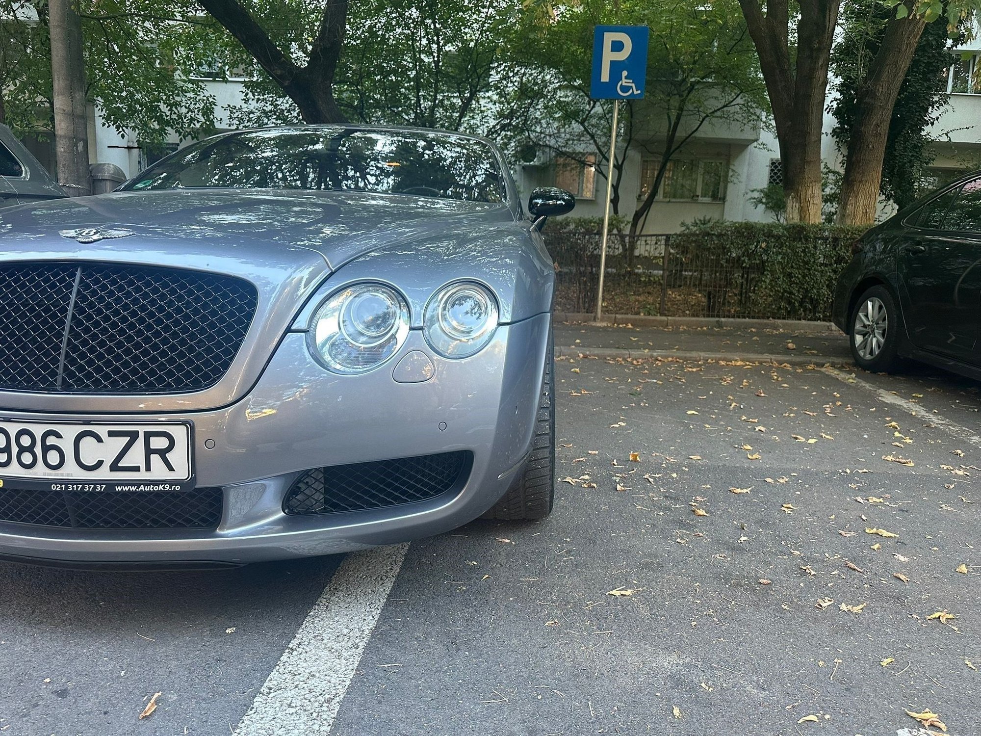

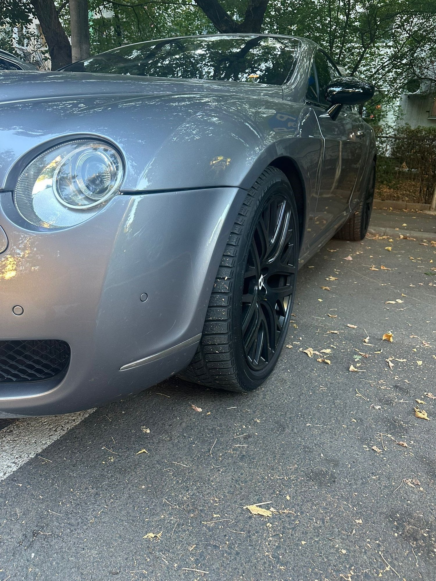

Hello ,
Continental gt 2005 problems :
When the car wants i can heer a loud noise left fron wheel when driving ( when i brake i can here , when i push on the fender i can here , if i shake the car i can here it outside and inside the car )
- im sure its coming from the strut (i think its bending ..) when i park the car the upper part of the wheel is inside the fender end the lower is outside ( i tried to aline it but the guy says that he canot do enithing more becose something is not straight )
- when i drive the car for 10 km straight road i get the suspension warning ( 01400 level control system ) but the car drives ok .. i turn it of i start the car end its gone ... if i drive in the city it will never apear
So im thinking :
Change the strut + pillow on the left side try to aline it but im afriad that i will bend the strut/pillow if i drive like this ...
But what can not be straight there ? the controll arm that holds the strut ? only the strut ? or maby the suspension knuckle ?
I know that the knok comes from the strut but i dont know whay i canot aligne it ... what is bent there ? ( the mecanic says that it is at maximum he canot pull the lower wheel more ... )
Can somebody help me to narow down the problem ?
Sry for the bad english ty
