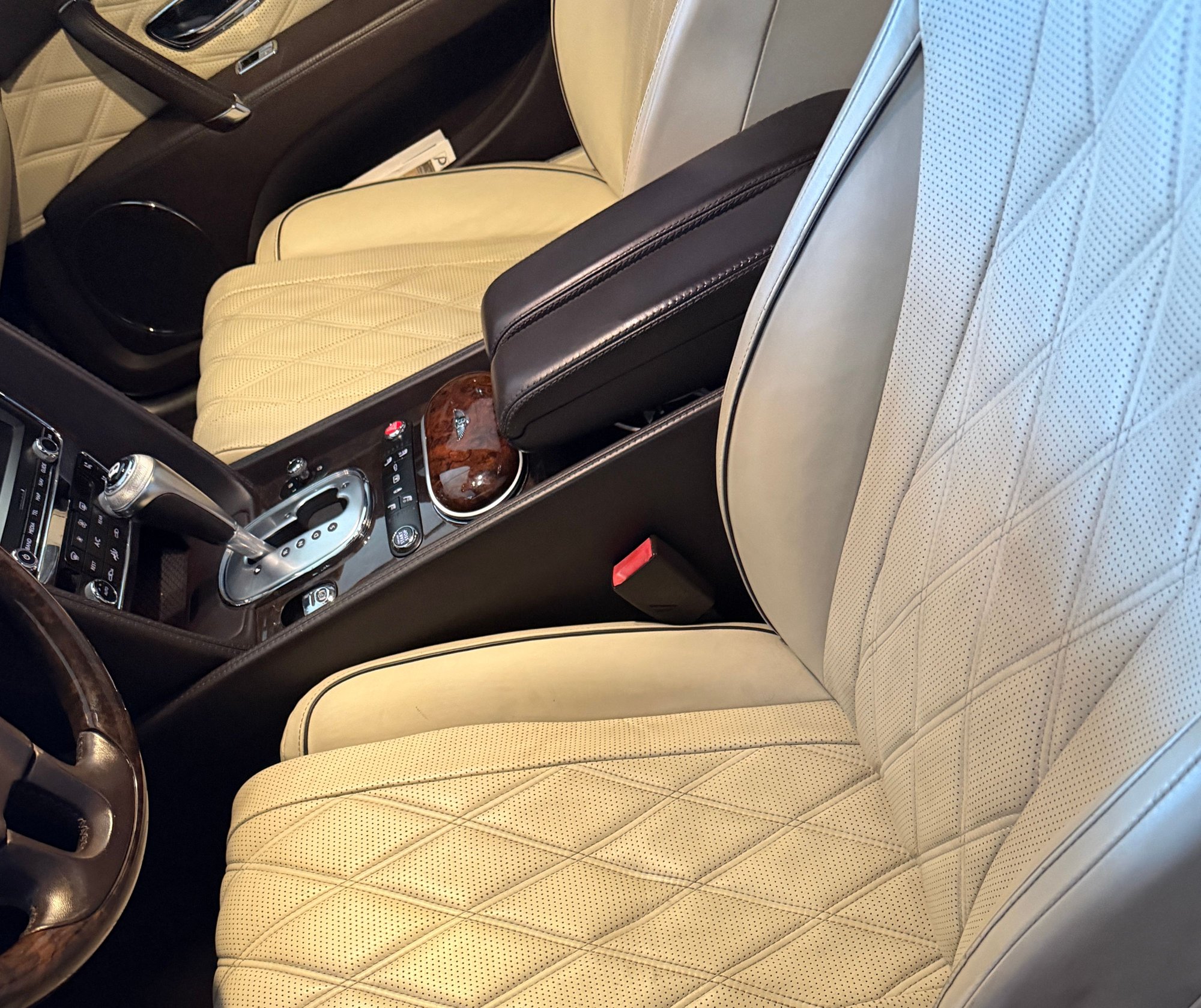

Hi all. I was thinking about changing some of the center console pieces on my 2014 Spur with the updated 2017-2018 pieces. The gear shift trim, parking brake trim, mirror adjust trim, and the big piece with the heated/cooled seat controls, suspension, and sunshade, and hazard lights. All of these are different in the two cars. The main difference is the gear shift trim, which I'm not sure if it can be replaced and I can't find the actual piece anywhere either lol. The rest of them are just different because the new 2017/2018 have the chrome trim around the parking brake button, mirror adjust button, and the big piece in the middle with most of the controls. I've done some digging on Scuderia, and I found some of those chrome pieces. However, I was unsure if they'd fit without a whole set replacement. Does anyone know If I'd be able to purchase the chrome pieces separately for those buttons, and if the gear shift piece is possible? Thanks in advance!

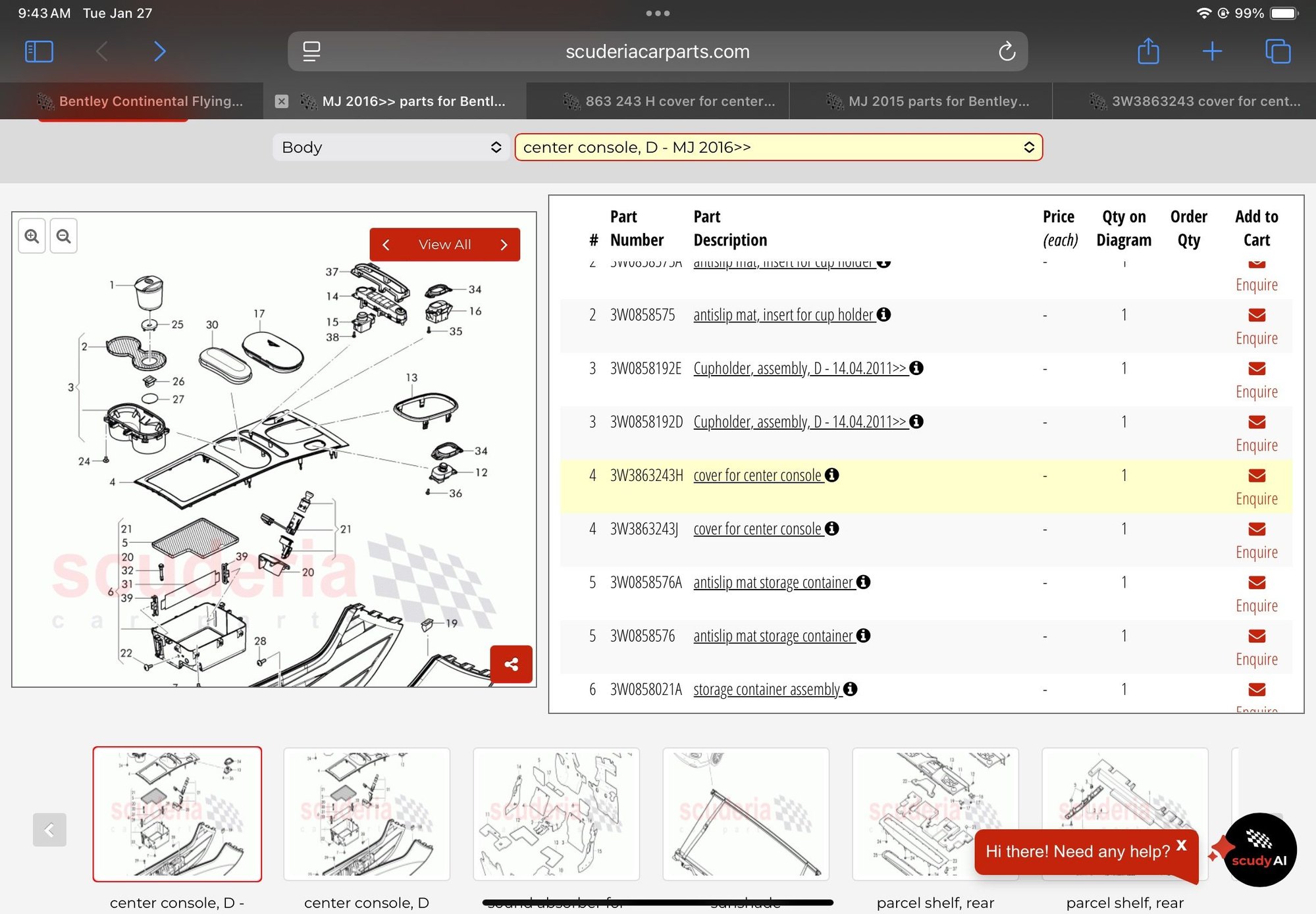

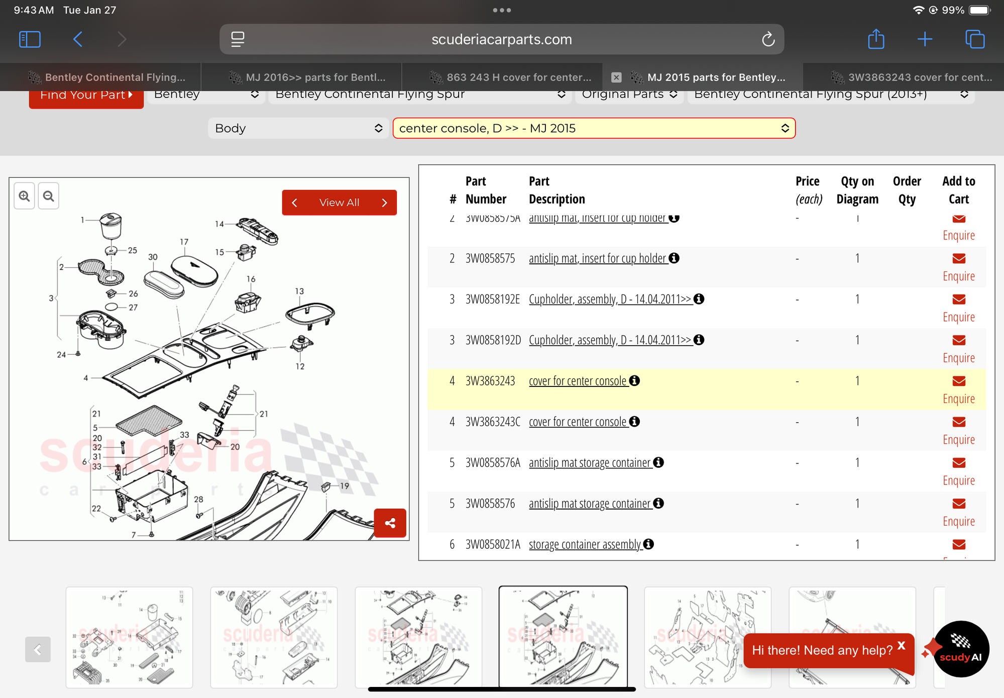

After some more digging, I’ve found that the center console wood veneer for the pre 2016 vs post 2016 have different serial numbers. Don’t know if this is actually the difference in the gaps between the chrome? Last week, @jeyjey mentioned if the wood would have to be cut. I assumed that Bentley wouldn’t have produced a whole new trim just to seat the chrome. However, maybe they did. The only thing I’m not sure is if the actual buttons are also different in the pre 2016 vs post 2016. Another thing that I’ve found out was that the mirror control switch and parking brake switch remain the same for the post 2016 and pre 2016, however the switch pack which has the seat heating and ventilation controls has a different model number for pre 2016 and post 2016. I’ve attached another image showing the different part numbers(bigger switch packs highlighted in blue). My understanding is that the parking button and mirror switches won’t have to be changed in order to fit the chrome. The switch pack even looks different in the diagram(mounting clips etc). My only question is if the wood veneer has to be replaced in order for me to at least just fit the chrome for the mirror switches and parking brake switch.
Hope this helps, and if anyone has any input please share!

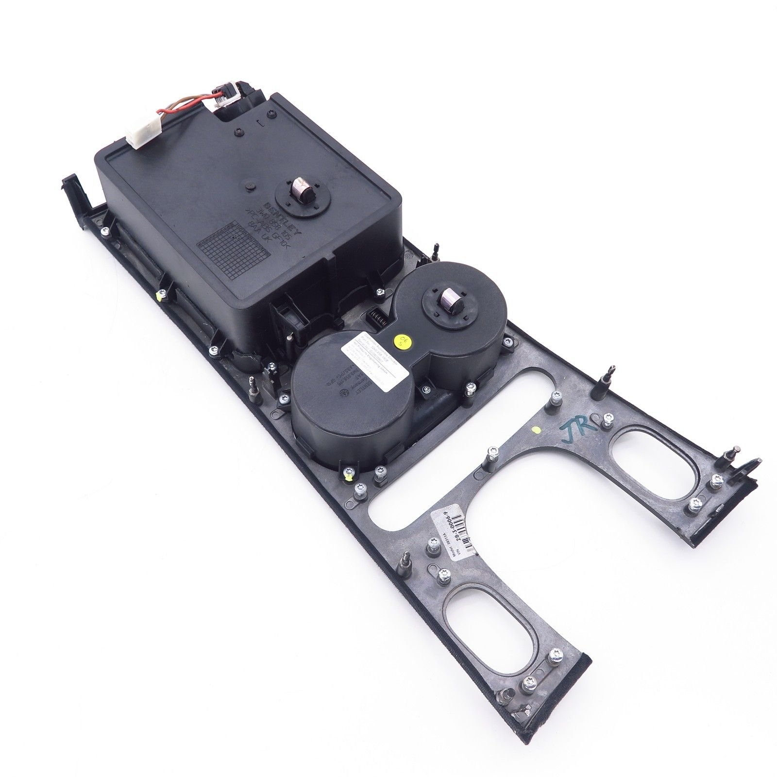

All three of the switches screw into the back of the wood veneer panel. Note that the tabs for the screw holes on the parking brake switch are quite long. So if the wood veneer panel had a slightly larger opening to fit the chrome ring there wouldn't be a problem.
But the screw hole tabs on the heated-seats/start-button/hazard-lights switch strip are quite short. So maybe the opening for it couldn't be enlarged because it would run into the screw receptacle bosses on the back of the panel? So maybe the screw locations needed to be moved out a bit (necessitating both a different wood veneer panel and a different button strip)?
This is all conjecture on my part.

Note the proximity of the screw bosses between the long button bar and the parking brake/mirror adjuster:

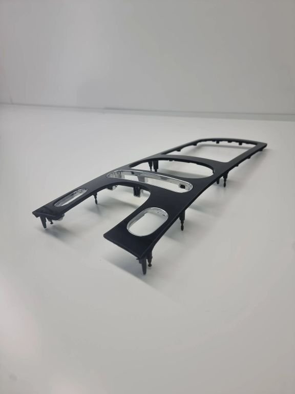

This picture appears to show one with the chrome trim rings installed:

Thanks @jeyjey. I think this clears it up a bit more. Did you find any of the wood trim with the chrome attached for sale? However, for now I might end up purchasing the two chrome surrounds for the parking brake switch and mirror switch just to experiment with this, and give us a better understanding.

No, I only found the older, sans chrome ones for sale.
