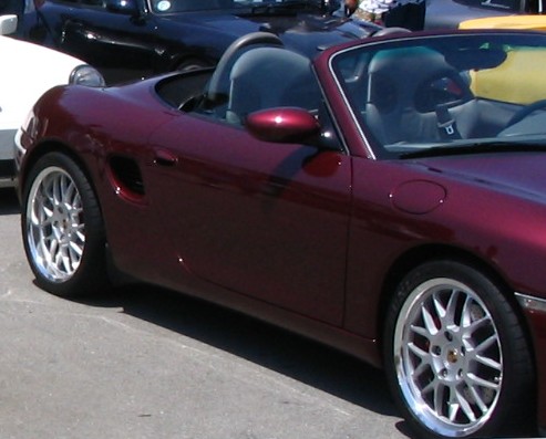

I managed to find a decent piece of a picture for you. Without jumping through hoops, 10" is the "practical" limit for a 986. With a 10", you will need a 47 or 48mm offset. You can go out to 40mm, but it depends on how wide your tires are. 265 is OK. 285/295 and you are sticking out and will rub unless you roll the fenders and go for some extreme camber to make up the hairs of clearance that you have. In other words a 10" ET40 will work, but it is not ideal. With a 10.5", you are moving every mm of that extra width into the offset and need ET40.

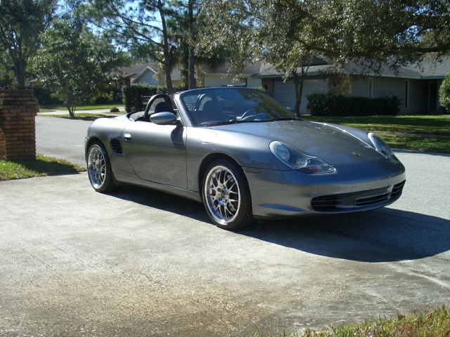

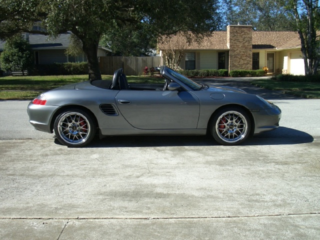

I didn't try to max out the width, mostly because it wouldn't have helped handling much and would limit my alignment options.
Here's my '03 S with BBS RS-GT's with Diamond Black centers, 18 x 9.5 and 18 x 8 with stock size Michelin Pilot Sport Ribs.
Old Dec 6, 2007 | 10:00 AM
  #44
Dino V's Avatar
Joined: Jul 2005
Posts: 2,906
From: Chicago
Rep Power: 141
Can't go wrong with BBS on Porsches, look nice.
