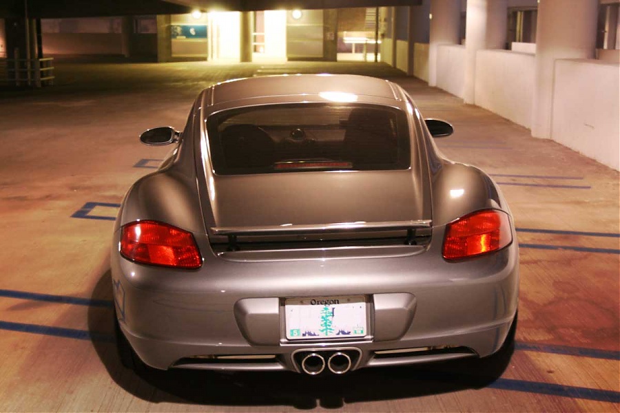

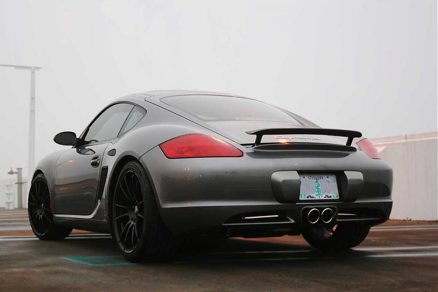

CS w/ H&R, 20s, exhaust
Finally took some photos this morning, enjoy!

Here are few more!

amazing wheels and car.
are they the oz's?

Tks, yea, OZ Ultraleggera HLT

at last someone has 20's on cayman
hi there
please tell me how the car rides on the 20's.... they look like oz ultraleggera HLT's ....which is what i am thinking of.
is the steering twichy and do thet tramline alot?
how much does it affect the ride?
and....does it improve grip and handling at the limit??
Much appreciated

Tks everyone, the wheels are OZ Ultraleggera HLT 20x8.5 and 20x10 on Pzero Nero 235/30/20 and 275/30/20. I would recommend going with 245/30/20 for anyone looking into upgrading to 20s. The 235/30/20 is way too thin for the 8.5 rims IMO, should of when wider.
Has anyone run 255 width tires for the front?
Shannon - not twitchy at all, the turn in feels quicker, due to lower profile tires, I feel more of the road surface. With the stiffer springs and wider rear tires, the cornering limit improve quite a bit, way less bodyroll, well the car didn't have that much body roll to begin with .
As for the ride with the lowering springs, I was surpised by how comfortable it is. It didn't change much from stock at all, well on normal smooth pavement. On rough/uneven pavement, it gets more bumpy ride. Less bodyroll under hard cornering. comparing to stock springs and stock 18s, I would say the ride got around 20-35% stiffer, and on uneven roads, you'll notice the difference right away from stock.
the 20inch tire package for the front, it actually weight 2 pounds less then stock and the rear it weight 2 pounds more then stock.
