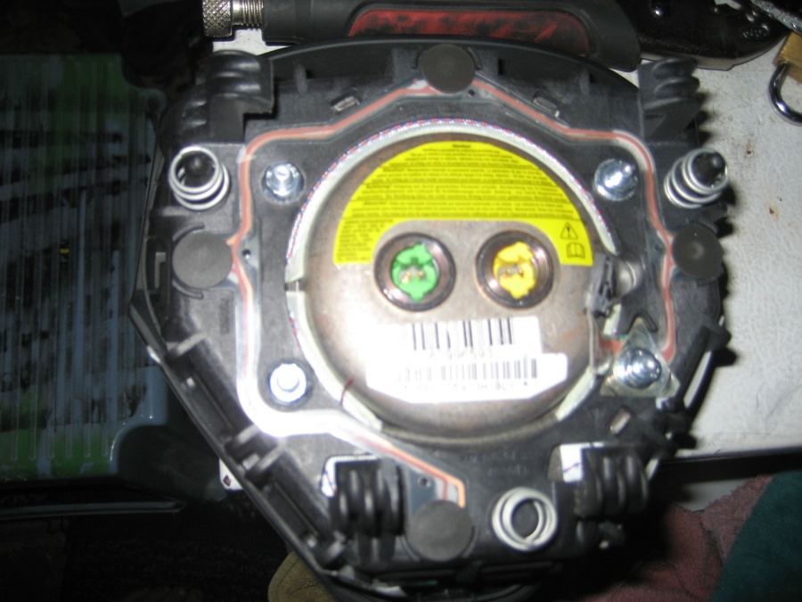

How does the Works Bell unit differ from the NRG unit? I've actually owned both on different vehicles. The Works Bell is of nice quality and has a better mechanism, but the electronics would be from a different source.
You can try to place a resistor to complete the circuit so your vehicle "thinks" the airbag is connected. If you're not too familiar with the resistors, they can usually be found from a variety of online sources.
I think your tech was also referring to the clockspring?

Here's what I did on my old Subaru:
You can find the resistor packs at your local Radio Shack for a fraction of the cost. Grab your trusty multi-meter and check for continuity. That's how I figured it out.
Good luck!

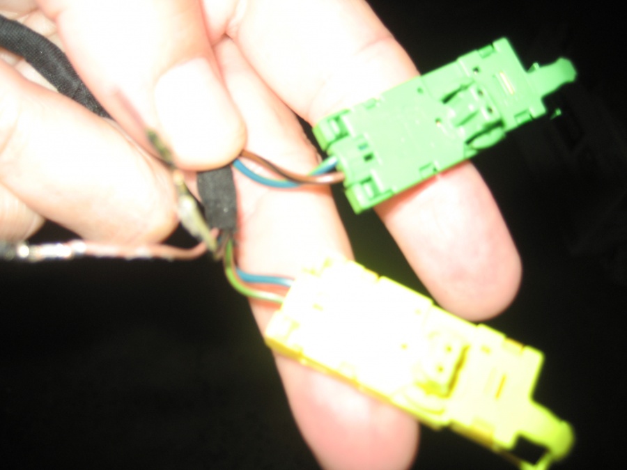

Here are pics of them
You are going to bend it like this:
Now, I don't remember if the conector has 2 holes (as in the pic posted by mod bargain) or 4, if it has 4 then take a pic to refresh my memory, otherwise just insert the resistor and u can use tape to keep it in place.
Old Sep 16, 2010 | 10:06 AM
Fluid987's Avatar
Joined: Mar 2008
Posts: 1,133
From: Gig Harbor WA
Rep Power: 97
Fluid987 has a reputation beyond reputeFluid987 has a reputation beyond reputeFluid987 has a reputation beyond reputeFluid987 has a reputation beyond reputeFluid987 has a reputation beyond reputeFluid987 has a reputation beyond reputeFluid987 has a reputation beyond reputeFluid987 has a reputation beyond reputeFluid987 has a reputation beyond reputeFluid987 has a reputation beyond reputeFluid987 has a reputation beyond repute
andresito360
Here is a photo of what it looks like .
2 holes on each connector 1 yellow plug and 1 green plug that use to plug in the back of the airbag unit just as modforbargains pictures showed and there are 2 loose wires that use to hook in to that copper looking ring around the inside of the airbag unit(see second picture) dont know what that is ? .
so this is what I have
1.yellow plug
2.green plug
2. two loose wires
do I need to install resistors in both of the colored plugs ?
wonder if the to loose wires are the horn ?
Thanks so much ,REALLY!! appreciated
