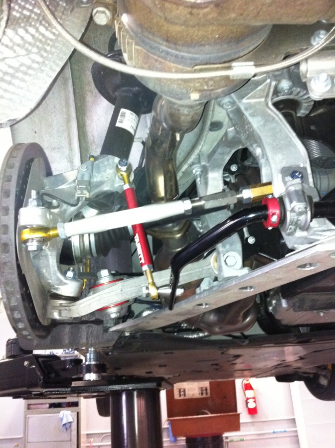

I see that you went with tarret stuff. Does that thrust arm bushing allow for castor adjustment? I already ordered RSS lower arms they are more expensive than GT3 arms but justifiable because they are better parts - CNCed from billet vs cast factory + stiffer ball joints + replacable outer balljoint unlike the factory where one has to buy a new part. As chassis engineer I will assure that it is one of the most loaded joint in all suspension. Even slight play in it will hinder handling. Also RSS allows for RC height udjustment.
I ordered Motons (got a good deal - 200$ less than list price) and TBD from Matt.
At this point I'm looking for suitable electic steering pump. Thats what we always used on racing cars (touring and GT). We'll place in the trunk. Apart from better reliability it will aslo safe few ponys.
At the start we'll go with softer springs (450 - 600/550) and ARB's on soft side and will go for more responsive (stiff) setup as he will develop as a driver (as Cajundaddy mentioned) Balance - we'll start with front roll stifness about 60% (taking in consideration springs, bars and geometric forces) which is very conservative.
I got suspension coordinates (in .gem format) from fellow forum member and will look into it later. Will be interesting to see what actually happens with Cayman suspension geometry during dynamic events - Mitchell Software allows to import logged suspension data and it will show exact positions of every suspension element relative to chassis/road on every meter of the track.
Thats how ARB's will be designed for this car - get on track data, suspension cad data. Get it into simulation (like LapSim or up to Vi-grade (ADAMS)) see what range of parameters are predicted to work. Design a part that allows enough adjustability that will cover desired performance window - > test -> on track data -> design updates - final part. Titanium alloy blades, sealed ball joints (car will see some street) etc.
There are some engineering toys left form racing days. So will put it to work
I always loved to design and test ARB's - in formula car it's usually an extremely restricted space so I preferred T-type bars. If it is of interest I can up some pics.
You where mentioning tarret blade type ARB's and fit of front bars/links. I'd love to know more about it or we can use email if you don't like to make it a public discussion. I can't send PM's yet - need some more posts.
