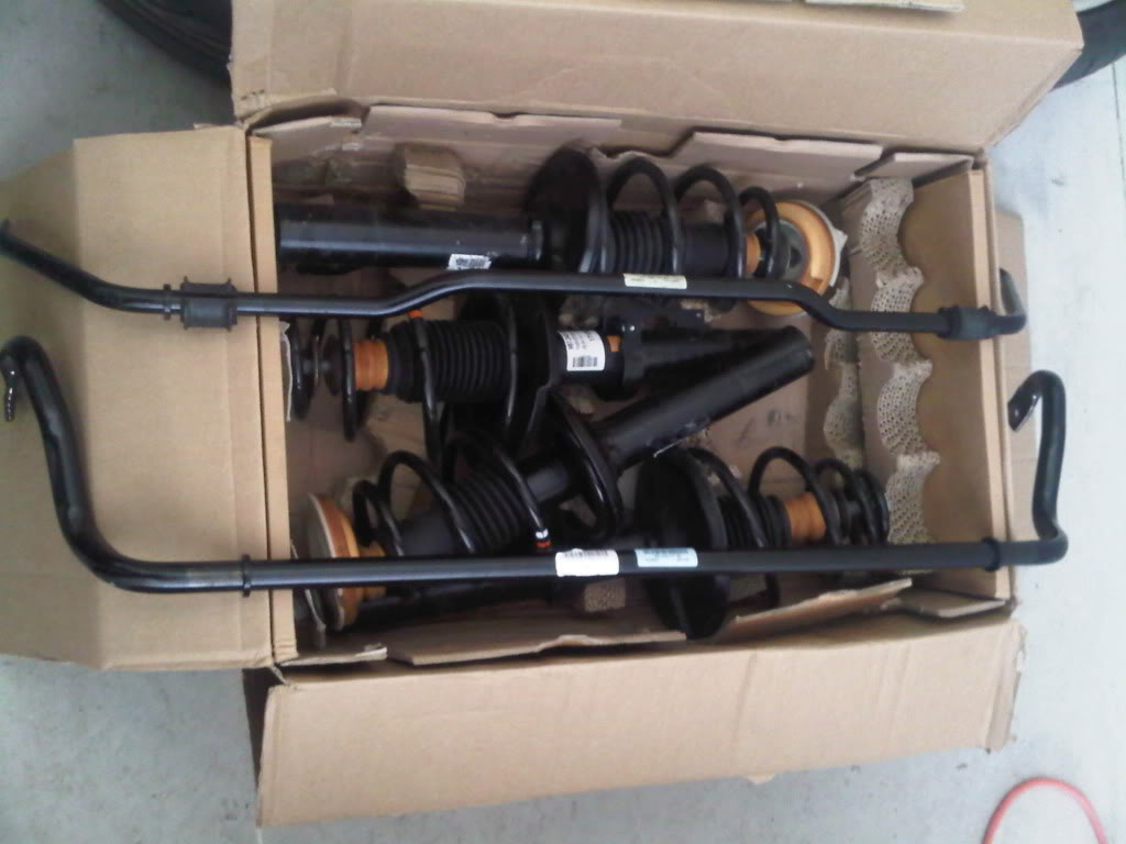

I have just purchased a complete set of Spyder springs, shocks and anti-roll bars from another Forum member here. I hope it is a straight forward plug and play (plus alignment).

Old Feb 11, 2011 | 09:08 PM
GTA Boxster's Avatar
Joined: May 2010
Posts: 34
From: GTA
GTA Boxster has much to be proud ofGTA Boxster has much to be proud ofGTA Boxster has much to be proud ofGTA Boxster has much to be proud ofGTA Boxster has much to be proud ofGTA Boxster has much to be proud ofGTA Boxster has much to be proud ofGTA Boxster has much to be proud ofGTA Boxster has much to be proud ofGTA Boxster has much to be proud of
