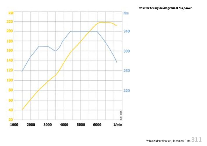

Here's the engine diagram for your boxster (it's in the owners manual). There really isn't much else to say. A boxster is not a 350z.
hehe - I've already had a good look and could not see why the Zed has such a noticeable advantage off the line. See below the torque figures across the rev-range for both cars ... yes, the Zed does have a torque advantage at the lower revs, but it's only about 10%. The weight difference between the 2 cars should compensate.
Code:
Boxster S 350Z rpm Nm Nm 1000 230 258 2000 288 317 3000 309 335 4000 323 350 5000 340 360 6000 340 324 7000 298 -
