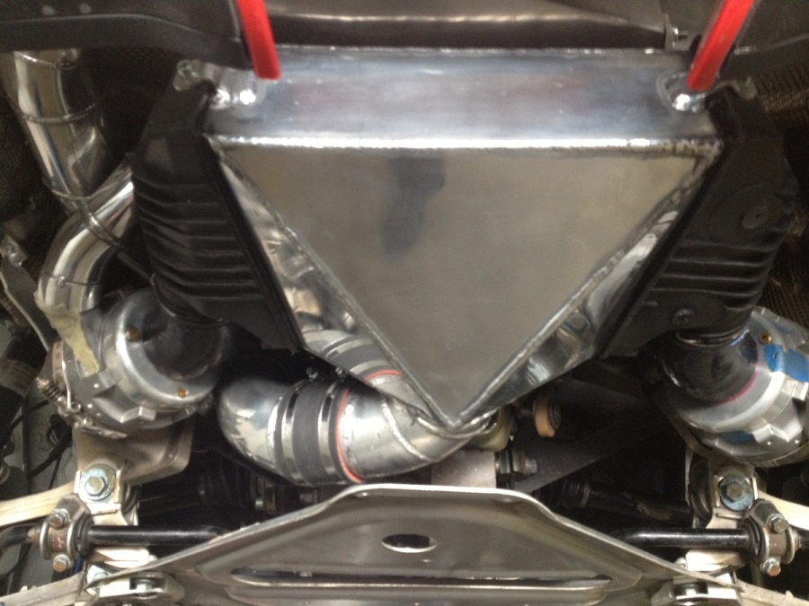

Pictures new of build
Took some pictures today from the fabrication of the Turbos, charge cooler, and rest of build, this are very cool pictures because now is going from a project to the actual finish product. Their are doing the last steps on the fabrication making sure it all fits in a reduced area, should have it all done by the end of next week.

New pictures, almost there
I havent had the time to make new posts. Take a look at the pictures, we are almost done, looking real good.
