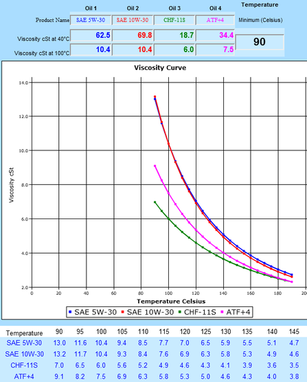

6 months and 5k on ATF+4 power steering fluid
Still smooth and quiet.
Most people I know bailed-out on thin Pentosin CHF 11-S a
long time ago. MB developed +4 as an awesome ATF, which doubles as PSF. GM likewise uses their Dex 6....duty tested.
ATF is the most common ps fluid in the industry. VW, et al, used Dexron 2 and 3 before CHF, using the same ps parts, like MB uses the same parts as VAG.
Anyway, I know Porsche owners have failure issues, just like other Euros, except MB. So, I thought I'd point it out as a easy solution. As psf temps rise, the fluid thins, CHF is already thin, so the pump has metal contact, producing runaway heating...and warping the seals. ATF has a slight seal swelling effect too, so it really is ideal. Thicker with more and better additives is the key. Many people used Mobil 1 ATF in the past. Its a fine choice now as well.
I just used a turkey baster, its easy. Small reservior means a bunch of fill-run-empty cycles are needed for this car. One quart should do it fine.
I'll post some data later.

Maybe an expert can explain the failure mode of a fluid that is fractionally thicker when overheated. How is this going to cause catastrophic failure?
Should't fluid that's a hair thicker be, umm....better?
I can tell you how old Pentosin can fail, a thin fluid sheared to a superthin state and contaminated by shed metallics from the pump and blackened from seal degradation...it causes friction, heat and wear...simple.
I'd ask, why not test your theory by sending in a sample of your fluid to someone who can do a PQ Index for you (look it up)...Butler Caterpillar labs maybe.

Ill assert that PSF should be changed. After reading and replying to several threads on the 911 forums, where blown PS systems are the norm, I hastily inferred 986/7 owners would like to take this simple step to assure a long lifespan of their systems.
The high temps and number of shear strokes in the PS system will reduce the fluid viscosity, below the already thin 6cSt. Contaminates accrue, and the additives in the fluid wear out, that being the friction modifiers, anti-oxidants, detergent and dispersants etc. Lubricating a PS pump is demanding on the fluid.
Many vehicles fall to PS problems, it's true. idk what people think the failure mode is, but weak fluid is the most obvious.
Changing is very easy with the turkey baster method. Like I said, the reservior is small on the Boxster, so it takes quite a few cycles of extracting and refilling, and then running the engine while turning the steering wheel a bit.
Easy, effective and cheap. idk what's not to like. You can refresh the system with CHF11S, but that's kind of a sideways move.

http://origin-qps.onstreammedia.com/.../pc/index.html
While you're there, compare generic and mfg specs.
dy think Porsche is going to use a Mercedes PSF fluid?
I seriously thought that, on a Porsche Forum, that you guys would already be onto the Mobil 1 ATF as PSF tip. I have no problem with that, but ATF+4 comes with a reference page in the "Mercedes Book". Generic +4 is dirt cheap, like $4 W*M Supertec...because it's not generic, it's proprietary....a specified base oil and exclusive Lubrizol additive pack. Same **** as $15 a bottle MB PSF/ATF over-the counter.
Really, it's kind of a laff arguing with thin air, but I always assume there are readers who want the full story, and appreciate my effort, even thru the static.
Let me condense and simplify so nobody gets all butthurt over the syntax. If you want to change your PSF, and I think you should, OR if you have a leaking system, you CAN try the newer and better MB ATF+4, which is a lil thicker, with more and better additives as well as a slight seal-swelling effect...with a simple technique. Or you can ignore it and hope for the laws of physics, chemistry, experience and logic do not conspire against you.
Now, a trivia question. What did Porsche+Audi and VW use as PSF *before* CHF-11s?
