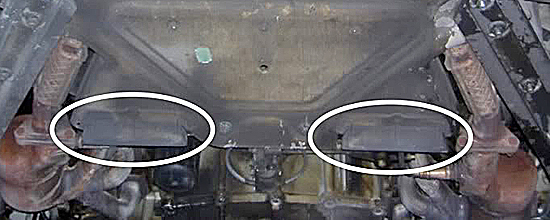

But I got new drops under center of the engine, but really only like 3 drops and small puddle again near right rear tyre (in puddle I mean like 0.3 of a cup at most) and after longer investigating I found, that some moisture was around air inlets right before the engine on underbody - I think they are these:
http://www.suncoastparts.com/mm5/gra...ansmission.jpg
any idea what is above those inlets? some coolant hoses or tanks?
Thanks in advance !

The rear under tray you pictured needs to be removed and then you can see the bottom of the water pump and thermostat. It is likely your water pump is leaking. It is recommended ( by LN Engineering ) to replace it with a genuine Porsche water pump and do so every four years like spark plugs. There are no known better pumps unfortunately. The aftermarket pumps may have metal impellers that destroy the block when they fail. You should have pink Porsche ( Pentosin ) coolant in your car. If you have green coolant someone took a short cut and used regular coolant. Use distilled water rather than tap water too. My 987 went through two replacement pumps. Search for some water pump articles on Pelican or P-9 to see what has to be done. Bleeding the system requires a few cycles with the bleeder valve lever open on the coolant tank open unless you have access to a vacuum coolant filler like an Airlift.
Good luck.
Make note that two of the water pump bolts are longer than the rest.......
