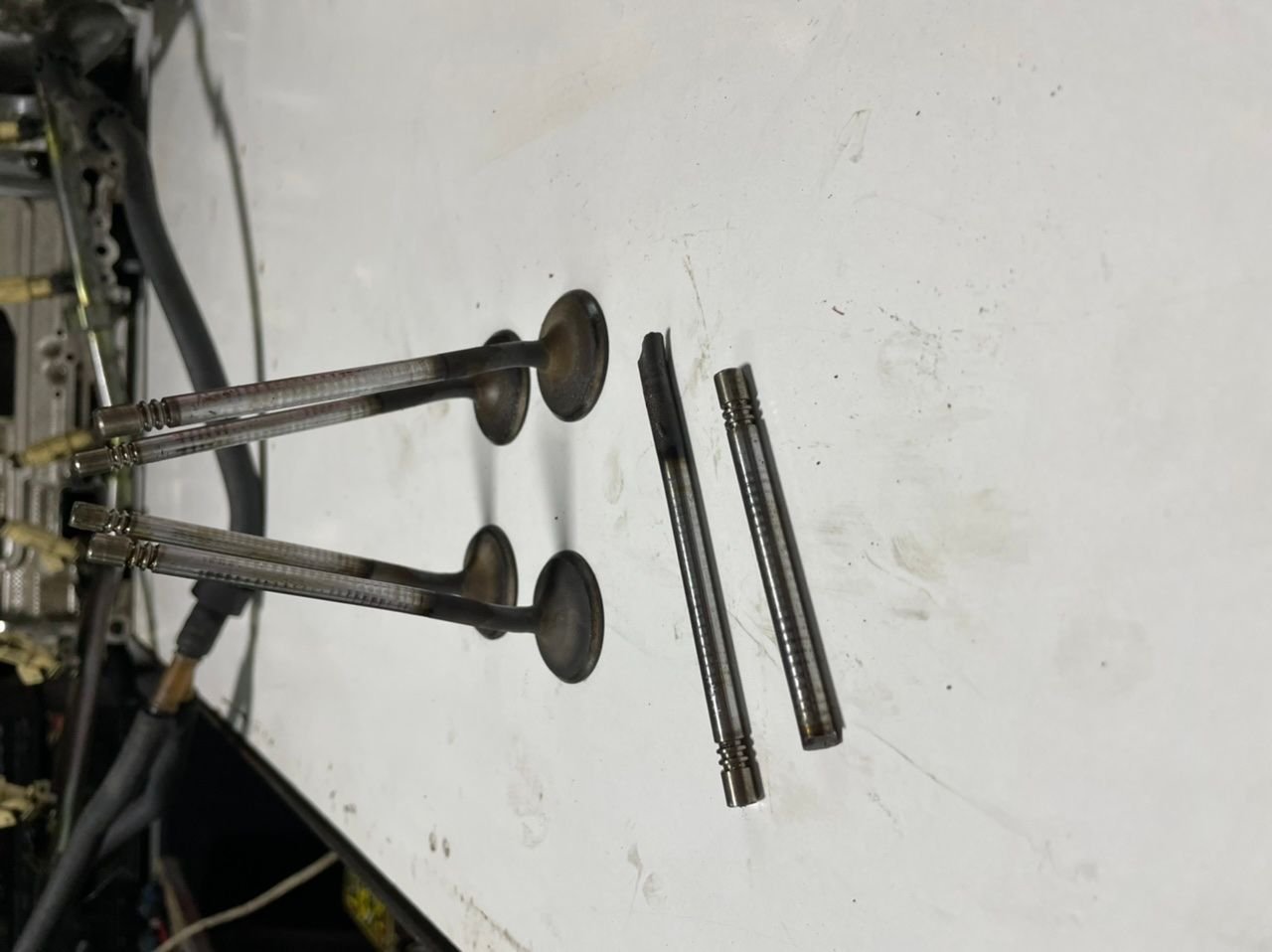

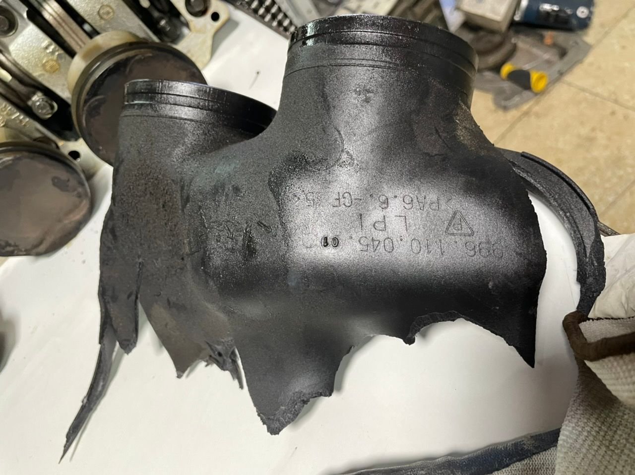

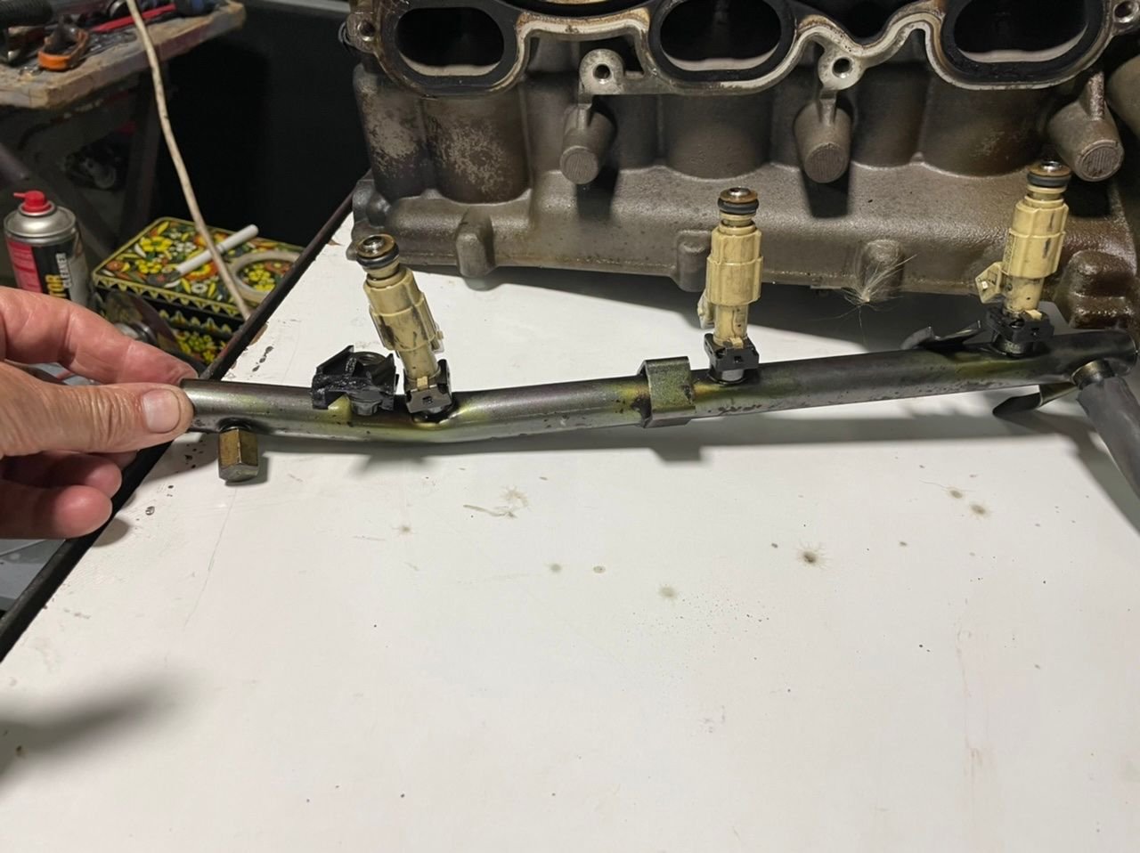

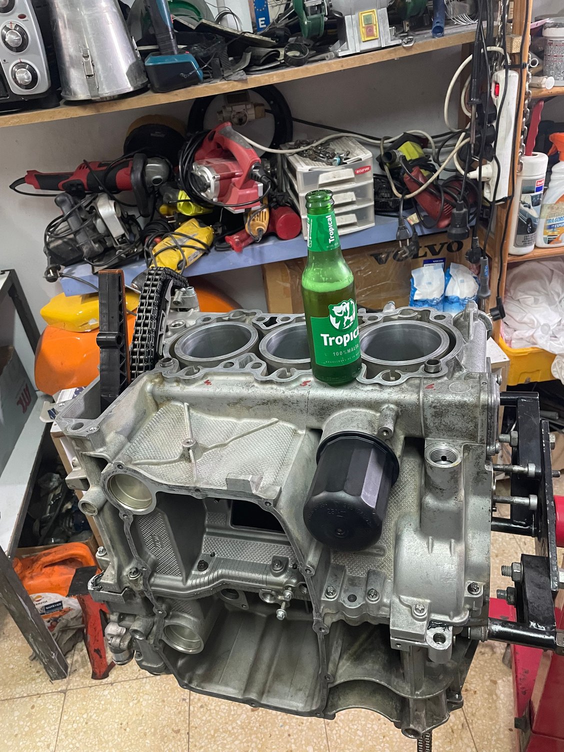

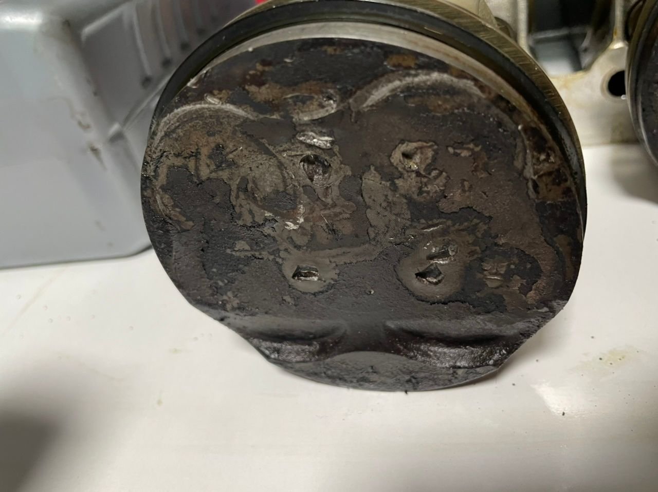

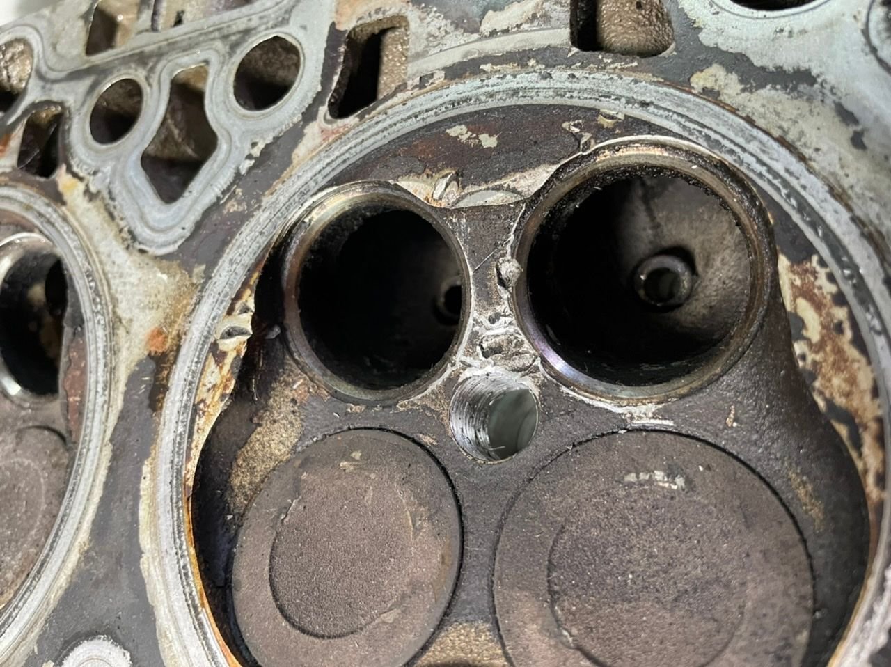

Engine rebuilding beguin
After parts to replace:
1 x piston
6 x exhaust valves
valve seats at one cylinder
intake manifolds
oil tubes
gaskets, cylinder bolts
bearings

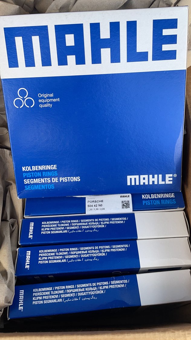

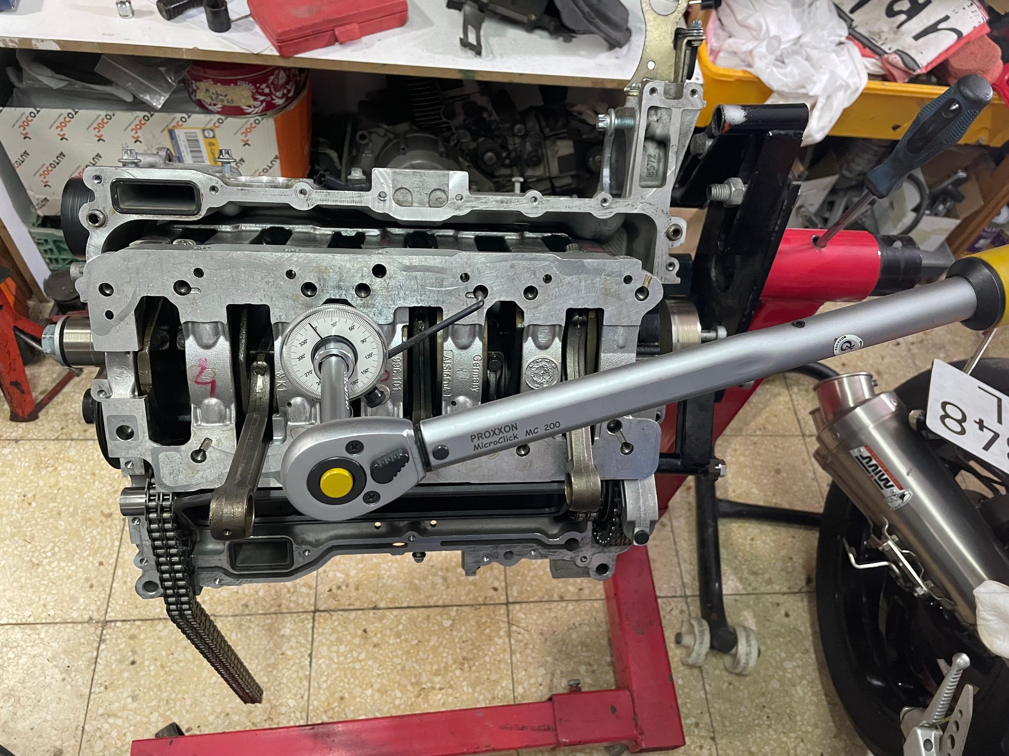

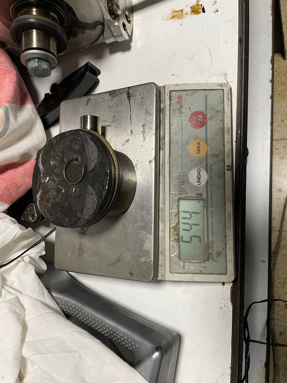

There are two different piston at the 3.2Ltr engines:
A. 535-541g Ref 99610303215
B. 541-547g Ref 99610303216.
my pistons are the more heavier units, so that’s el what I bought plus new piston rings for all pistons

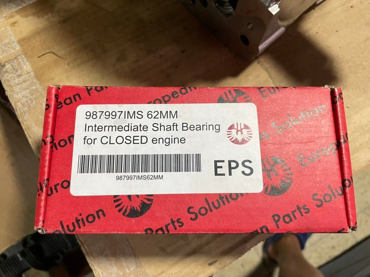

Old Mar 4, 2022 | 07:58 AM
Jan K's Avatar
Joined: Jul 2009
Posts: 11
From: Spain
Jan K is infamous around these parts

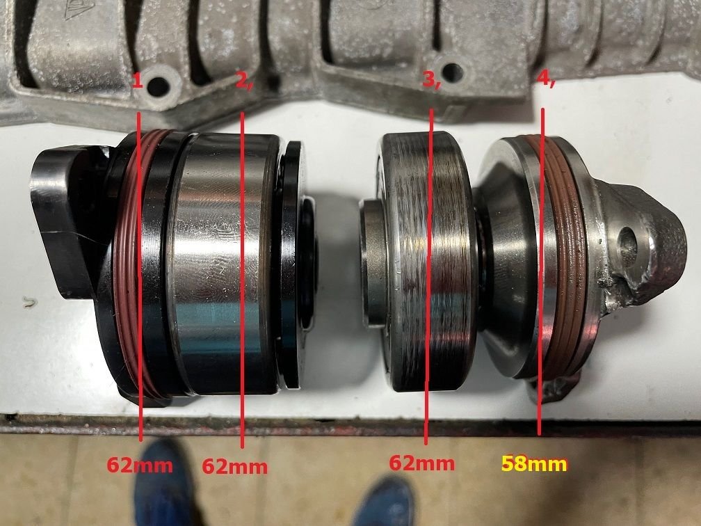

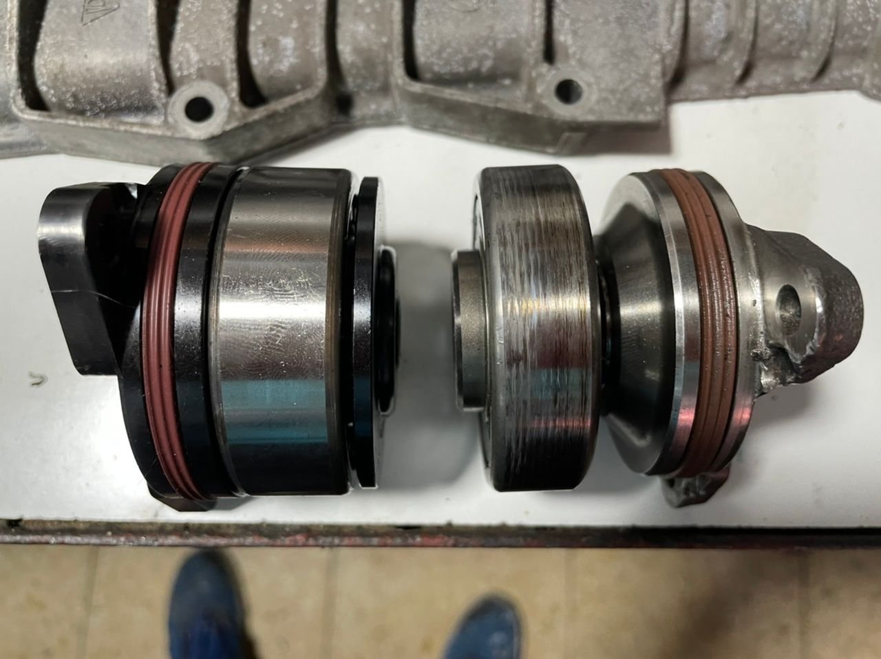

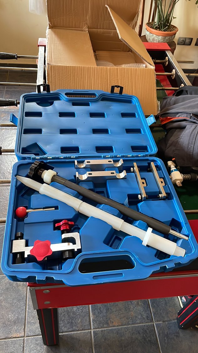

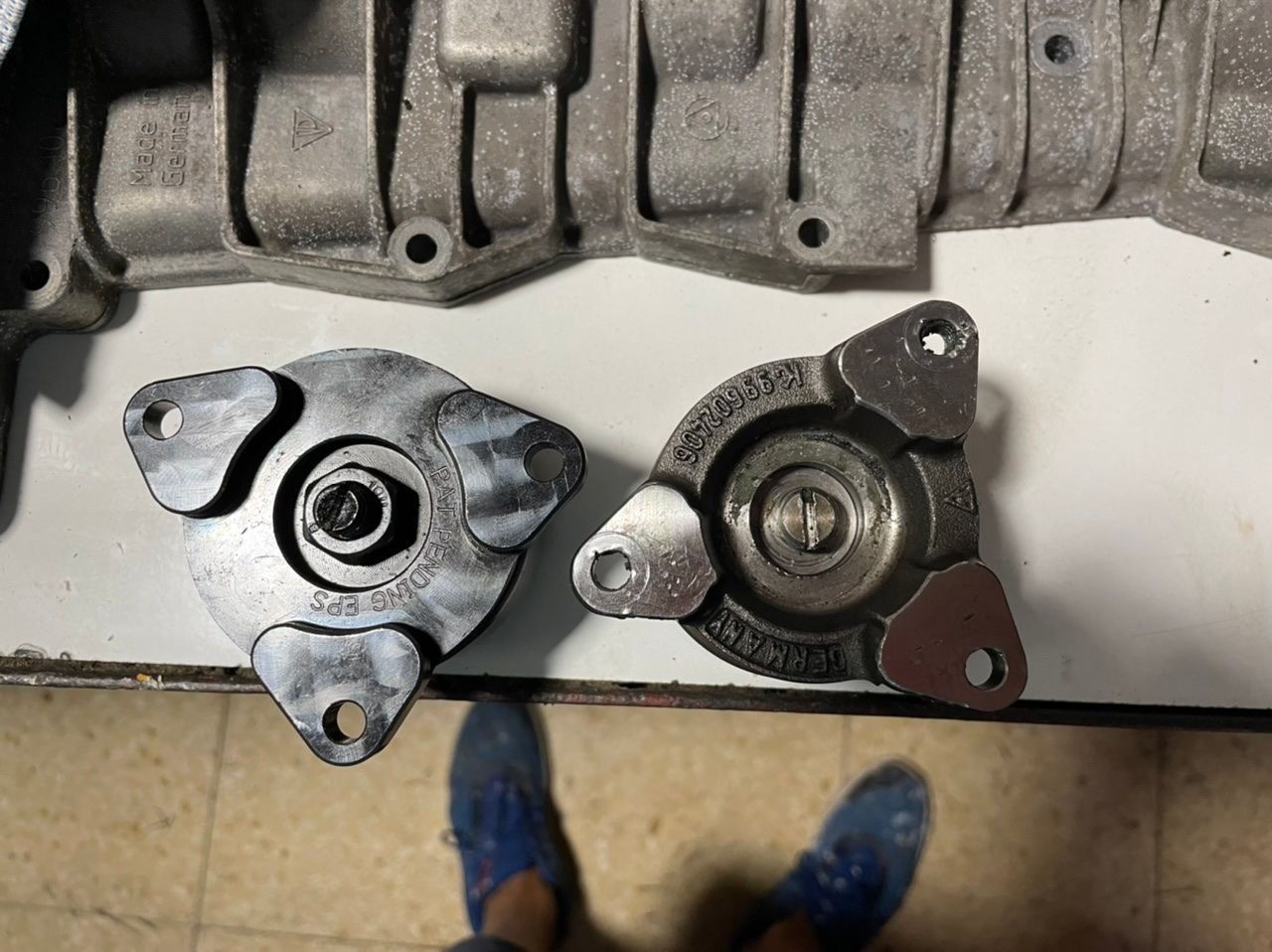

For IMS I bought this reforced unit, to make this fit I sent the engine block at a local workshop who made a bigger hole to be available to take the new IMS bearing, the good thing is that now it’s possible to change the IMS at every clutch change

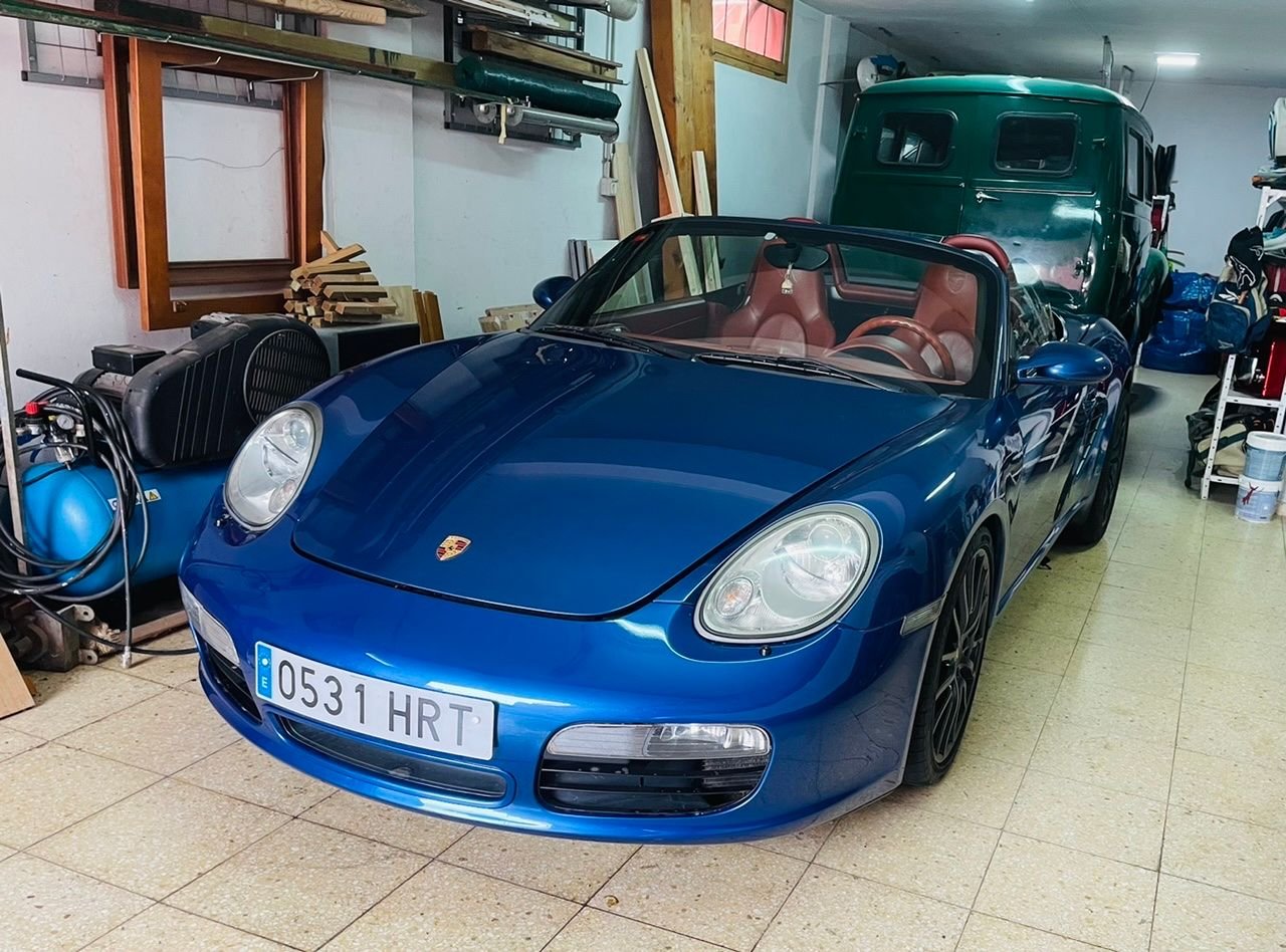

Old Jul 27, 2023 | 02:49 PM
Jan K's Avatar
Joined: Jul 2009
Posts: 11
From: Spain

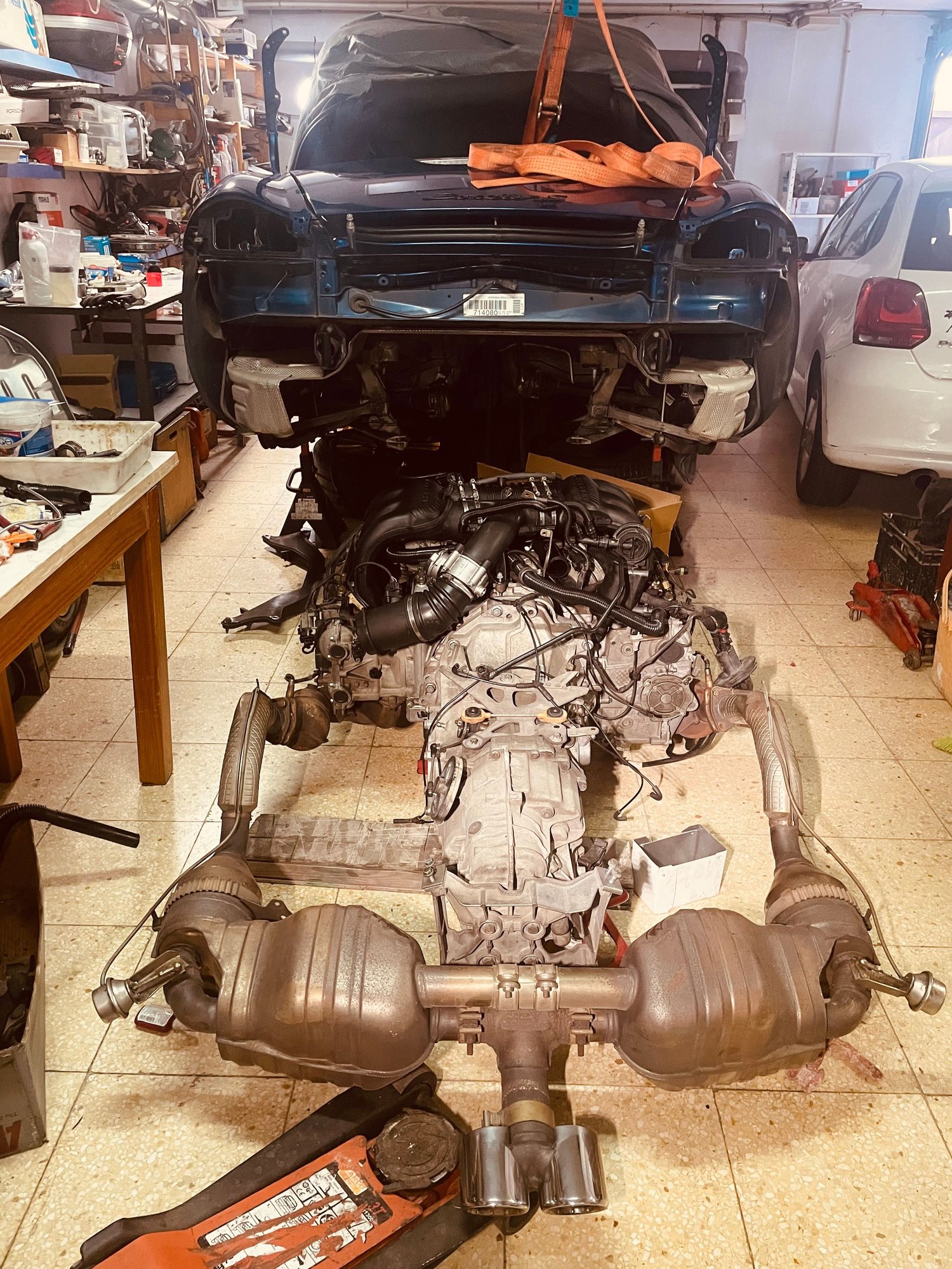

Car ready!
The car is finished!
