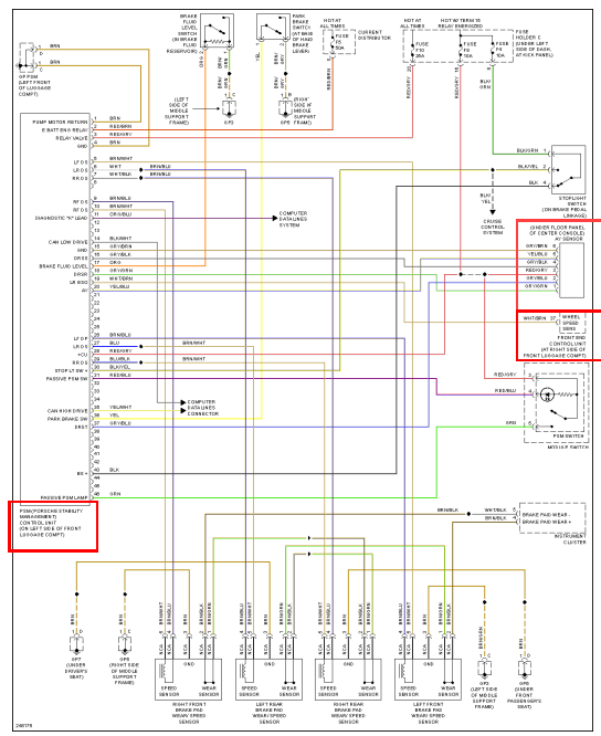

I found the electrical diagram of the 987, and found this:
Anybody knows what the "AY sensor" and "Wheel speed sensor" are, and where they're located?
Thank you!

Quick update: the issue was the getaway unit was fried and hence not communicating with the steering wheel electronics.
Replaced and recoded the getaway, all good now!

That’s frustrating! Since the PSM failure appears before the engine starts, it does sound like an electrical issue. Given that C153 is showing across multiple systems, you might be dealing with a faulty steering angle sensor, a weak ground connection, or even an issue with the CAN bus communication.

Hello
I'm having the exact same problem as you on my boxster 07.
Could you please explain where the gateway module is located?

I had the dealer replace it, but I believe it is located in the front wheel well on the driver's side.
