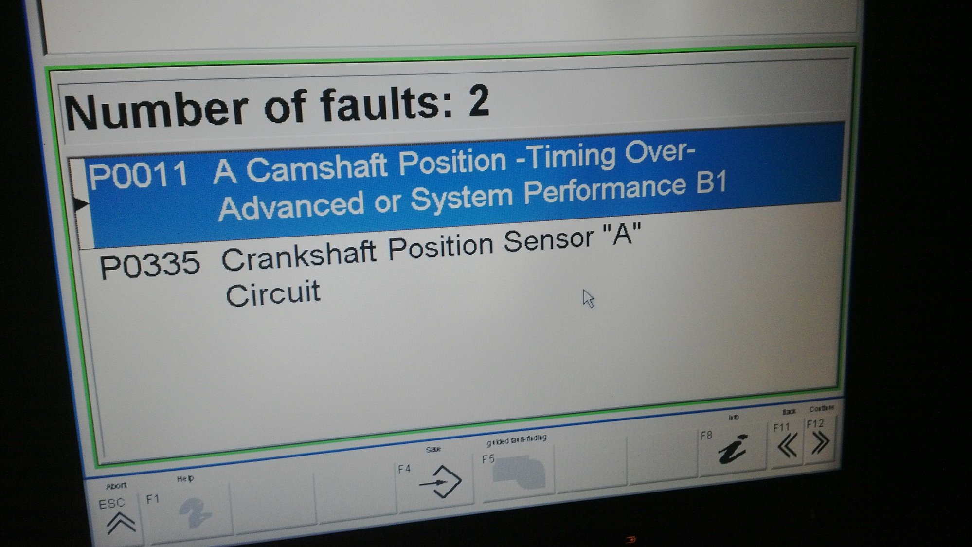

I just thought I'd add something to this thread after my recent experience. I also experienced an intermittent "PSM Failure Workshop" warning on my 04 CS.
At first it would occur only on start up, not from a cold start I should add, usually when starting from an intermediate temperature, like for example after driving to the supermarket and leaving her parking for an hour or so. No problem when starting from cold or when fully warmed up. I'm not sure of the significance of this, but it's just the way it was. The engine would turn over for longer then usual before starting and I would get the "PSM Failure Workshop" warning. If I drove with the warning on, performance was notably poor (misfiring). The warning would go away immediately if I switched off and started again.
The problem later escalated (after a few months) to stalling at idle and eventually to stalling even while cruising (but then recovering).
Anyway drawing fault codes gave the following codes
I replaced the crankshaft position sensor to solve the problem.
It's actually quite an easy job, most difficult part was to get it unplugged !
