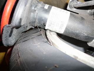

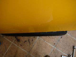

I cant see how you can get an 11" rear under a Boxster. Maybe the Cayman has larger rear fenders or more offset. I tried the 19 x 11" from my 997S as an experiment and as you can see, the inside rim touches the shock damper and the outside of the rim protrudes from the body. This is also with Porsche 21mm spacers.
Why would you run a 21mm spacer? Thats a very larger spacer..
Whoever built your wheels did not do the right offsets and back spacing if your rubbing on the shock as well as the fenders.

3 pics attached. I think you're right. This wheel from my 997S is obviously the wrong offset. I have otherwise run 18" Carrera wheels with the 21mm Porsche spacers and they fit well. As you can see, the diameter is not the problem, just the width!

Very Nice! As you mentioned, these are for a 997S. I also have a 986 (the yellow one) and found that the 19" x 11J from the 997S didn't fit the Boxster (even with spacers). I'm sure you could supply a 19" x 11J with the correct offest and clearance for a Boxster fitment. As a matter of interest, could you PM me some pricing and delivery to Australia. Much obliged.
