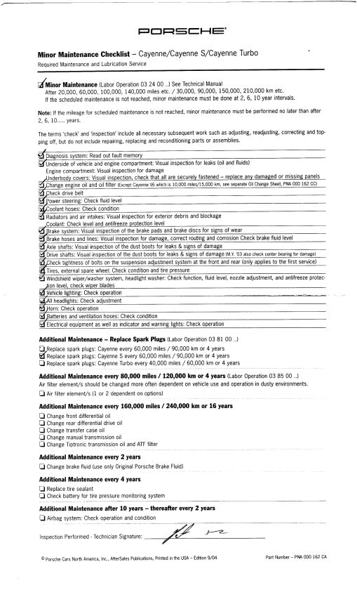

You are correct for the S on getting plugs at 60,000 miles. However, plugs at 40,000 miles are for V6 and Turbo. I can photograph it in writing if anyone would like.

Here's a scan of the 40k service
Notice that Cayenne V6 and S change plugs at 60k.

I don't have one to put up tonight but that sheet has been amended to read Turbo/V6 @ 40K. Also note that sheet is for Minor Maint. ie...20K, 60K, 100K, etc. Major maint are 40K, 80K, 120K, etc.

I know, a little late on the pics but I think the biggest difference is the production dates of the 2 service sheets posted. The above were from 9/2004, the ones below are current as of 5/2006.
