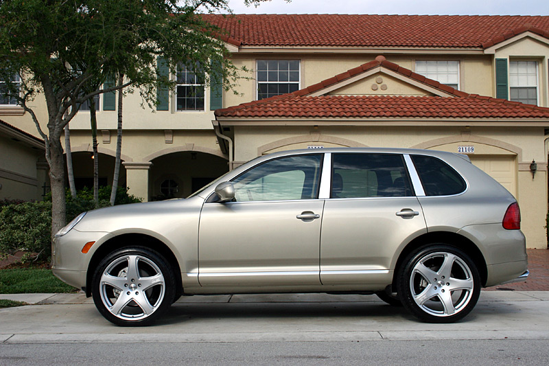

Originally Posted by cellg8
3) If I get 22" without lowering, will my Cayenne be even higher from the ground? Will it look weird? If you have pics of 22" on your un-lowered Cayenne, please show me...
Here is my car when i first put the 22's on it with the stock ride height. It looked horrible. The car was very lifted and it was a lot more pronounced with the 22's over stock wheels. The second pictures shows it right after I put the H&R springs on it. My biggest regret with this car is that I didn't order air suspension because I would really love to bring it down even more...
